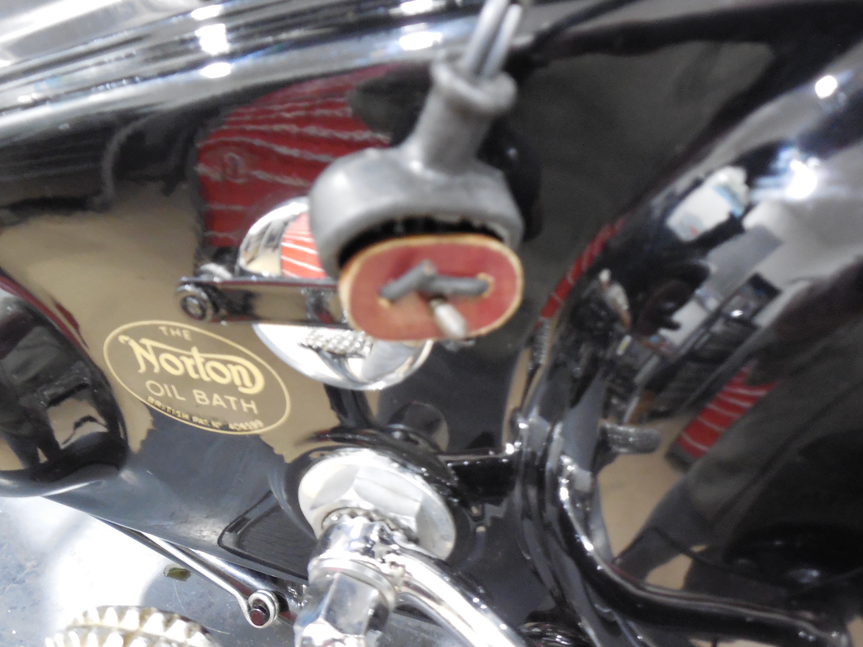

In the process of fitting a brake light to my recently acquired Model 30, I have discovered that the dynamo is not wired into the system, and there is no regulator to be found. The bike has been wired for positive ground, which is incorrect for the year and counter to the wiring diagram. I took the dynamo cover off, and everything appears to be OK, the two brushes are in good shape and the commutator is clean and smooth. First question is, with the engine running, can I simply check that the dynamo is working by testing for voltage at the two output poles? Also, how would the regulator mount? The book says it is on the offside rear stay. Would anyone have a picture that would help? Plan is to rewire the bike complete with the correct colour wires.
Thanks for any guidance!
Bill

Firstly, are there no wires to the F and D terminal on the dynamo? To test it in situ short these two terminals together and test between the the frame of the dynamo and the shorted terminals. A voltage. Should appear on tick over them raise the revs to see a fluctuation upwards do not rev too high. Alternatively, with the dynamo removed from the machine connect to a battery, shorted terminals and frame, the dynamo should run like a motor.
If you decide to use this dynamo you will have to polarise and confirm it's output voltage to build into your system.
