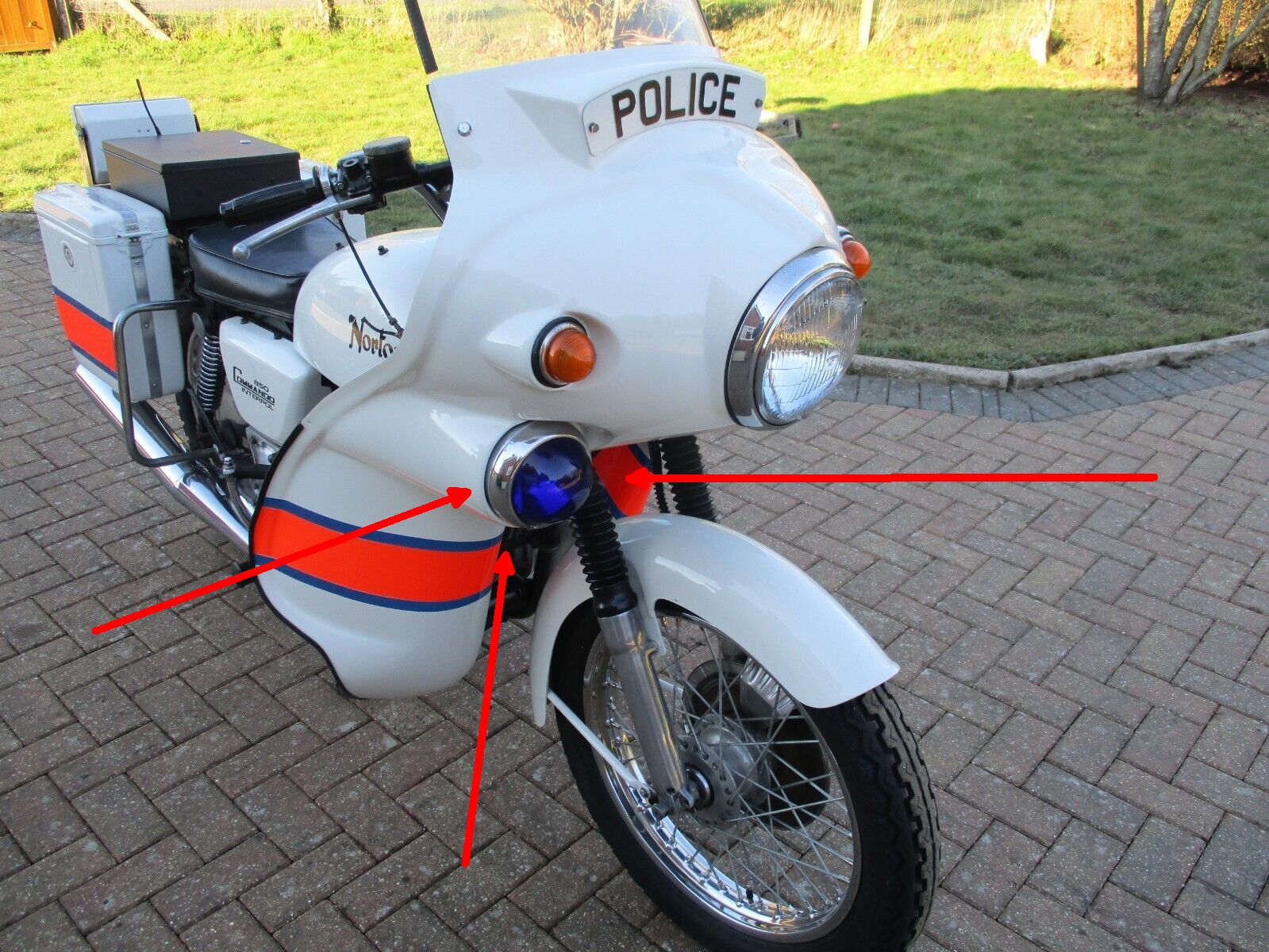

I need to repaint the white mudguards and tank on a Mk 3 Interpol.
Does anyone now the paint code / ref?
Colin
The fairing and mudguard is a standard white GRP pigment, most likely Scott Bader 337. According to my colour chart, this is equivalent to BS [4800/5252] 00 E 55 - White or RAL 9016 Traffic White.
