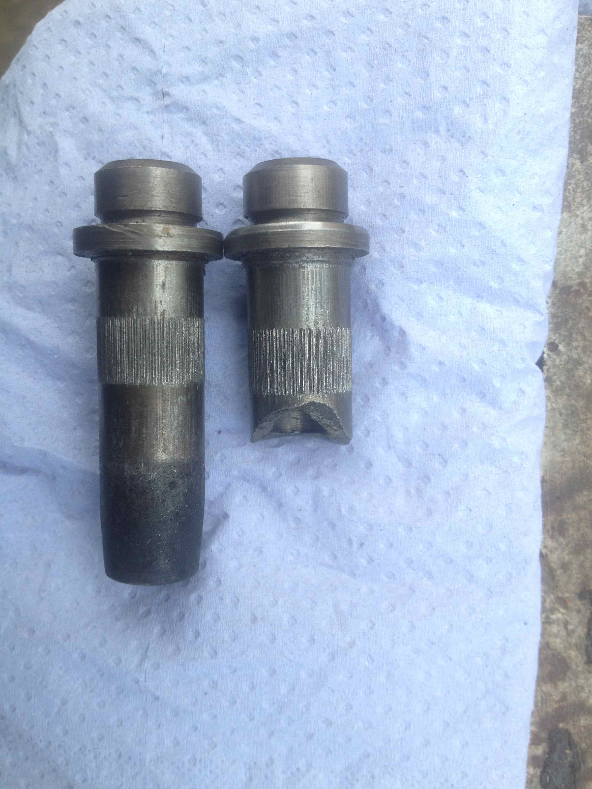

Knurling …
… is the work of the devil. This is what some p/o did with the valve guides in my '72:
The left-hand cylinder head looked like someone had detonated a small hand grenade inside it.
At least it impelled me to get a very nice set of Colsibro guides and matching valves from JD Autoworx in Wallington
