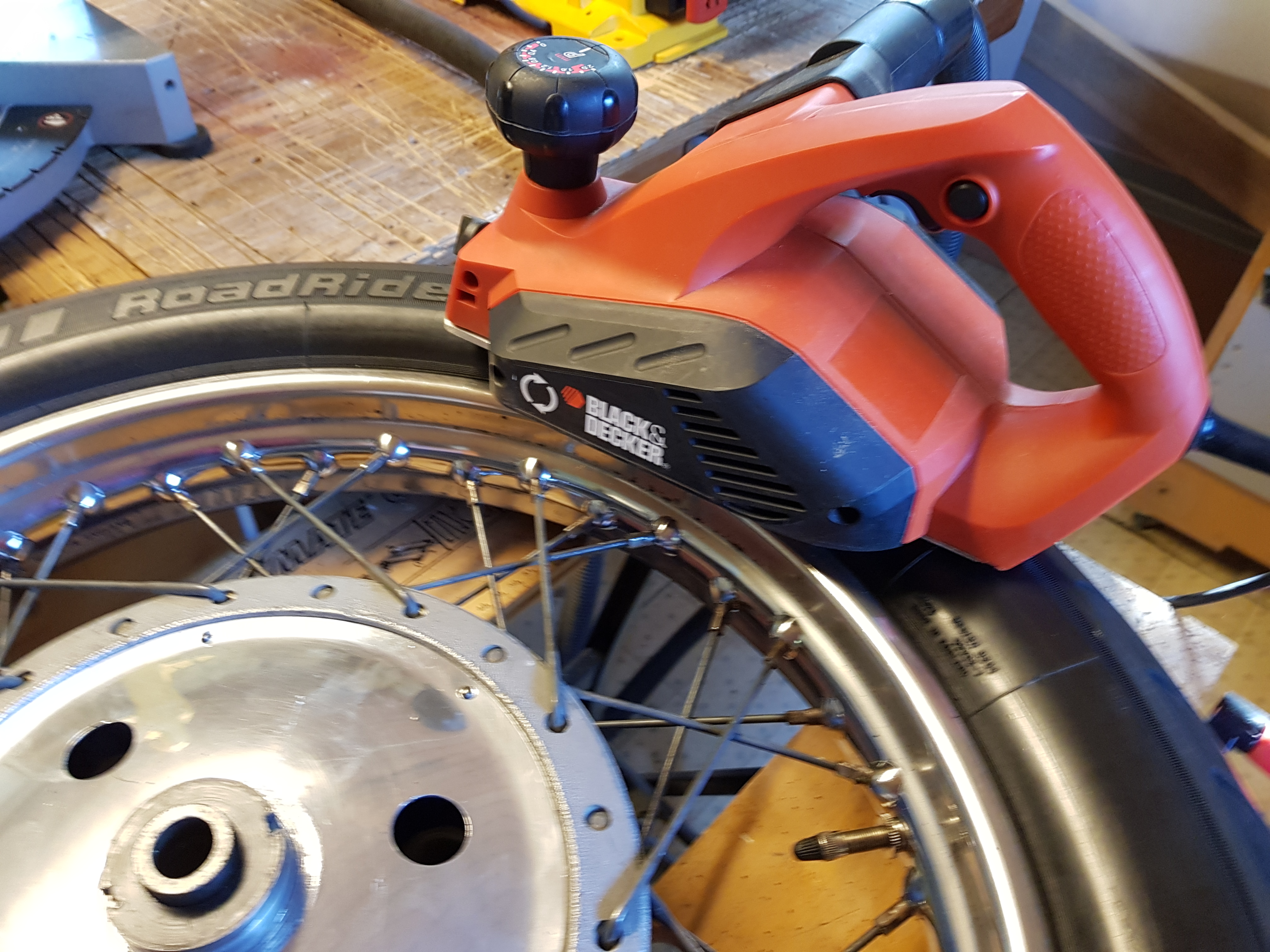

Interesting. I'm stuck with a new Roadrider Mk II 4.00-18 that binds between the swing-tubes unless I move it right to the back. I'm not afraid of shaving the ridge at the side of the tread, but shaving off 1/4" on each side to get a decent fit with some clearance is going too far.
Everybody with an Atlas with an 18" WM3 rim at the rear has this problem with new tyres, but nobody seems to have a convincing answer.

I hope you are joking ! , or at least you have fitted some new  sharp blades to the rotor !!. My first post in this thread  suspected a faulty valve ,but I did find  some rust flakes from the rim  had caused the puncture ..A de-rust, a coat of hammerite  and a wide  band of duct tape under the rim tape seems to work . I had to  use the old SM   as nothing else  fits except  a 90 mph moped tyre. A 90x 90 is too wide.
I expect other members will recoil in horror !, but to be fair  after a lifetime of being totally self reliant  I have little inhibitions  about  doing stuff  that  others baulk at. I expect to fall off the roof  or get electrocuted   before  I  die of old age.

I have managed to run all my Atlas bikes with 4.00 x 18" rear tyres. A Roadrunner would just about fit if the chain was half worn and the tyre towards the back of the swinging arm. With a new chain I used a 'half-link' to get a similar result.
Many rears ago I looked into a Dominator replacement swinging arm, from Dresda Autos, which was 'Box' section and designed for a range of wider tyres. The drawback being the cost. Dave D  showed me a swinging arm modification which was very easy to do, cost very little and worked for  me.
It consisted of marking the swinging arm where the tyre was going to rub. The arm was then removed from the bike and measured with a line along 1" each side of that mark. The area was then heated up to cherry red and the line punched in around 1/4" with a cold chisel. This folded the inner S/A metal into the arm and gave at least 1/8" extra clearance each side. Dave suggested welding the fold to add strength but this was apparently not necessary on road bikes.
The modifcation allowed me to use a range of 4.00 or 110 tyres on the back apart from TT100s which needed the side block shaving. This worked on two of my Atlas bikes for 20 years and gave no problems.

Road bike tubing is essentially weldable mild steel, not '531', so 'blacksmith' work should not harm it.

No, not joking. With sharp blades, a very fine cut (and a lifetime's experience of using wood planes) it worked well. And with the dust extractor attached there's no rubber-mess that you get with any other shaving/filing method.
