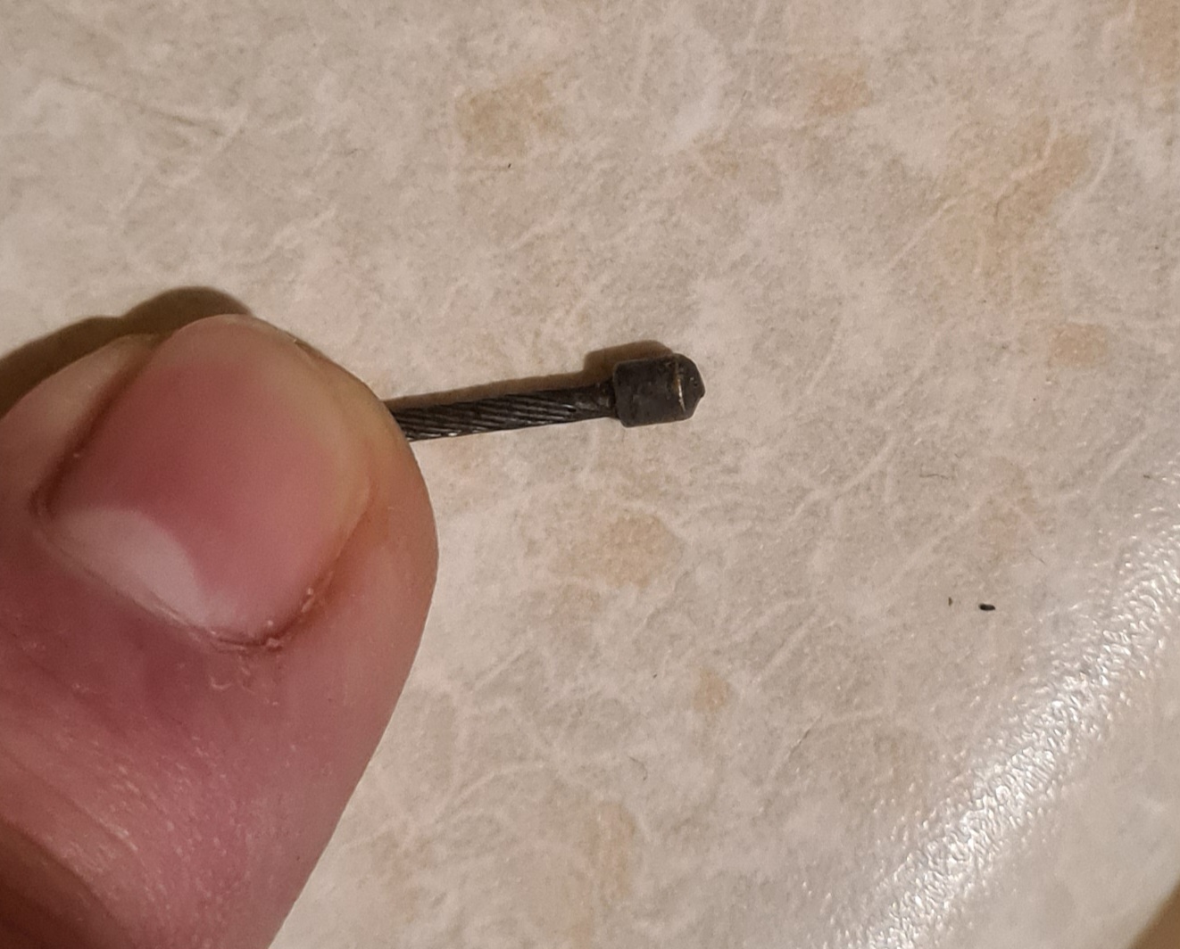

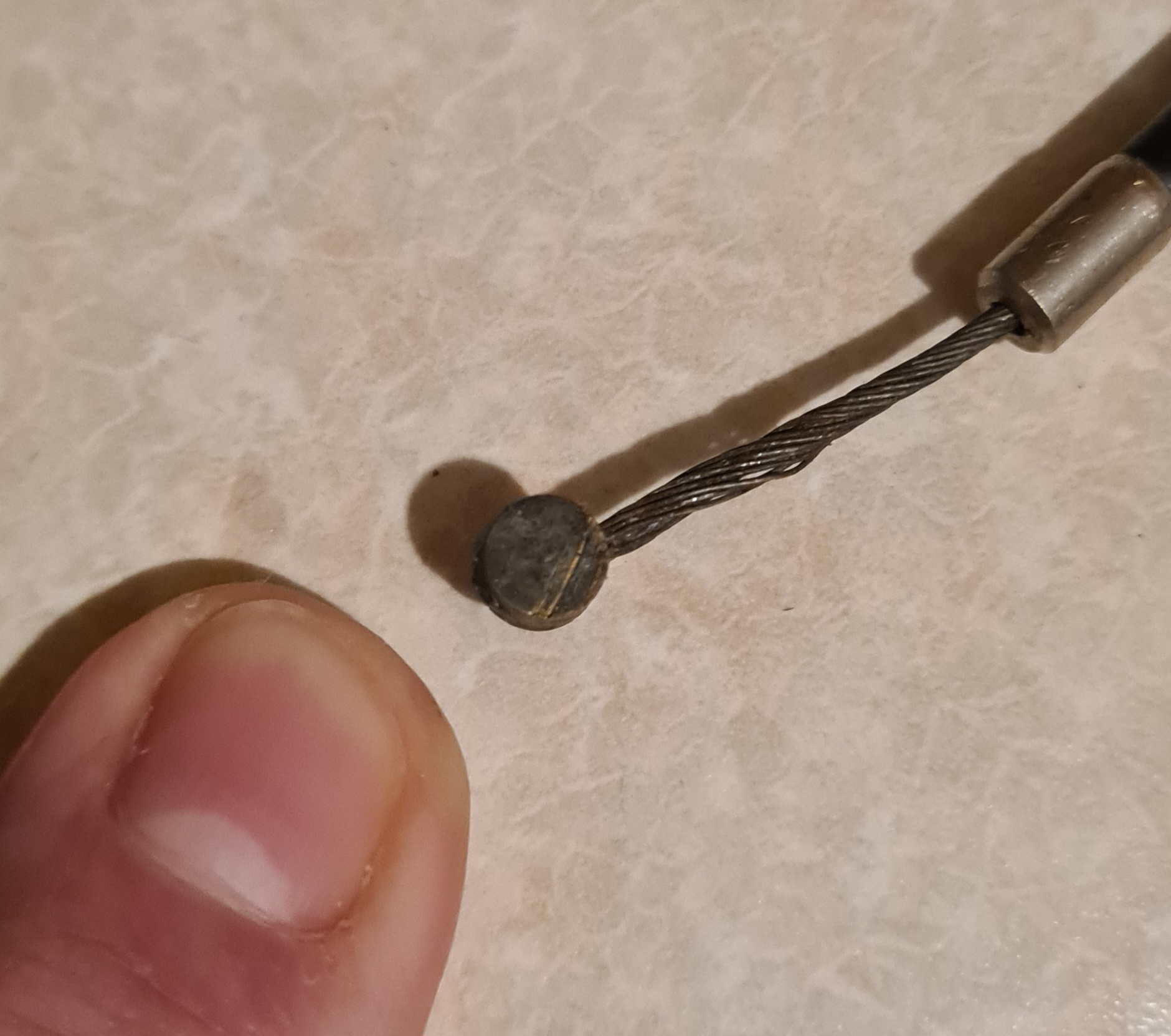

With regards to the cables are they the same for both? I only have the one here which I think was for the choke.
Bike is a 1956 Dominator 600
Cables are different in…
So when I buy what lengths…
So when I buy what lengths are they and are the nipples correct I have?
...and monoblocs have 1/2"…
...and monoblocs have 1/2" shorter outer sleeves on throttle cables than concentrics...
Nipples are correct…
You need to decide if you want cable with in line adjuster (I prefer these), or adjust at carb.
Cheap enough from NOC shop or Feked. They are advertised for your model and use, (throttle/choke). It's the adjuster choice only.
Cables are different in length.
