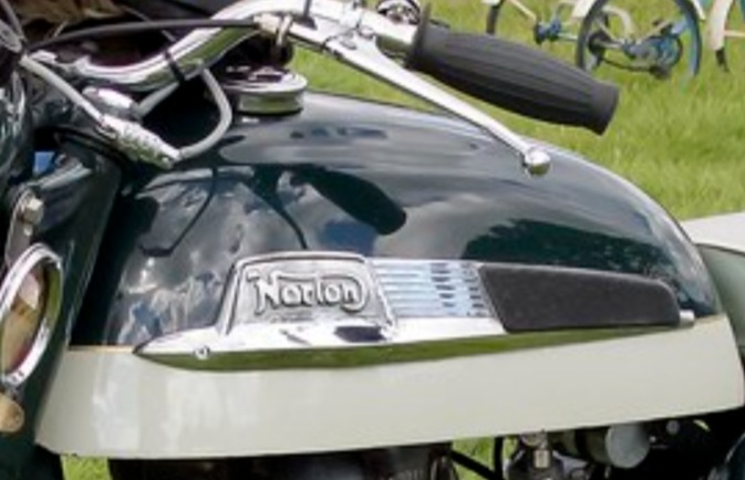

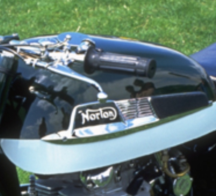

Green ,  its only red on a red bike.  However checking my own two tone 99   the badge is painted around the lettering with dove grey to match the lower tank . I think thats how they were done orriginally. Not to worry though, your bike is far too pretty to use ,  I will be happy to take it off your hands for a paltry sum  and  park up as an ornament !!.
Nothing better to do ,so I have gone thro my books looking at  early photos of  tank badges. I would say that there are more two tone bikes with the dove badge inset, but there are also  two tone early SS bikes with the tank main colour used in the badge . So not conclusive . The darker colours are more practical ,not showing the grime.
I have an unrestored Green/ dove grey ES2 and the badge is definitely green.

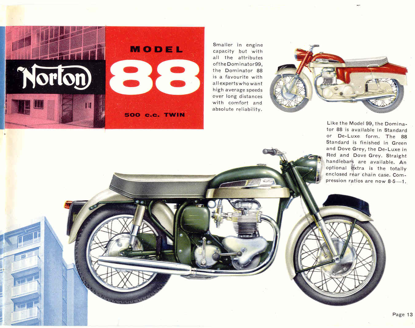

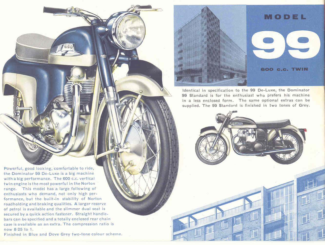

I am fairly certain that not all the Slimline Models had badges with painted logo backgrounds. This appears to have only been a factory trim perk on certain models at certain times.  Plus the painted section did not always reflect the tank colour.
If you check the attached factory brochure for 1961 with the two tone Green / Dove Grey finish it shows no painted badges. Whereas later Red Atlas and 650 Silver tanks have either a Black section or Chrome.
The catalogued Featherbed framed singles and many of the lightweight models also have bare badges; some without even the knee rubbers. I initially thought that perhaps just the De Luxe models had painted badges but this is not a golden rule either.

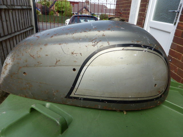

Trust you to throw  another spanner in the works Phil,  Just when we thought we had it sorted !!  Now we have 3 options   plus that crazy one on the 650 std ?
Robert.....you are quite correct.  The 650 Standard Petrol Tank appears to be a creation to please all.  It has the paintwork of a late model 7  applied to a Slimline tank with some Slimline badges added to modernise it.  Some of this model were sold with grey seats. Others with what was desrcibed as a 'new tank'.  I am guessing this was the basic later 99 type with out the silver panel.

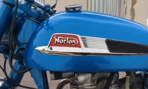

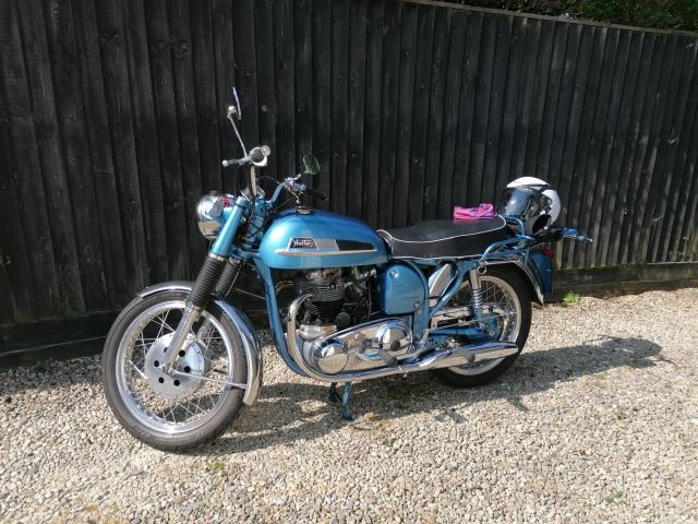

Not many of these models were manufactured and sold. I don't think the sales figure passed 300 but the  records regarding this version are very difficult to decipher. The 650 DeLuxe had equally low sales but all of these are trounced by the 650 Western of which only about 11 were manufactured. This bike was basically a 650SS but painted completely Blue........Frame, Tank, etc.  It was also known as the Westie or Westerner but the change of name still do help it sell.
The Westerner appears to have a black inset badge  against the blue tank. Another option ?.I wonder what the "new tank" meant ,  Perhaps a clearance of the left over  stock of the Manxman ? and its specially long seat.Or just the shifting of the filler cap from left to right.
