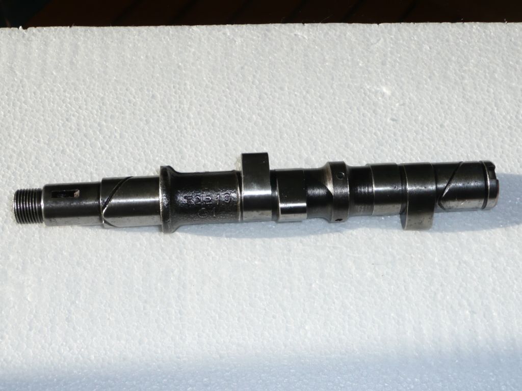

I was just reading some interesting articles on Norton Camshafts, and checked out a photo of a camshaft I sold around a year ago on Ebay.
The camshaft had a part number of T2219 cast on it.
I cannot find any reference to this camshaft number so could someone throw any light on it please?
As far as I can remember it came from a 1958 "99" but the cam should have either been a 21225 or 22729 if someone had fitted the SS version.

Here is a photo of it: Att…

I've just removed the camshaft from an original 1953 model 7 engine and noticed the camshaft also shows T2219 cast into the shaft.
The camshaft type is meant to be a "D12/790" for this engineand I'm sure this isthe correct cam in my previously untouched engine.
I can onlyassume then that the T2219 code is NOT indicative of the type of camshaft. As I haven't any other camshaftsto compare with, it leaves me withsome otherdifferent questions.
Where is the part number on a Norton Twin camshaft please or if they do not have one,do allthenorton cams carry the T2219 number?

Hello Les,
I'm not a Norton expert. Just been around featherbed twins for a few decades; so as I didn't work for Norton (and 'Daddy didn't run a bike shop'!) I can only tell you what I've seen in engines I've worked on.
Most of the Dommie camshafts were cast in the same moulds from 1952, so the T2219 would relate to whatever came from those moulds, not the lobe profiles. The blank would then go for machining of the lobes, bearing journals, etc.
T2219 also appears on the SS camshafts. Theonly identifying marks were stamped on from the SS camshaft onward and no part numbers were stamped.
X 1 and later on X 2 referred to the levels of hardening. Maybe that was necessary because a progressively softer steel was sourced by AMC for their cams?

Hi Paul. Thank you very mu…
Hi Paul.
Thank you very much for your reply.
Before I had a list of all the different cams that were produced, I had assumed the T2219 code was indicative of it's type, but not so.
As you suggest, and I'm now sure you are correct, T2219 was just the standard raw casting number and all later grinds still used the same casting.
It still leaves the question as to how one can recognise (easily) what typeany heavy twin camshaft is, rather than do a physical side by side comparison, which is still very difficult or not very practical.
I agree with youthat one would imagine that this type of technical question would result in an answer forthcoming much more readily,here within theNOC , butI have noticed most technical questions posedoften go unanswered. It really is a shame....most disappointing I think.
Best regards
Les H
I think Paul was on the ma…
I think Paul was on the mark with his information. It would be nice to have more authoritative answers to technical questions but the fact is that most of the old Norton employees are probably dead or just not involved.
There is a cart-load of misinformation on this forum, I see in another thread someone has just told someone else that later dominators had 7.5" centers for the fork tubes. Whoever works on old Nortons these days has to be smart and have a lot of common sense to be able to pick and sort out the good and bad information that will be thrown at them, you can not even trust books.
I think Roy Bacon's books on Norton details are very average and disappointing. The info in his Norton Twin Restoration book on camshafts has less detail than Paul's.
Personally, any fifties Norton heavy twin I would have apart I would stick the sixties cam and tappets in. The performance would be good and the flat tappets are cheaper to re-face than radius ones.
Roy Bacon's book says there was the original domi cam, the Daytona cam which he says came out in "about" 1956, then one with quieting ramps which may be marked QR.
After that comes the SS cam, which as Paul said has either x1 or x2 on it, and after that you will find the Commando cams with the tachometer gear machined in.

Hi Les ,
Coincidently just found your questions whilst trying to find out more about my worn camshaft. It is original and out of a 1962 dominator 88ss.The markings are T2219 and in a circle the letters JA then the number 2 beside that. Hope this is of some help.

Just found this on another post and it may help Quote:
'I am thinking of getting my camshaft "refaced" as it's cheaper than buying a new one but I'm not sure if anyone has the data for making it a "QR" profile, as per my original 1959 99 'Special'.
So the number T2219 could be a stock material number and by the side of it on my camshaft there is a circle with the latters "JA "inside . Could this be the profile referred to above but for a Dominator 88SS ?
Colin
Hi Les, it IS disappointin…
Hi Les, it IS disappointing but not unusual. As far as I can recall, from over 52 years of working on them, very few engine parts from cars or bikes have their part numbers actually cast ontothem so identification can really only be done by accurate measurements. The same applies to cylinder heads and most alloy castings. They have the same casting numbers for a multitude of different units.
It was a quote from one of my postings that mentioned getting a camshaft re-faced. Obviously this is definitely NOT to be recommended for any machine that is intended for use as a racer - cafe or otherwise! My personal belief is that any such machine should be fitted with purpose-made modern parts rather than risk your life with critical components of dubious condition that are possibly over 50 or 60 years old! But then again, some people ENJOY Russian Roulette!

Hello its been a wile since anymore post on this bit of a forum and I like to add to my finding of Norton twins Camshafts early cast iron then tempered in the old forging ways to hardred the iron and then add chromolidenium for the outer surface this was about 10 thou and Newman cams are made in the same way ,as for the daytona cams these were made in 1954 for works dominators daytona racers witch I found to have international gear box clusters fitted as I own a 1954 daytona Dominator with its works parts and the t2219 cam was not in this motor the cam was cast marked T2242
with an MX stamped on it, I never seen another like it but it was well worn and had to replace in with a later dominator s2 cam newman cam witch works well the x1 cams were first fitted to the manxman 650 and all that follow from models 88 to 750 and then you have works racing cams in between and the delvelopment of the S2 cam and S3 and s4 for commando but like this club is you have do a lot of scrataching around to find any creidble infromation on Norton cam shaft time line yours anna j
Hi, I believe later Camsha…
Hi, I believe later Camshafts are made from Chilled Iron, which gives a soft core with a hard 57 Rockwell surface. If you make new ones use BO1 toolsteel annealed, and grind after heat treatment. I have a number of Atlas/ Commando camshafts, not one looks the same. Les Emery could not tell which was which either. No criticism meant, just that Norton do not seem to have liked part numbers. I would not have let them near an Aeroplane in the day,. their record keeping was very poor. I am trying to build a N15cs, what a shambles the parts lists are.
