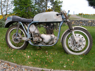

Hi, I'm new to the club but a long term Norton owner. I am currently rebuilding my 1959 Atlas cafe racer. I bought it when I was a teenager as a 650 Triton with a Norton wideline frame, short roadholder forks and (I believe) Rickman tank, seat & fairing. The Triumph engine was knackered so I picked up a 750 Atlas engine that was tuned for racing. I rebuilt the bike but was not happy with the result and took it off the road for some further work. Some thirty years later, with family all grown up, I am now starting over again!
I'm carrying out the refurb in stages and am currently rebuilding the roadholder forks using a genuine Norton refurb kit with new bushes, fork stanchions and seals. My problem at the moment is that one of the alloy fork legs is too tight at the bottom when I insert the new stanchion with its new bush. I don't really want to ease the bush to fit the fork leg as this defeats the object of fitting the new bush. However, without access to some sort of boring equipment I am unable to think of a way to ease the bore of the fork leg at the bottom so that the bush is a nice fit all the way down.
