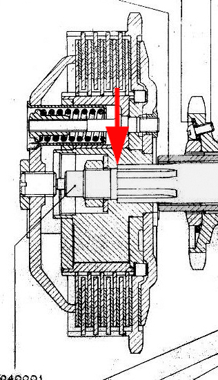

Thanks for your help with this. I cannot see the spider register/shoulder on the diagram so dont really know what I'm looking for

Item 10 is the spider …
Item 10 is the spider (center) and the register is in the right hand end (not shown in this pic) . to see you would have to completly dismantle and study the detail . Even then its not easy to see the problem.
