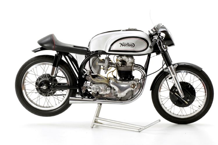

hello Howard - Does it have…
hello Howard - Does it have the right-angled tacho drive gearbox at the timing cover in-line with the camshaft ? A 55 Dommie would have had a dynamo at the front of the engine driven by the camshaft. When the race-kit was added they may have removed the dynamo and used a modified timing cover. This could have used a gearbox to drive an ATRC 2652 racing Smiths tacho or an RC 1303/00 Smiths chronometric tacho. Because the camshaft runs in the opposite direction to the crankshaft the tacho gearbox needs to be a reversing type. Both of these instruments could be mounted to the top fork nut on a plate with rubber mounts. An image or two will help it your friend has any. cheers, howard
