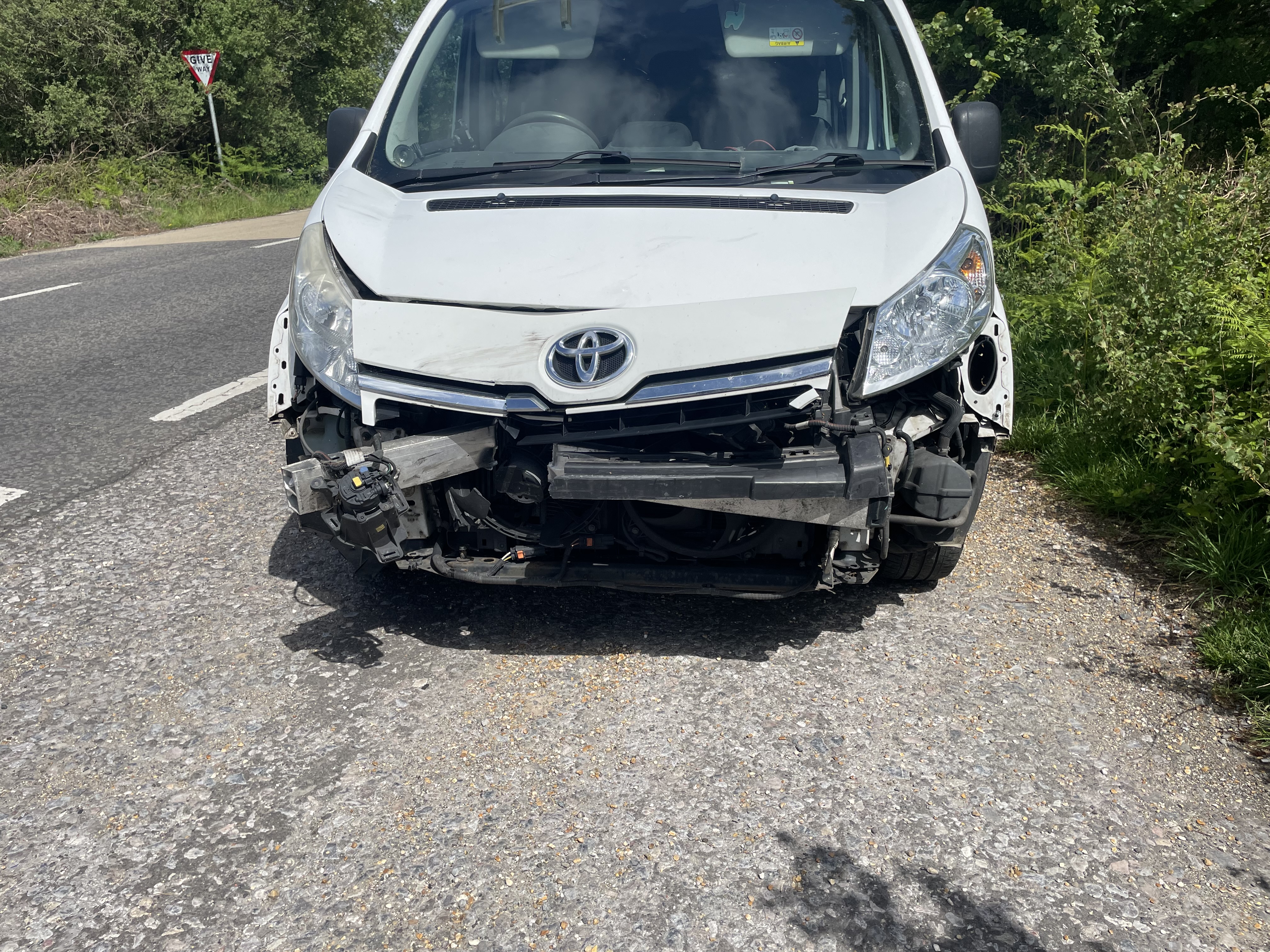

Yes I was riding defensively, there was a stream of traffic joining the A35 from my left, I thought, "I bet they won't see me", so I slowed to about 35/40 mph and moved to the right of my lane keeping an eye on the front wheel of the car at the junction, as I was almost on the junction an oncoming Toyota van turned right in front of me, so late that I actually hit the front of the van. I went over the bars onto the bonnet and onto my back on the road. I'm pretty sure that my Forcefield body armour saved the day. The guy who hit me was mortified and his insurance were unexpectedly very co operative!
