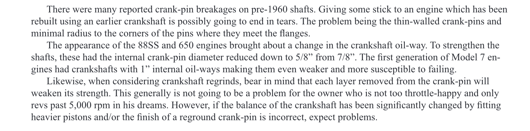

if anyone's got a 500 twin crank in bits would you be able to measure the oilways inside the crank? should be either 1", 7/8" or 5/8". It would be good to know if it's a dynamo crank, alternator crank,SS crank....
trying to understand if there is an error in the dominator service notes.

Hello Pete, As one of the contributors to assemble the Dominator Service Notes publication I have been looking for evidence of the mysterious 7/8 inch big-end journal hole on Dominator 500 and 600 crankshafts. Only this morning I was reminded that all Nortons in the Bracebridge St era were virtually hand built and assembled as far as possible to the customer's wishes. Hence all manner of frame parts, gearbox ratios and engine-tune parts could be specified and Norton were keen to oblige. When the factory closed the experimental department and the race shop many hitherto unseen components became available and crankshafts with all manner of different dimensions came to the market place particularly in the racing fraternity. Crankshafts with 1/2 inch holes and 1.75 inch big-end journals (using Matchless big-end shells and con-rods). Also 5/8 inch holes with 1.6 inch shells and - dare I say ?....Triumph rods were purchased. So if a bike was intended as a private entry to Daytona, Sebring , Mosport or Thruxton all manner of different specifications were possible and likely. Needless to say these modifications did not get included in revised Drawing sets or Parts books. Some of you lucky readers will have owned a genuine 88SS. These engines had a 5/8 inch hole in a 1.5 inch big-end but some of these crankshafts found their way into some of the later 88 Standard and De-Luxe models. I personally had a 1962 88SS that had a semi-downdraught head with 28 mm inlet ports and no tin tube. Most of these models had 1 1/8 inch inlet ports and a tin insert sleeve to reduce the port to 1 1/16 inch to match the 376 Amal Monobloc carburettor. So, to me it is unsurprising that a rogue crankshaft may occasionally turn up ( from an ex-race engine) but searching for the evidence may be impossible. My "head" too could have been a rogue but I hope it is still performing on an unsuspecting 88SS rider's steed. Good Luck Pete - buy an alternator crank with 5/8 inch hole. Howard
Thanks all. So I understand…
Thanks all. So I understand the issue with the cranks but would like to get to the bottom of whether or not there is a good number of 7/8" oilway 88 cranks out there.
The reason for this is that the service notes seemed to lead me on a wild goose when I looked for an 88 crank with the 7/8" oilways having discovered that mine had the 1" oilways. According to the Dominator service notes only the early model 7 dynamo engines had this type of crank and it was superseded with a 7/8" version. I believed from this that I should be able to replace the crank with the later 7/8" version and rang round a few suppliers, asking them to measure the oilways. They drew a blank on the 7/8" cranks, only having the 1" cranks. One was totally baffled and got quite annoyed!
id like to get this put to bed and the service notes updated so no one else new to nortons goes through the same.
I've also asked the question on accessnorton and so far the only standard 88 cranks mentioned have 1" oilways, both dynamo and alternator. Someone has the 5/8" SS crank (nos!). So far it's shaping up to show that for all intents and purposes the 7/8" cranks should be disregarded and I think it would be only fair to reflect this in the service notes.
For anyone not familiar with…
For anyone not familiar with it here's the extract from the service notes-

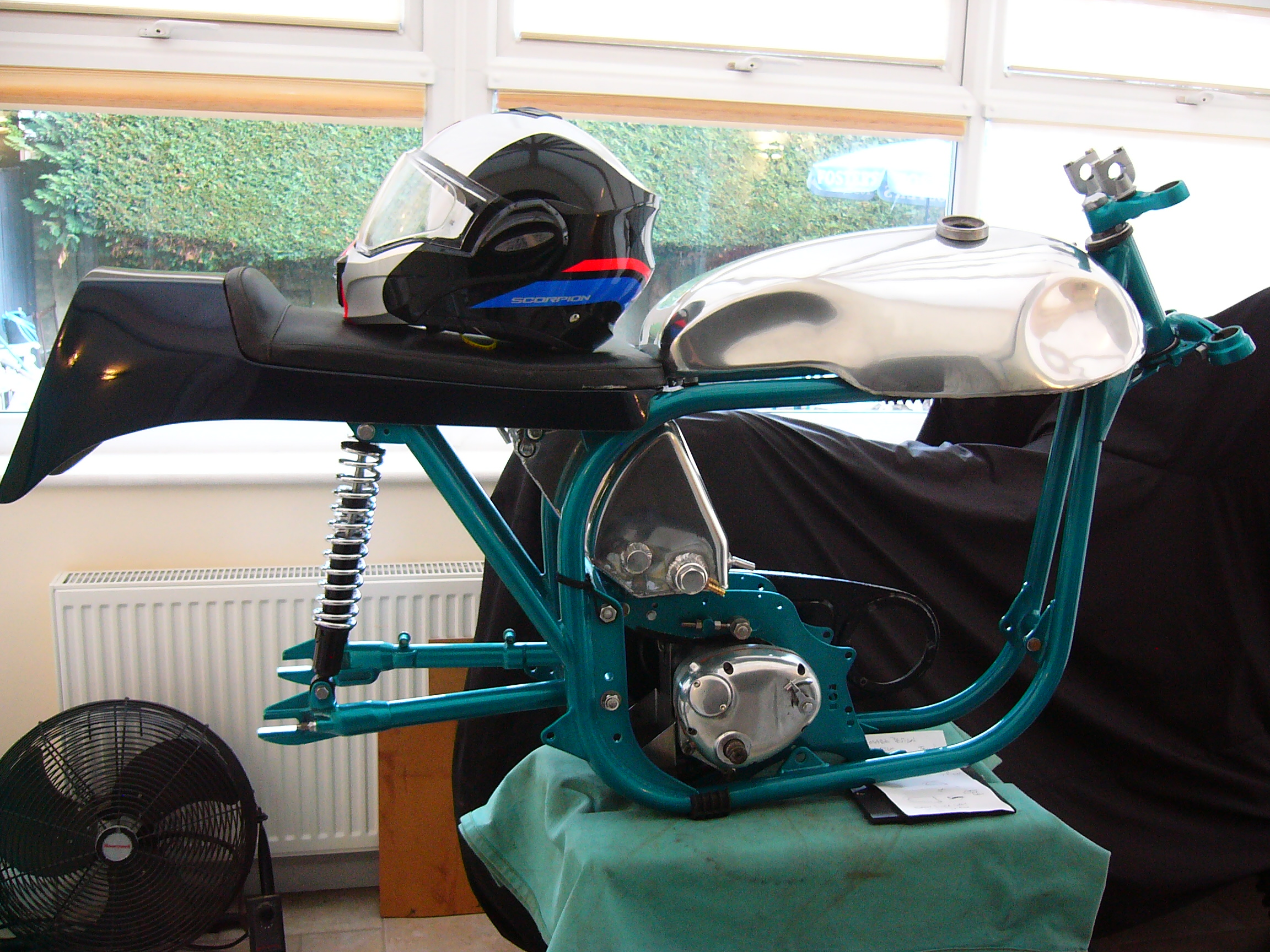

Still nice Pete , see like…
Still nice Pete , see like mine you haven`t got the motor in . I fitted my gearbox just to see how everything lined up and to make and route a new clutch cable. I`m also sorting a kickstart and lever in reversed position that will work with rearsets. Oh the joys and headaches !
Hi Wayne ,interesting frame …
Hi Wayne ,interesting frame , i think it was orriginally a DL Dommy from around 1960?
Hello Robert , I think it`s…
Hello Robert , I think it`s a standard wideline 1959 registered . Forgive me but whats a DL Dommy and why do you say it`s interesting ?
I think its possible that…
I think its possible that the frame has been re-built from a mixture of slim and wideline parts . But not easy to determine from the picture. DL denotes a slimline with brackets for panels.Frame number?
Thats odd , As far as I know…
Thats odd , As far as I know it`s a standard dommi 88 wideline 1959. It came with the original Buff log book and the frame number is P12281010 . The NOC managed to get me a new log book and retained the original Registration number too. Photo attached is not good but you can just about make it out . cheers.

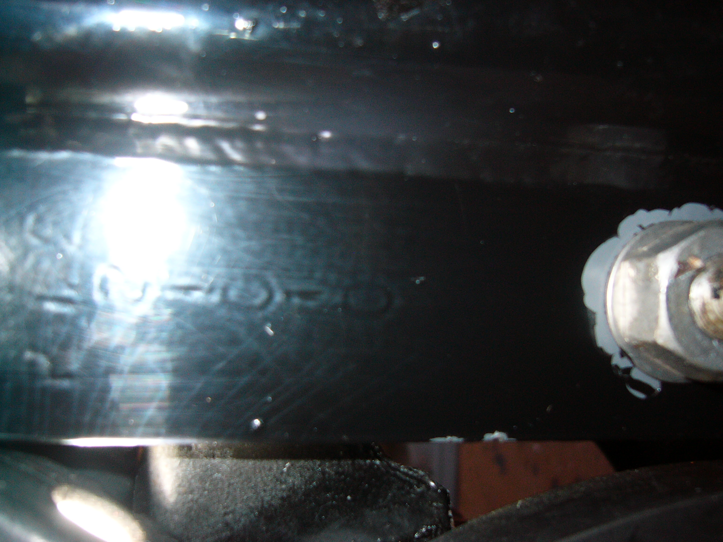

blue frame, WAYNE
Wayne R, your frame (nice with an Italian flavour) has one pair of front engine mounts.Th photo of Pete Y bike,th bottom of th front eng. plates should be obscuring another pair on his slimline. Does your frame no. have a 2 or 3 digit model no. horizontally above it?
