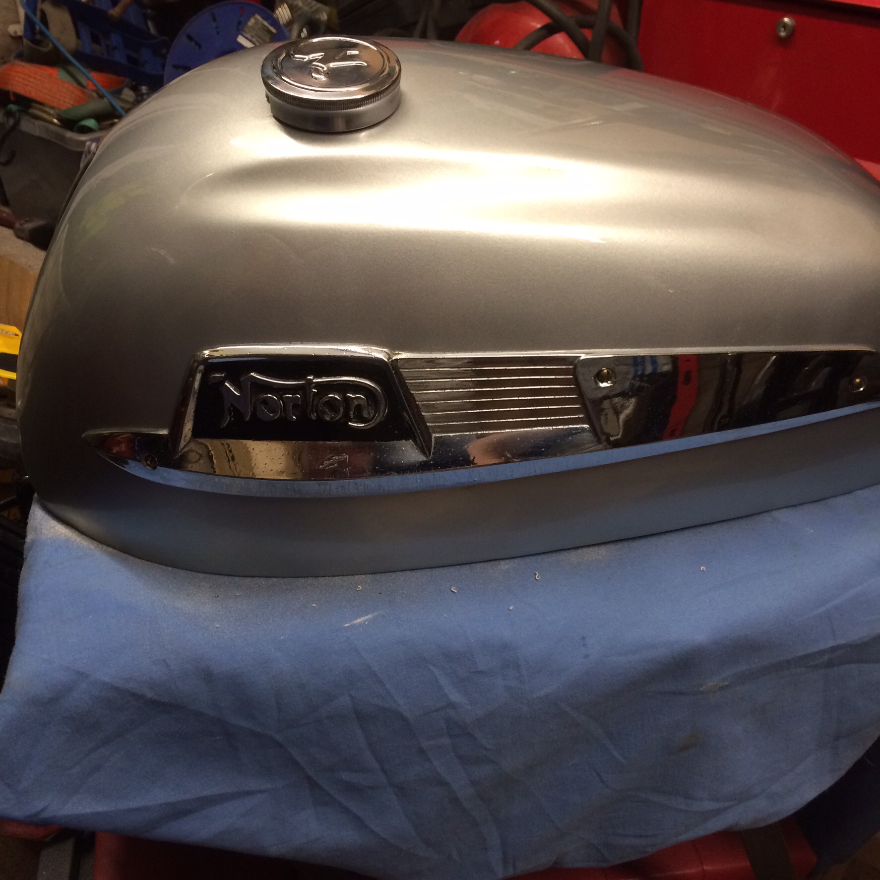

Just finished painting my Dommies tank.
She he has had a bare metal respray and inside descale and frost por seal kit fitted.
The he inside of the tank had had a fibreglass resin liner in it. It resembled a dried out wall paper paste bucket inside. I cleaned it out by filling it with citric acid for a week and filling it with nuts and bolts and giving it a shake for 30 mins. Was like new in there when I finished.
Incidentally; citric acid it a fantastic cheap way to get rid of rust. One to remember.
