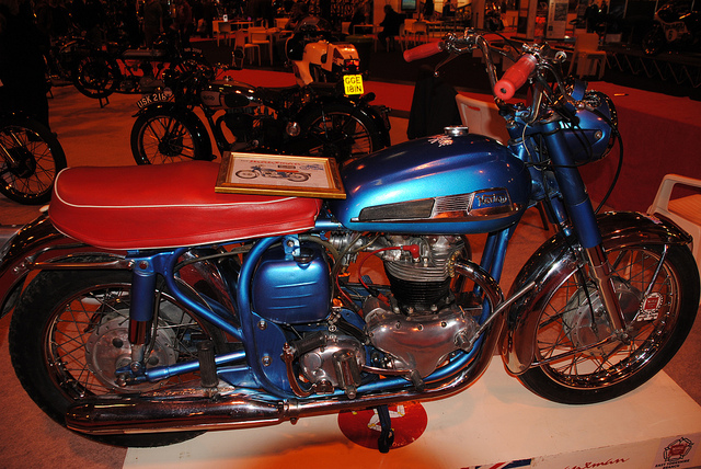

well then I knew there was something special about my Manxman 650 so its not a standard norton , but it sure rides nice, and really holds the road at speed round nasty corners and tractors with a muck spreader on the back ,and I do wish these farm would fit indicator or stick his arm out to tell us all know witch way there going, as one guy pulled right across me as I was over taking him but will my bike handling and its power I am still alive, and lesser bike, I would not be hear writing this , so its all down to quick thinking and my riding skills and and bluing good Norton 650 Manxman power and handling, and to top it all on this ride out round the next corner there was a spill of some kind a white greasy stuff all across the road and right on the corner and no were to go but up a grass verge with your feet out on the road to try hold you up and I just managed that one too, but it was very dangerous if a car had be coming the other way he would of lost control and hit me, so I am around to live another day, yours anna j
