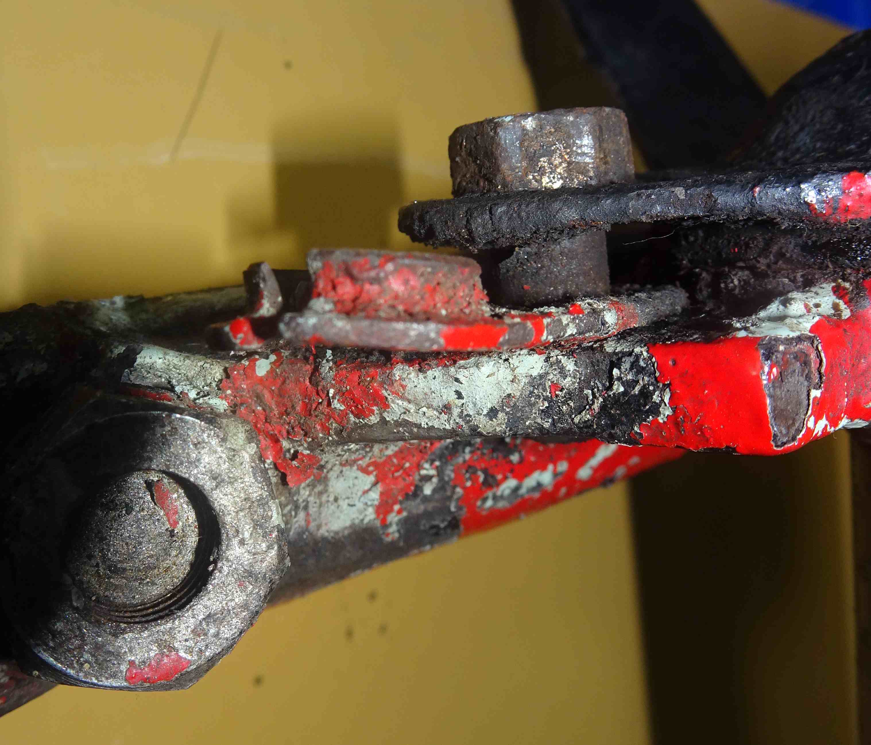

  The screw is missing from the steering damper on my 1956 ES2. It goes into the lower fork yolk to prevent the bottom plate rotating.
Can anyone confirm the thread. I suspect 5/16 bscy but my tap won’t start in it. The other little puzzle (well for me) is that there is about a 1/4 “ gap between the steel damper plate and the yolk.
should there be a spacer fitted ?
The thread is 5/16" bscy. The original bolt has a 3/8" shoulder, no spacer required. The bolt also secures a guide for the front brake cable.
Damper Bolt 1
Thanks Ian. You’re a gentleman. Your help is very much appreciated.
... seen that cable spacer but it looks like a good idea.
