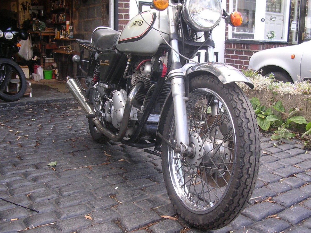

Just running theoil lines from the filter, and notice it is really close to the swing arm spindle and will rub onthe plates.
I have new metal sleeves to fit but from what i can see the sleeves will rub the paint off my newly painted frame.
Do you guys have any solutions.

When I got into the fix I found it easiest to attach the filter connections first - with the filter mount loose - then thread the pipes through to make off the oil tank and engine connections last. I suspect I may have the horn the wrong way round? The trumpet part points away from the primary drive. I think life might be easier with the thing pointing the other way?
Dave that is exactly the w…
Dave that is exactly the way round that i did it, and when i took mine apart the horn was facing away from the primary drive which i suspect it the cordect way round. I will be fitting the horn tomorrow and will try it tbe other way round. it is very tight for space it there with oil lines to rub and wiring to run as well, add to that the mudguard and it has to be correct first go.
Checked the horn position…
Checked the horn position and mine will fit with the horn facing the timingside and down but will rub the return to the oil tank. It will also fit facing the drive side and not rub anything, but It is very close to the chain and all the rubbish from that is likely to find it's way inside the horn.
