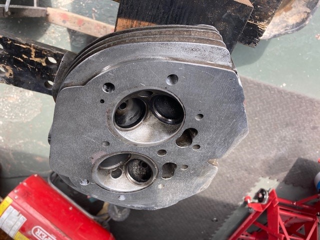

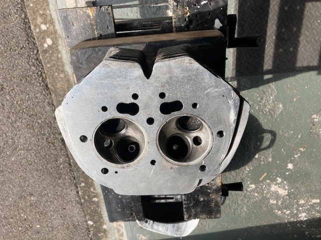

I thought the original head had been skimmed to far down so bought a replacement head that has not been skimmed. the pushrods were to short for this setup however I have just been given the old paperwork that was with the bike and it seems the engine had several modifications like S4 cam and other mods to take it to a Norton service release N3/64 spec "stage Two" road racing conversion.
the pushrods that i thought were too short and the original head comply with the conversion in the document pack i was given
the bike had been messed about with and it was a bit of an enigma to start with as the original owner is said to have dropped it and wrecked the original panels and with the VIN plate being under the seat and the rear brake and gearshift having rear sets fitted i thought it may be a factory JPN the engine mods have now got me wondering if it was indeed a factory JPN
the owners club said the engine / frame number one before mine was a factory JPN
i am as confused as ever.
hi Stan i would take £300…
hi Stan
i would take £300 for the head. if you are interested send me your email address and i will send some pictures
