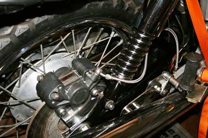

I've just rebuilt the rear master cylinder on my 1975 MKIII and fitted a Grimeca caliper and stainless hose. I'm sure I've put all of the seals in the right way but when I put brake fluid in the reservoir it just stays there. I've pumped the pedal and still nothing. I can hear air coming out of the caliper bleed nipple when I press the pedal. Do I need to prime the master cylinder somehow?
I can't find an exploded diagram anywhere for the rear master cylinder to double check against.
I don't know if I can face taking it all off again.
Any ideas?
It's sunny and I should be out riding and not trapped in my garage.
Totally fed up Shaun from Headcorn!

You could try reverse bleeding, this involves pushing brake fluid into the caliper nipple with a syringe and a length of tube, back to the resevoir, then bleed as normal, sometimes its difficult to get all of the air out of the caliper thenormal way,I used this method on my kids motorcross bikes and it always worked. Hope it works for you,I am just going for a ride myself, (Big 4, Drum brakes)! Cheers, Ian.

Stick with it Shaun.
I hope you have someone helping you; because another pair of hands are a plus with this.
Not knowing whether you have bled an hydraulic system before, youâll have to put up with some advice which may be âstating the obviousâ.
I hope you have some reasonable basic equipment for the job.
A decent length of clear pipe, with good, rubber ends is the best.
There are a lot of fancy âHalfordsâ type kits, with one-way valves; but the right pipe, a good ring spanner for the bleed nipple, a jam jar for a catch-tank and lots of rags handy for spills (& an assistant!) are the essentials.
Oh, and some good, fresh brake fluid of course.
Have the catch tank on a secure surface, about level with the bleed nipple. Balancing a jar ? full of brake fluid usually ends in tears!
You wonât start to âget a pedalâ until the fluid reaches the caliper.
Are you nipping up the bleed nipple once the pedal is fully (and held) down?
If you arenât doing that, air will be drawn back into the bleed pipe as the piston is returned in the m/cyl when the pedal is released.
It always takes a while for the fluid to reach the caliper when bleeding. There ought not to be any need to prime the caliper; but the air in the system will be compressing, then expanding while you pump the fluid through.
Tightening (not too much!) the bleed nipple when the pedal is fully down, then loosen only when the pedal is being pressed again should bring the fluid through; but get someone to give you a hand.
Thatâs all Iâll offer for now.
Let us know how you are getting on.
Paul
Hurrah! Thanks Guys. I did consider Ian's idea but I lacked a handy syringe! You were right Paul, all I was doing was pushing air along the pipe and when I released the pedal it drew the air back again. My brother helped me and it was a case of open bleed nipple, press pedal, close bleed nipple and so on. That way the air was finally pushed out and it drew the brake fluid in.

Thatâs a result.
Well done! The caliper looks like a nice piece of kit.
