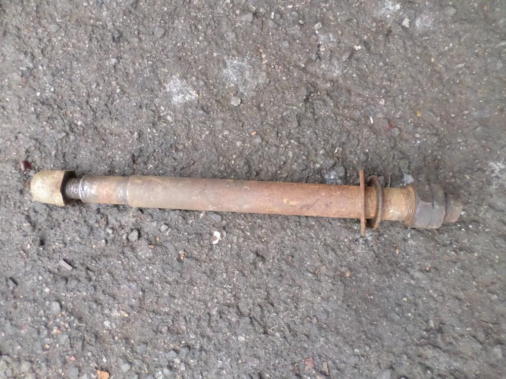

Could someone send me a pic of a race, adjusting top for my Norton Jubilee front forks. It looks abit of a wierd shape to me lol.Or if anyone has a spare one i would like to buy it please.

If you just want to adjust the headstock bearings the adjuster nuts are underneath the head stock, Slacken the lock nut first, then adjust and retighten the lock nut. Don't slacken the chrome nut at the top of the headstock. I've attached a picture of the headstock bolt.
If you want to replace the bearings be warned that these are loose ball bearings and you need patience to get them all set in with some grease.

In the Norton book for Jubilee's i have.
The race, adjusting top looks a wierd shape.
