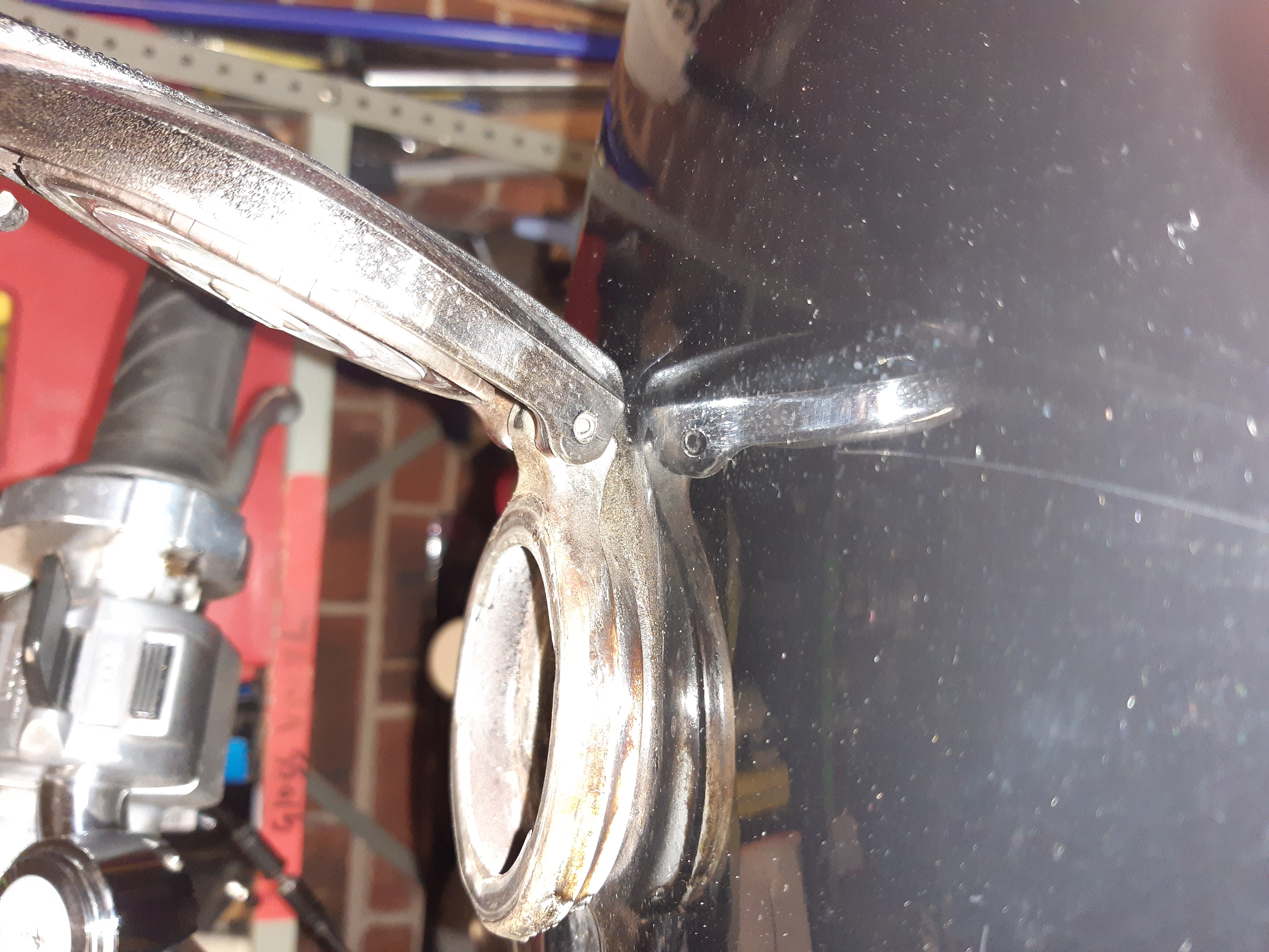

Can someone please tell me how the quick release fuel tank cap is fastened to the tank. Is it welded or soft soldered?
It's held on by a thing called a roll pin. You tap it into one side of the cap, position the cap and then tap the pin all the way in. You need a pin punch to knock it out if you want to remove the cap. Best to protect the tank paintwork around the filler cap when fitting or removing.
I'm pretty sure it is welded.
Welded on both my Mk1a and Mk3 850 tanks. Had to change filler cap on one of the bikes a few years back after warning given on annual MOT test - easy to remove and fit new one as described above.
