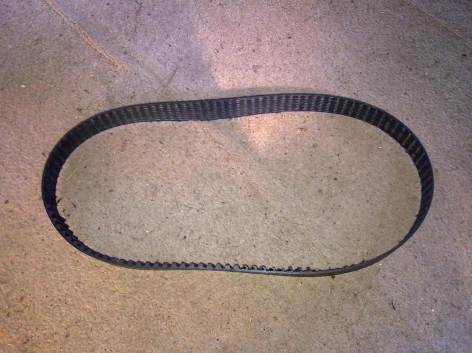

25,000 miles? Here's mine…

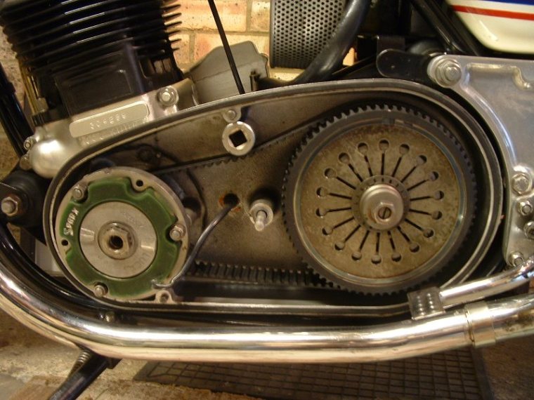

David, I run mine with a 3…
David, I run mine with a 30mm socket snugly wedged between top run and inner cover boss as a test (see pic.) Norvil do state 33mm but I felt it was a bit loose. 20mm does seem tight cold as that drum really expands. Have you noticed the clutch lever freeplay increase when hot?

25,000 miles? Here's mine at that mileage, about 10 weeksago. Yes it does get dusty in the primary even if they are set up to run as near as dammit perfectly aligned. Mine has also seen oil when it shouldn't, has been cleaned in solvent when it shouldn't have been and was to be replaced. My own fault really. If yours still looks ok with no major fraying or rubber chunks in there and it's run slack when cold, you should be good for at least my mileage.
