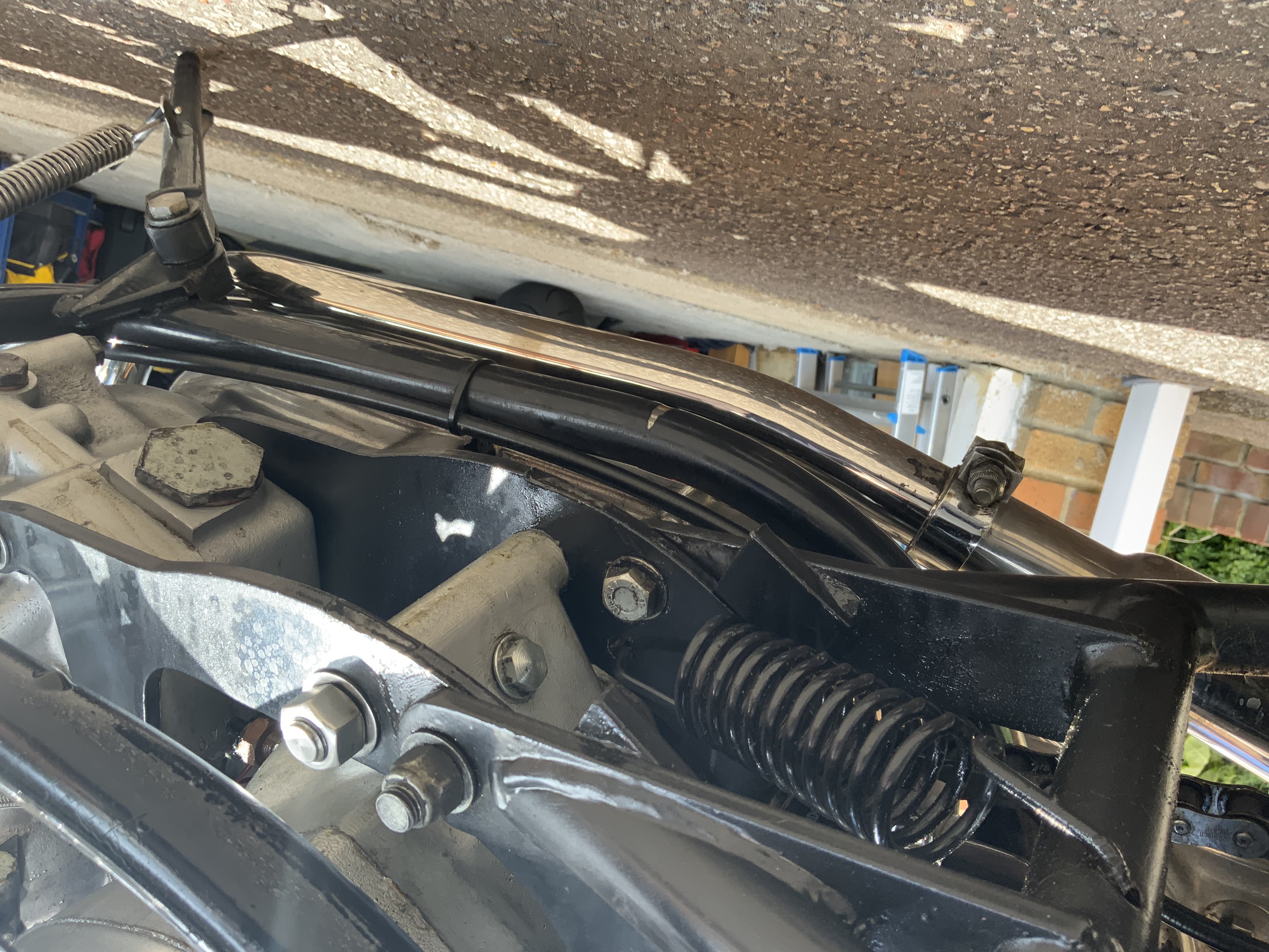

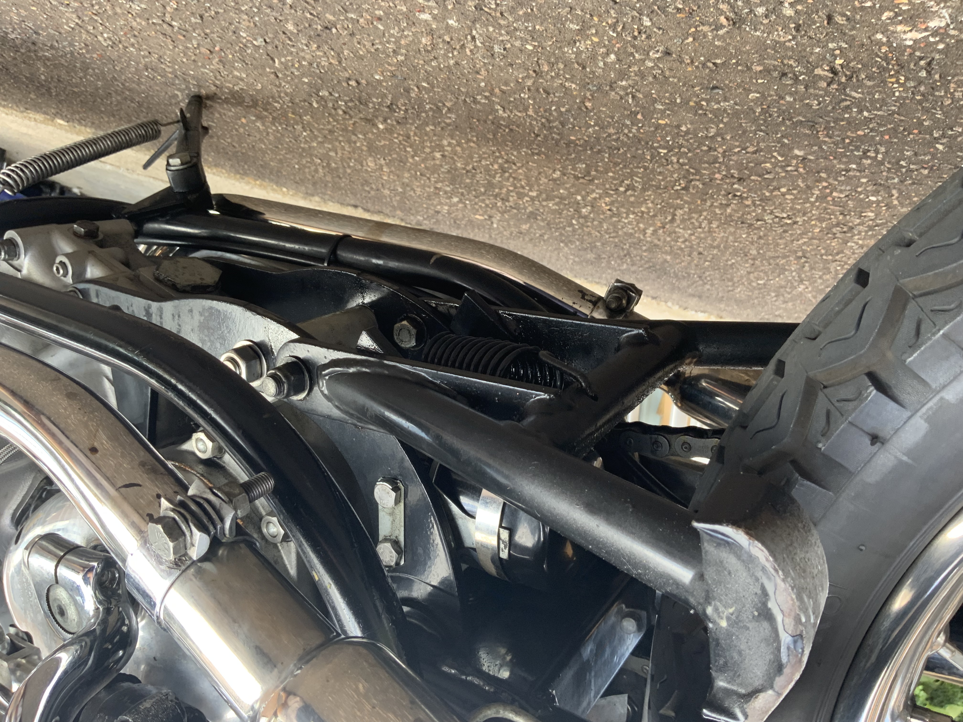

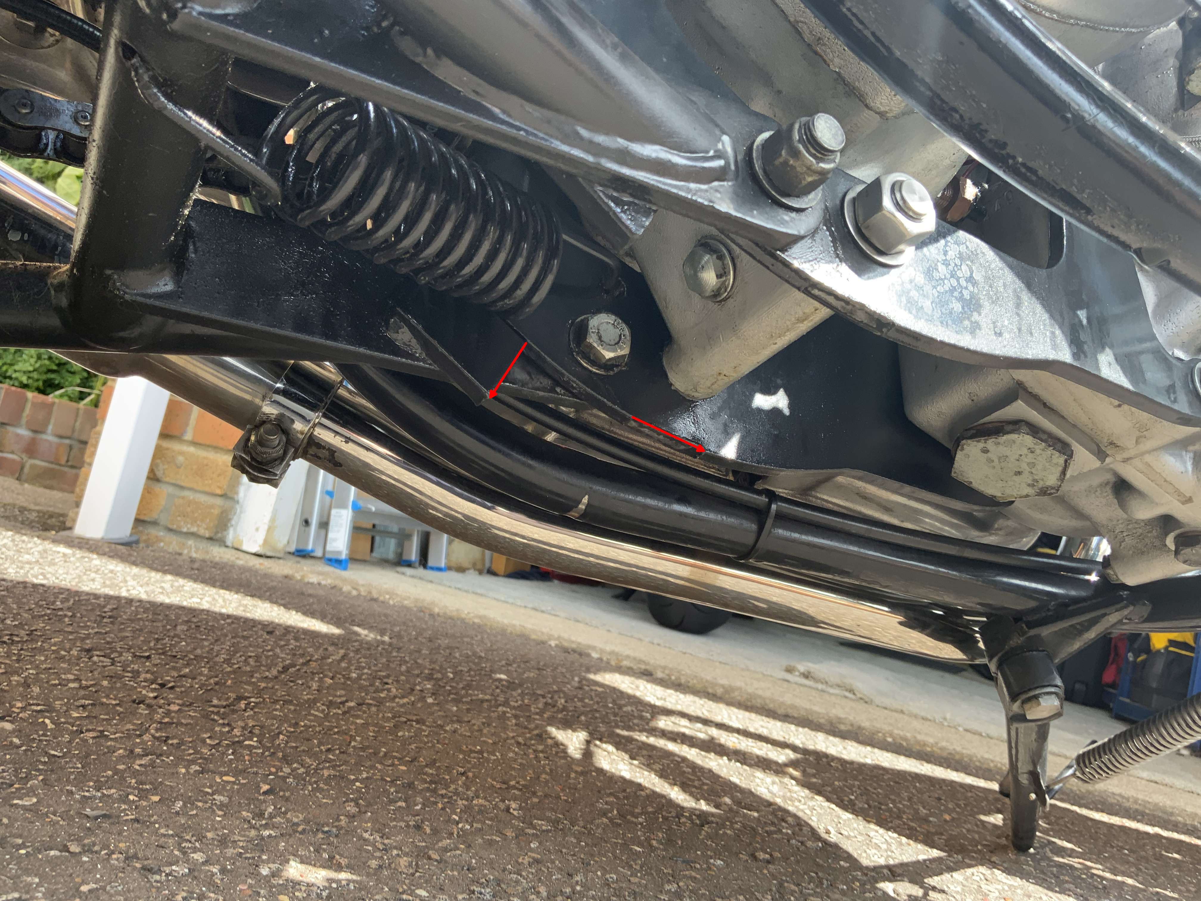

Hi Guy’s, I cannot see what is wrong. I have taken some pictures and hoped perhaps you could describe where the fault lies or perhaps send a photo of your bikes to show how the stand should look.
Thanks Again
Phil
I have marked up one of your photos showing where to get the weld applied. You cradle does not look too worn so on yours you could just get the 2 flat pads on the centre stand that touch the cradle welded. My guess your stand has never been right as I replacement I bought in the 90's was with the pads in the wrong position.
I have done 2, one where the cradle and centre stand were worn so both needed welding, a second where the centre stand had the large pads in the wrong position so that just had the pads welded.

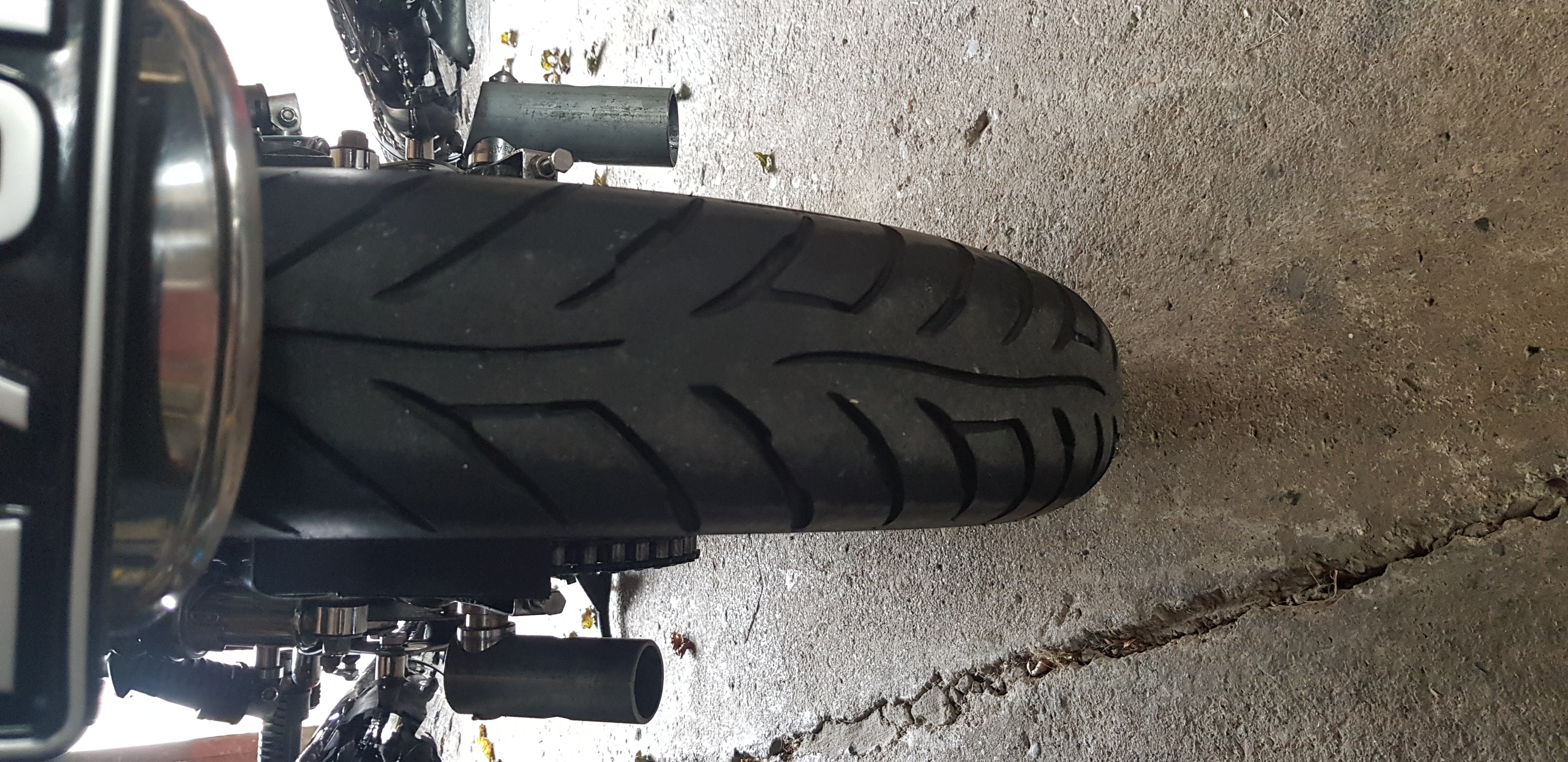

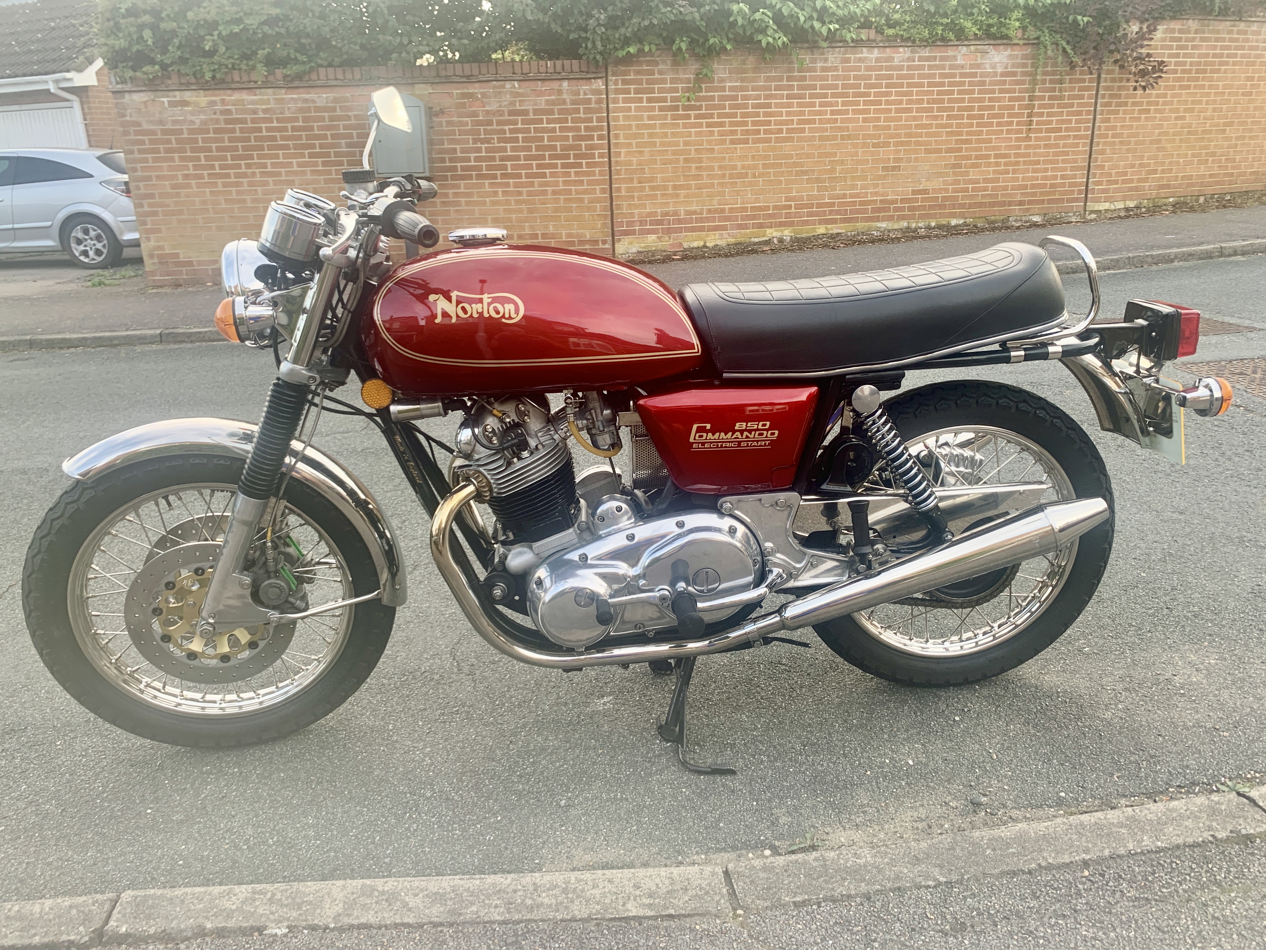

That looks like a very newish TT100 on the back wheel. If you have something similar on the front then your mainstand is fighting a losing battle against the increased ground clearance. The wear in the stand stops probably do not help either. For a simple solution I would be brazing some pads on the stand feet.
Hans, I did try to show a picture of the bike with the stand down but the image is always just over 5Mb so won’t post. I will try again tomorrow.
Phil, correct that’s a pretty much brand new TT100 and the bike has the same tyre on the front. So your saying the profile of the TT100’s is too high for the stand hence the ground clearance problem? I did try wedging some wood under the stand which although I stated was 1” in height in my original post was actually only 1/2”. Anyway it made no difference at all, the wheels remained grounded.

The foot tang on the stand looks to be touching the road, the wrongly made stand was the same on mine but worse, so bad it broke off.

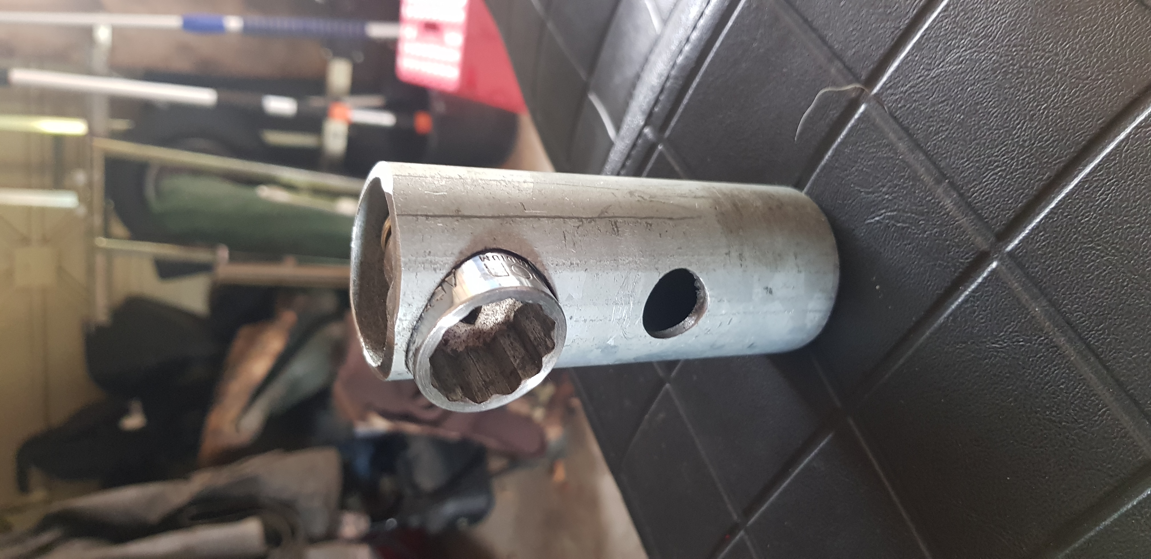

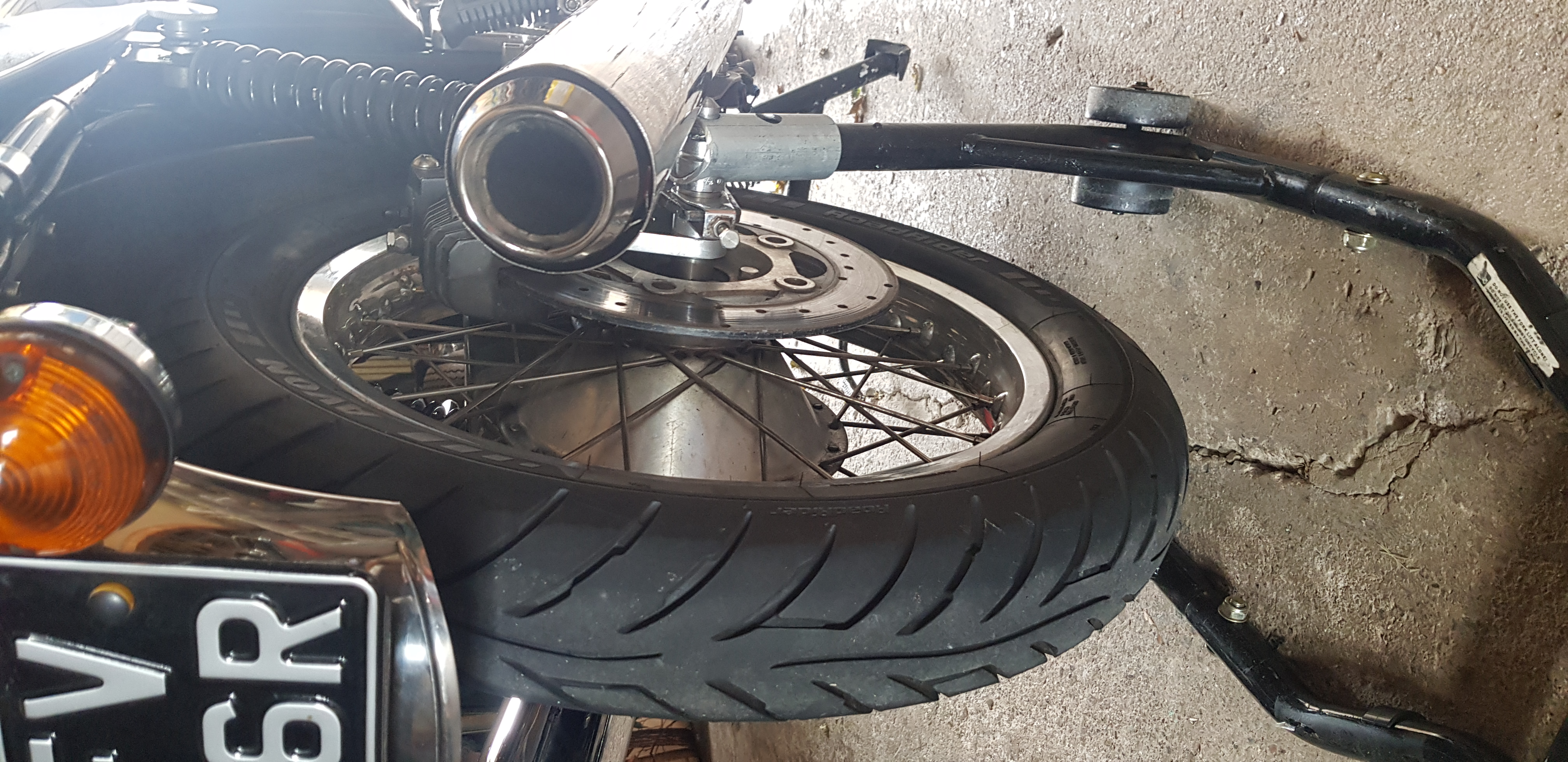

I can only get these three photos on. It's just an old paddock stand squeezed in to achieve the correct width, Spacers fitted to get the adapters to the correct height, two modified spindle Hex sockets and a couple of lengths of steel pipe. A bit rough but it works.
Dave
Hi John, Your correct the foot tang is virtually parallel with the stands feet so almost touching the ground. I will keep my eye on it.

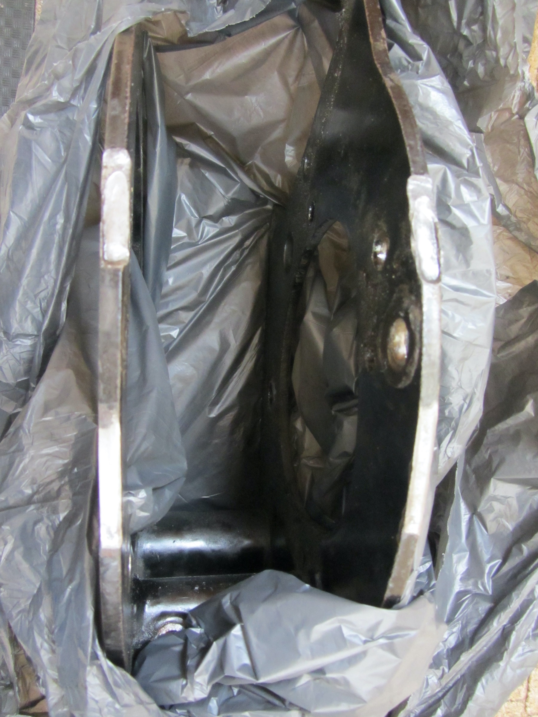

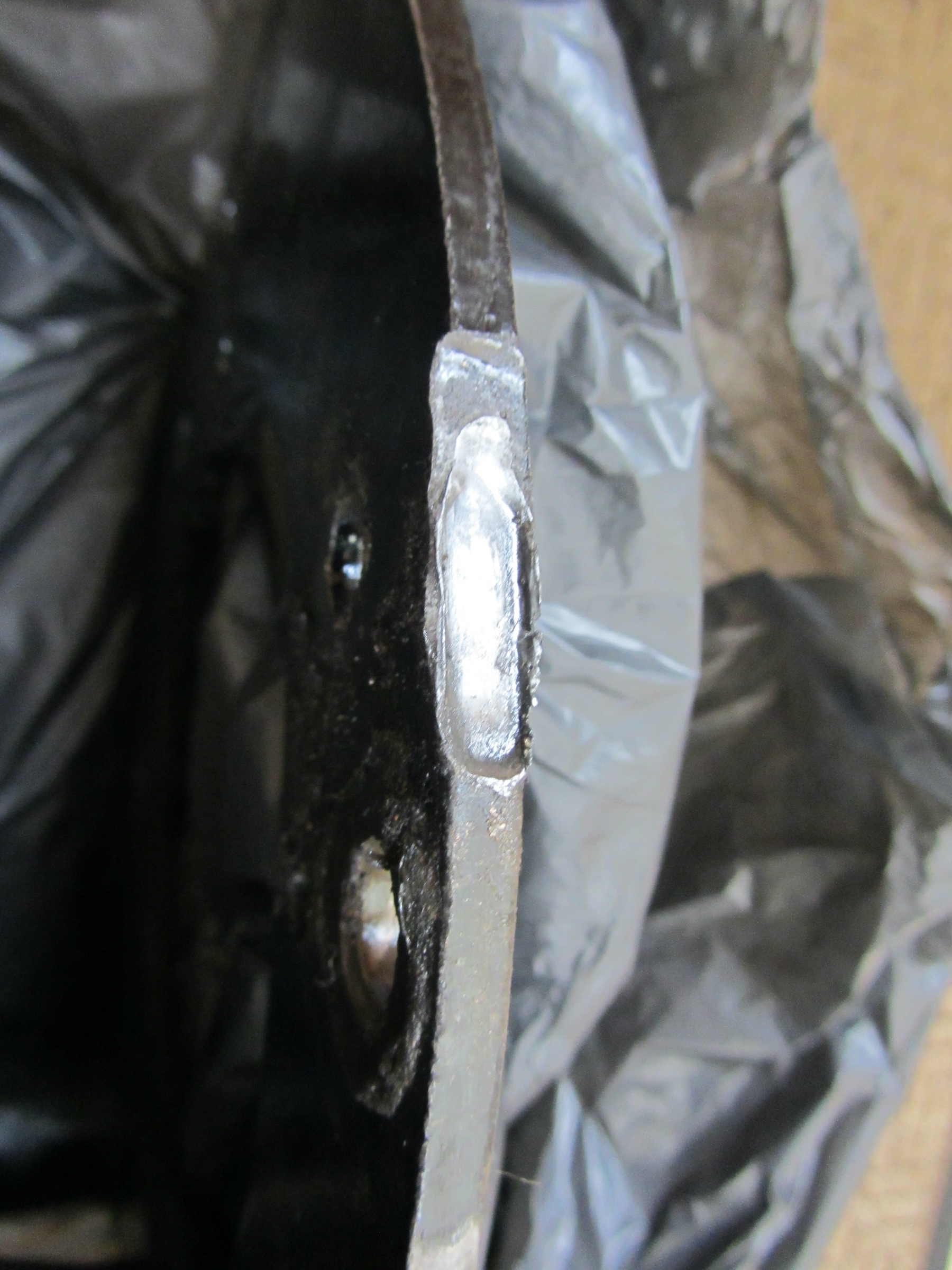

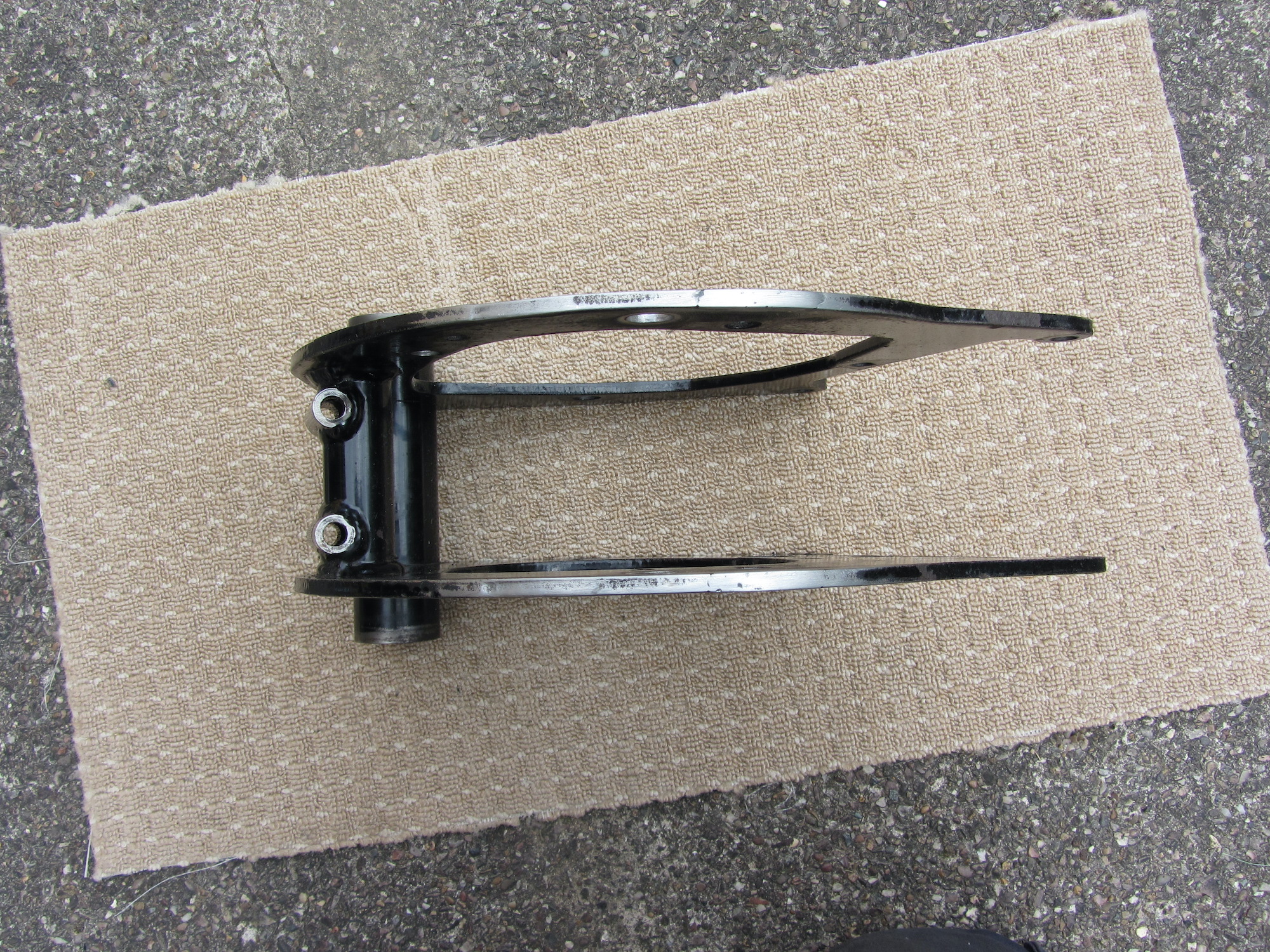

Hi, my MK3 was exactly the same and its been like that (both wheels on the ground) for the last 30 years, at the moment i'm part way through a well deserved full restoration and when i removed the cradle the wear was quite bad to say the least ! (see attached pictures).
A good friend of mine TIG welded the cradle and i dressed it back before paint, the bike isn't on wheels yet but hopefully this should have at least bought it back to factory standard hopefully.

Hi Dave, I think you do yourself an injustice. That is very neat and tidy and looks like it will be very stable. Definitely going to have a go at making one myself. Thanks ever so much.
Kind Regards
Phil

What tire (tyre?) size are you running on the rear?
350 or 410?  Might make a difference on how the rear tire is hanging?

I would think it could be hard to find a Commando fitted with these 19" 4.10 tyres with 1" room under the rear wheel. With say 90/90 front and 100/90 rear Roadriders, it's a different story.
