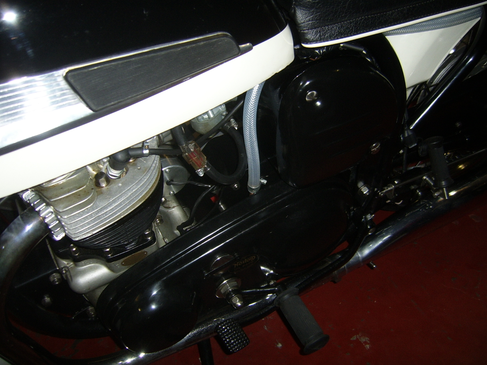

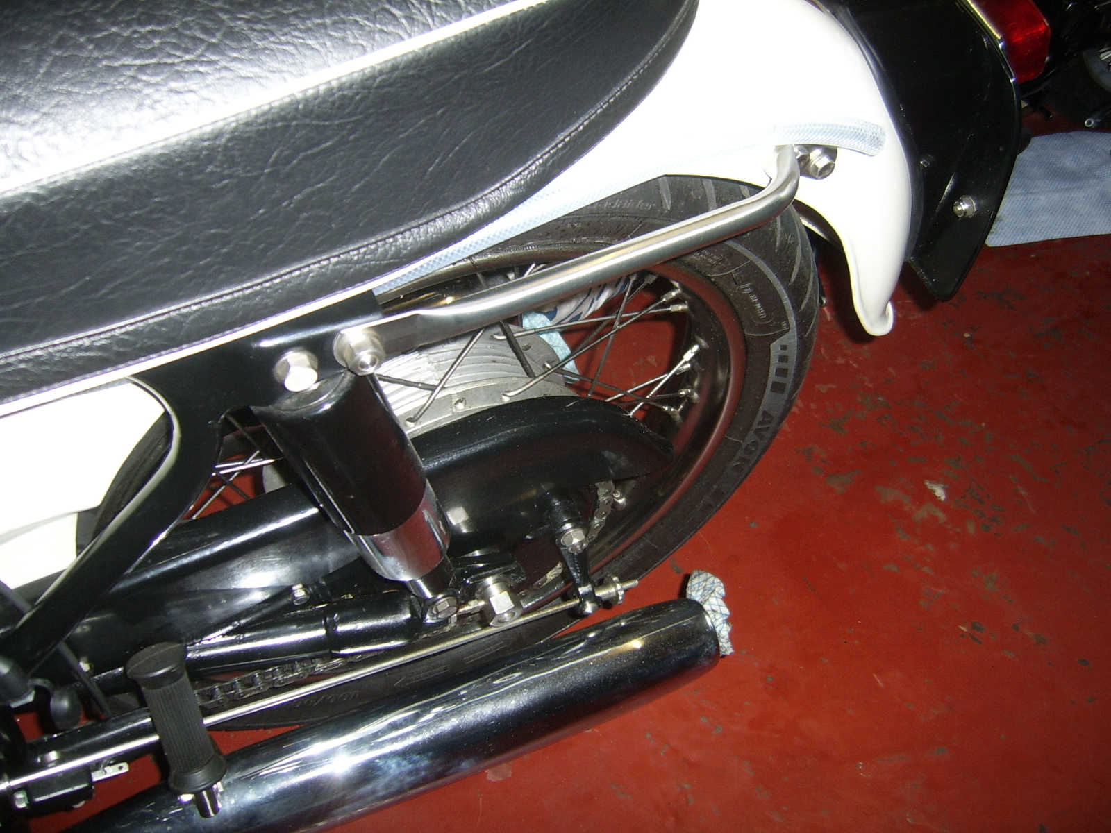

For my 99 and Dommie racer; I decided I'd had enough of oil dropping on the floor if any oil left in the sump on starting. The solution was simple, as seen in the pictures: A large clear plastic tube that raises to the rear of the bike. The excess oil never reaches the exit and eventually goes back to the sump.
This is certainly .....
.... a very simple solution Neil.
I think if a ducks bill kind of valve is fitted to the end, there would be some lowering of the crankcase pressure as well.
I'll certainly try it.
Thank you all.
