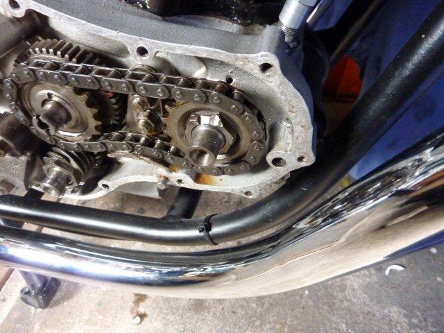

John Hudson was very perceptive, the previous owner of my machine only had a kitchen knife a chisel and an adjustable spanner. Just about every nut, slot head or bolt was rounded or mangled. Attached is a picture of my camshaft nut. I think that was his/her chisel phase. QED

That sort of thing happens…
That sort of thing happens when owners are too cheap or lazy to buy a set of British Standard sized socket or box spanners...
VERY nasty. The proper too…
VERY nasty. The proper tools for dismantling are: two hammers -one claw one lump; large & small cold chisels; large flat blade screwdriver and plumber's wrench or molegrips. Trust me, you'll be fine with them.
