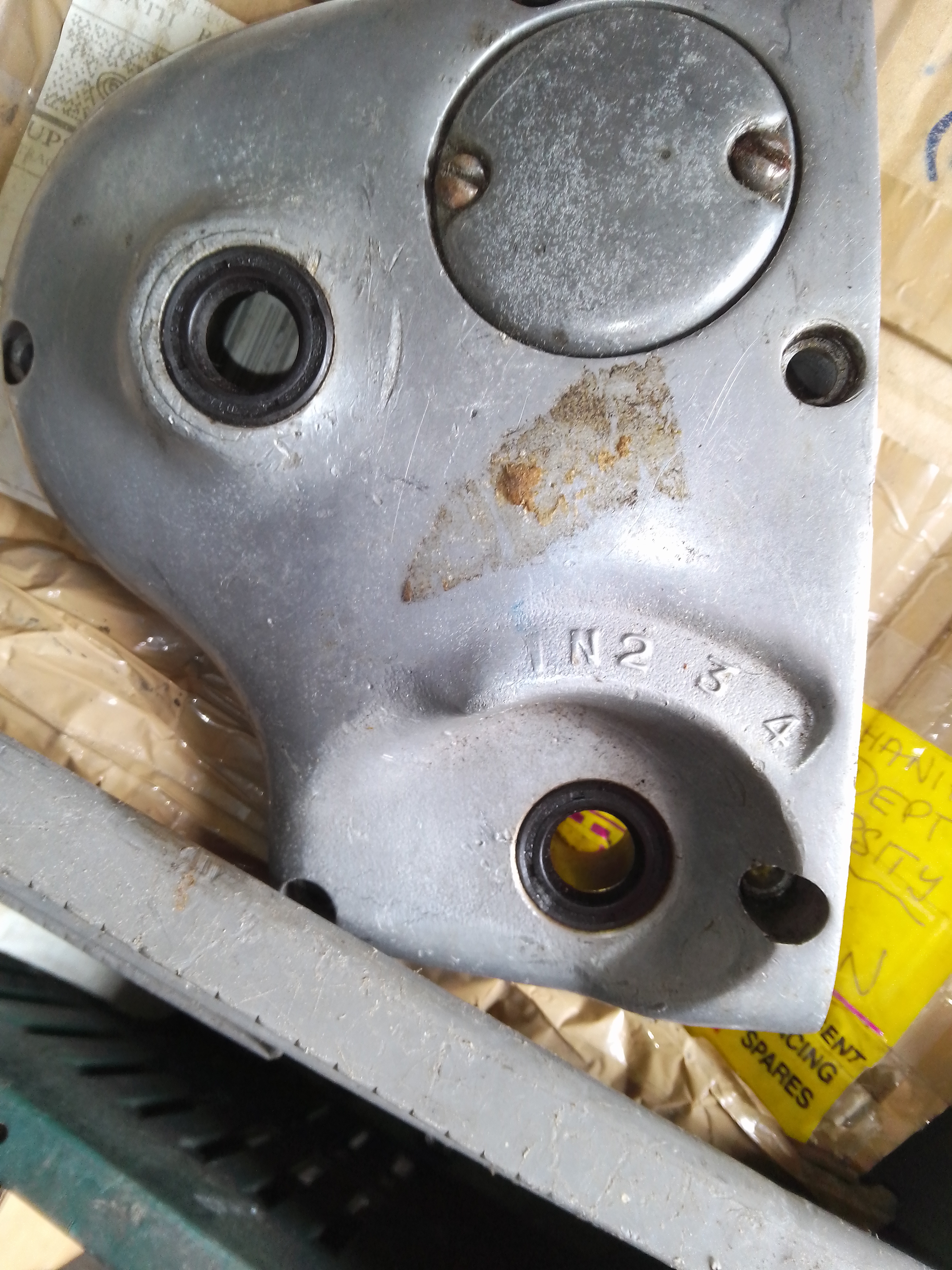

Sadly, our existing supplier could not do them any more and a replacement supplier has yet to be found. If your leak is from around the gearchange spindle (& not from the centre spindle), then one solution is find an appropriate conventional oil seal, and have a machine shop install it in the outer cover for you.
See photo attached
