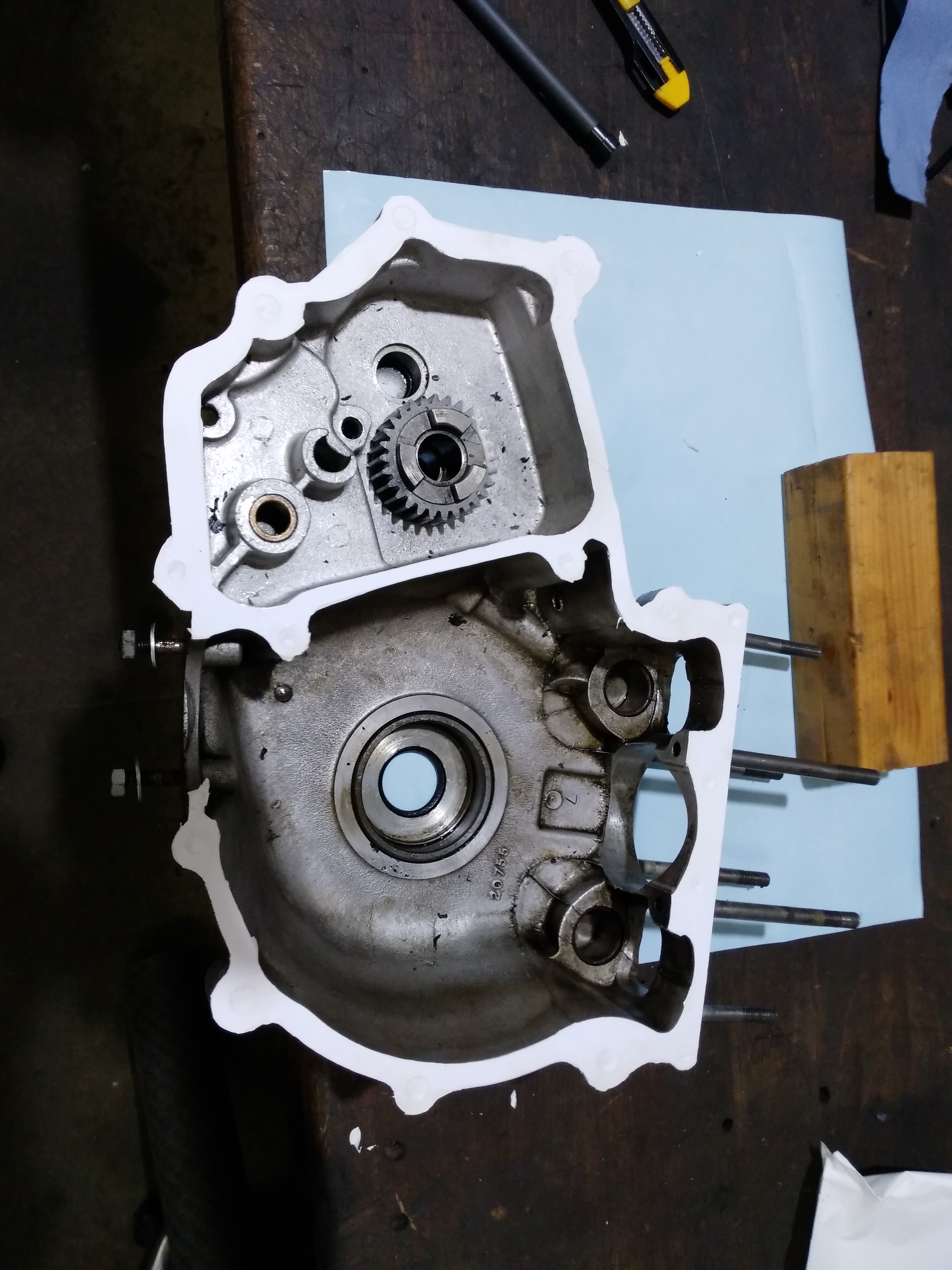

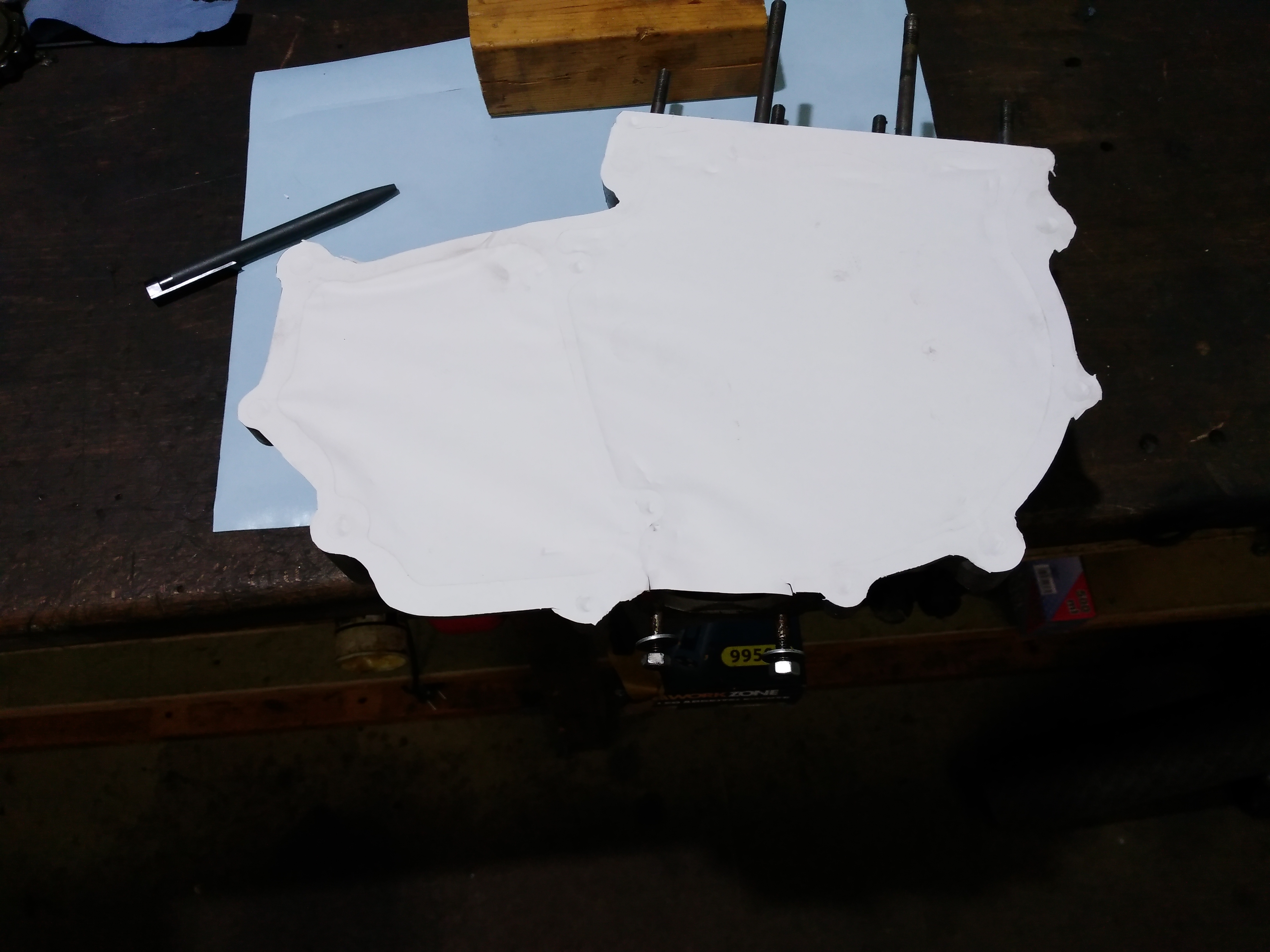

Yesterday I bought a square meter of 0.25mm gasket paper at a local auto supply store. Now I have enough material for several engines. I also got a piece of car foil from a friend .He makes foils and stickers for cars. I placed the foil with the sticky side up on my workbench, placed the drive side housing on it and cut out the outer form.
foil on housing
Then I cut out the inner lines and marked the holes for the bolts.
foil 2

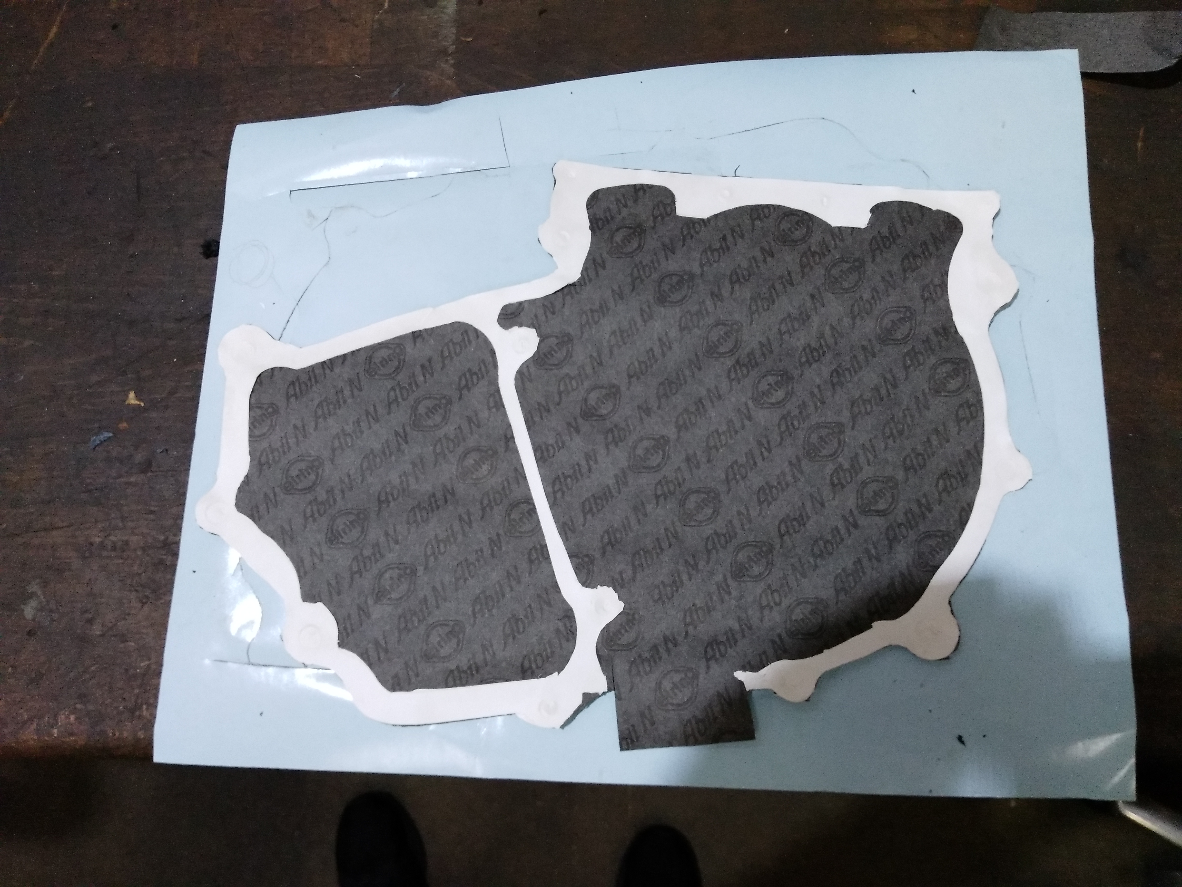

I placed the foil on my gasket paper also cut to match the outer shape of the engine housing.
gasket1

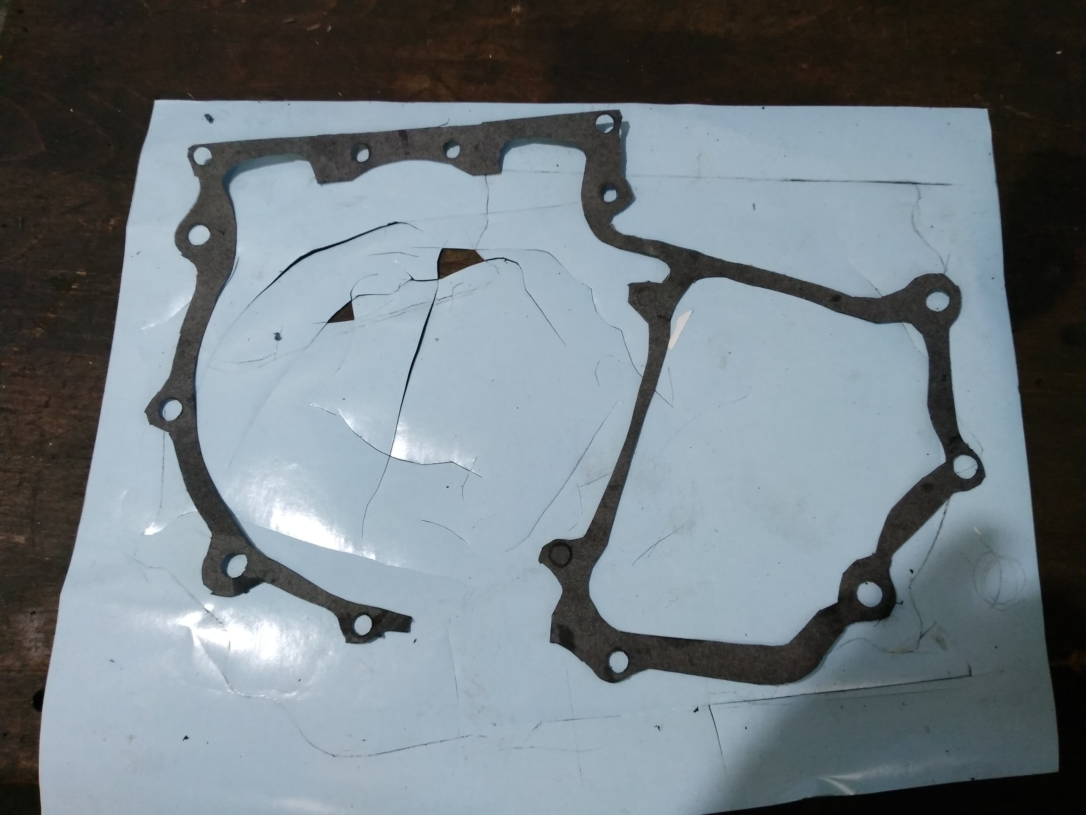

I punched out the holes and cut the paper with a sharp cutter.
gasket ready

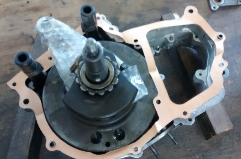

I finished the rounded egdes with sciccors before placing the gasket with additional sealant on the engine halves.

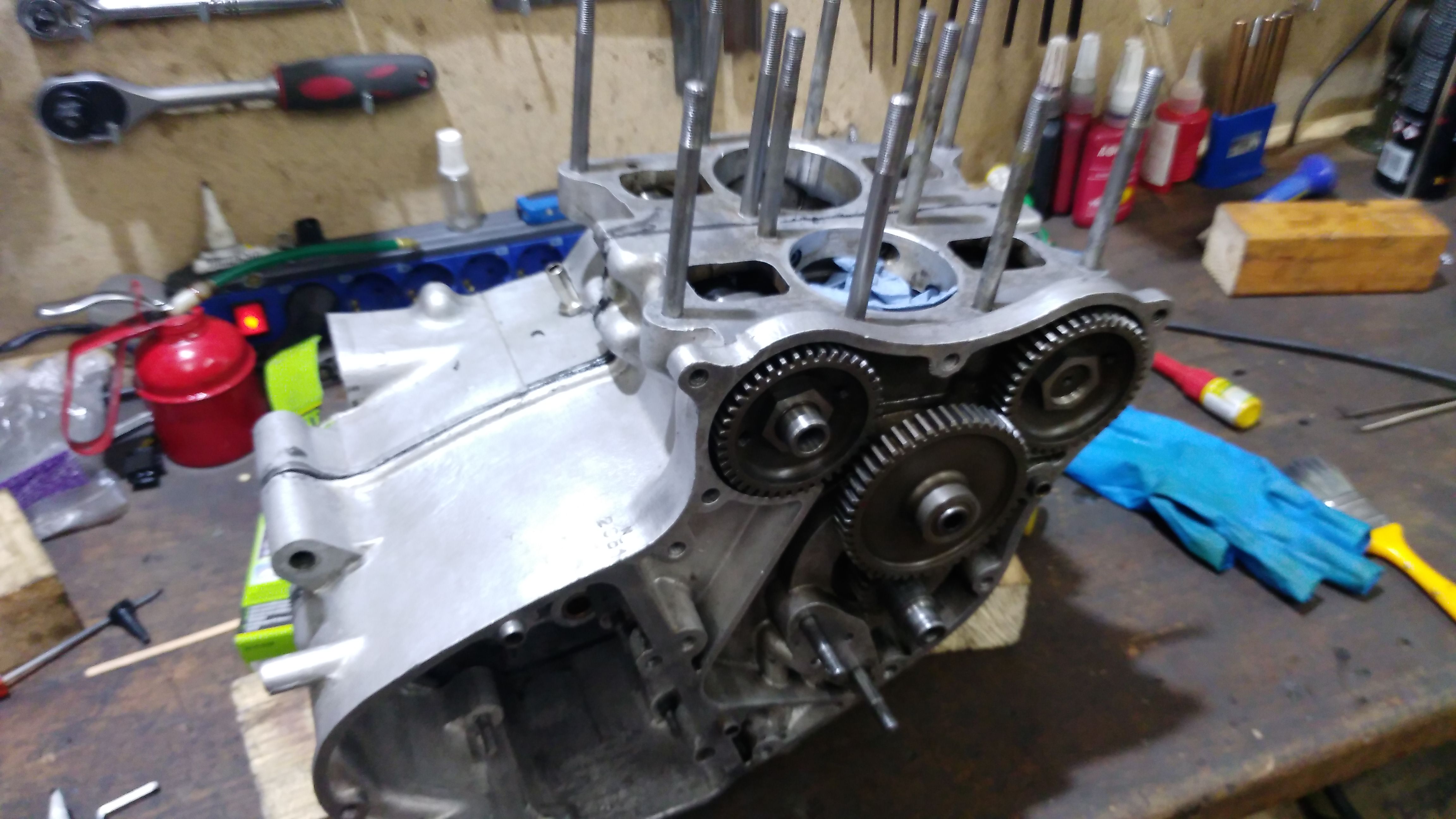

Crankcase is in, now for the correct timing , gearbox etc, etc.
crankcase closed

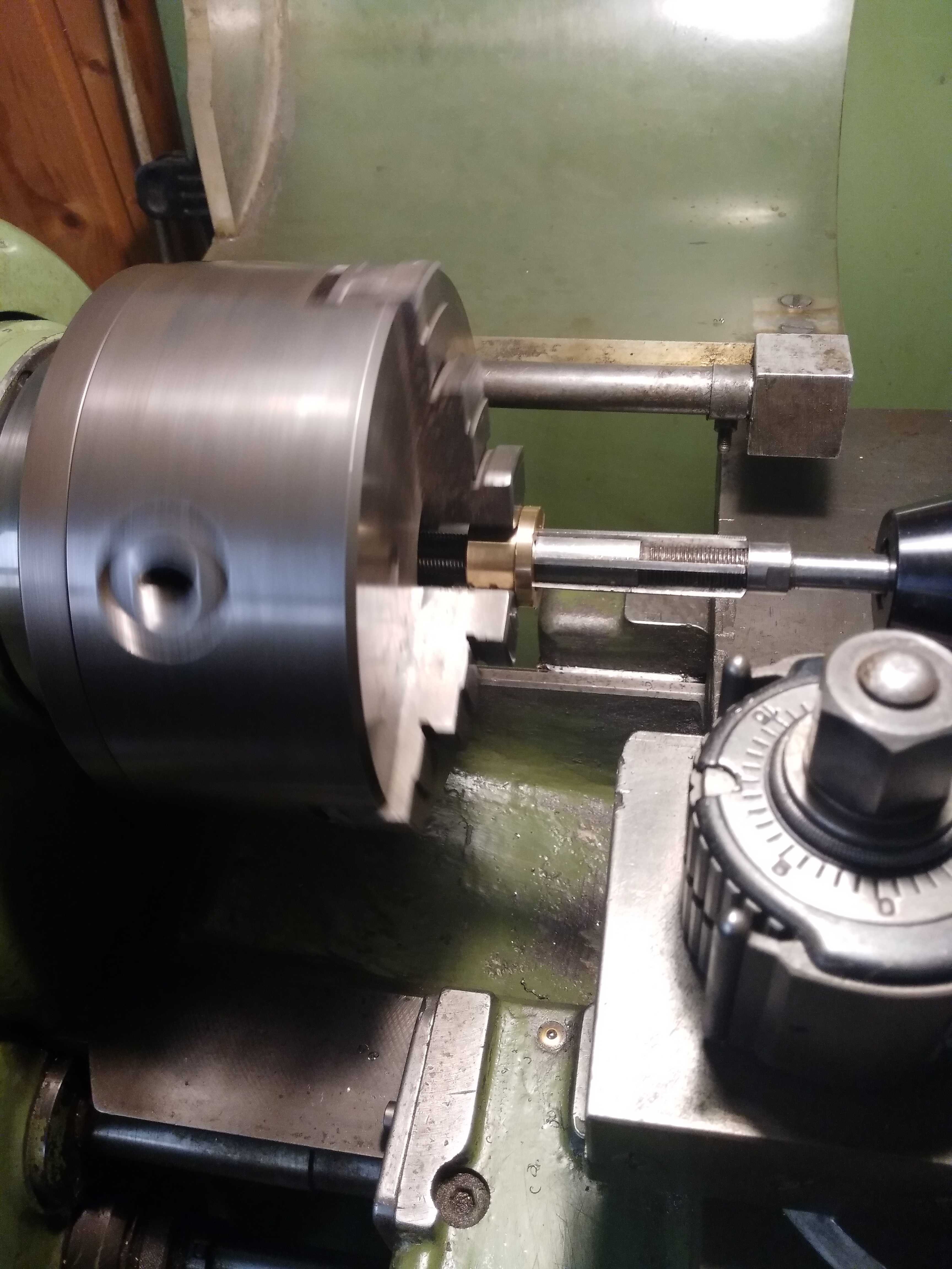

My friend Martin had to re-ream the bush for the layshaft he had made for me.
reaming bush
When in place it was too tight for the layshaft.
