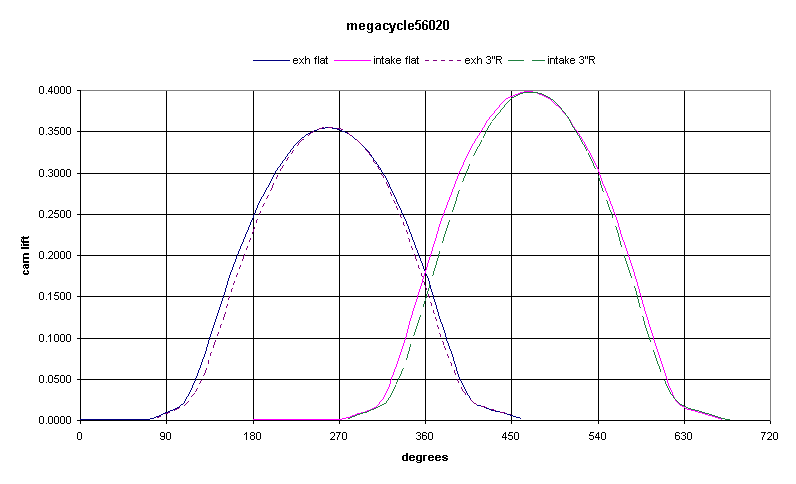

On the topic of flat or…
On the topic of flat or radiused followers. As Phil Vincent writes in "Tuning for Speed" , the radius of the follower doesn't affect lift or valve timing, but flat followers accelerate the valve opening and increase valve opening somewhat. They perhaps used radiused followers on the early engines to reduce valve acceleration and improve the life of the cams? Then as the motorcycle magazines started emphasising performance figures and bikes moved further towards leisure toys they were forced to "tune up" the engines (giving the public the SS models) regardless of any adverse effects on cam life?
flat VS radius
"flat followers accelerate the valve opening and increase valve opening somewhat."
True but reduces manufacturing cost I would guess significantly as well as reconditioning costs. I should rephrase...radius and flat have identical full lift as can be seen below
Thanks David. I wonder why…
Thanks David. I wonder why they bothered to radius them, since the areas under the curves are so close? Anyway...sometimes owners have asked which type they should have, and it looks as if it really doesn't matter (use whatever you have or can get hold of)?
