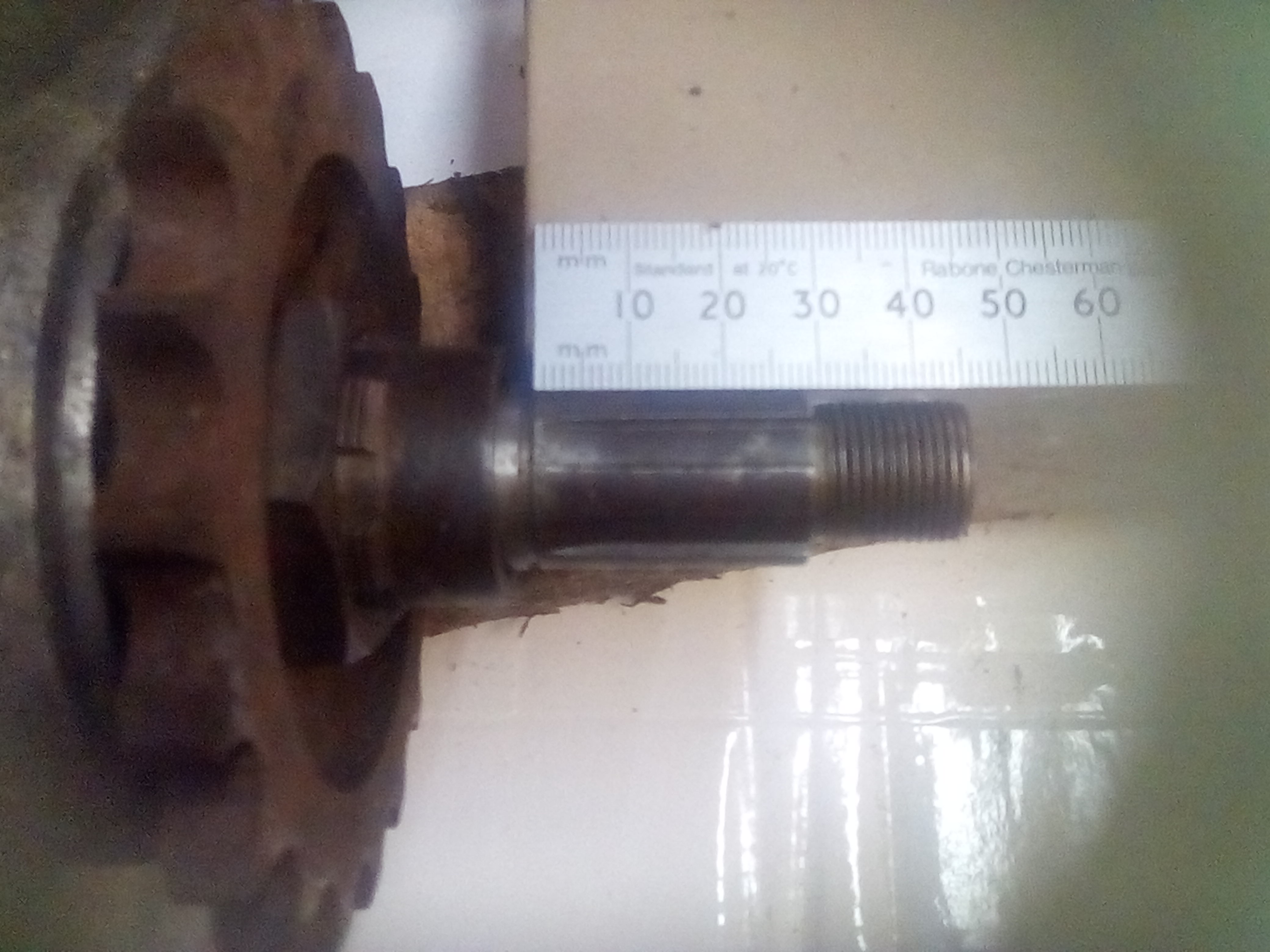

46mm end to start of groove
Don't want to hold you back, so 46mm from end of shaft to start of groove. I will try to add a photo to remind you what end of commando shaft looks like, and show how much of shaft there is between output sleeve and start of groove. Still doubt you would get a nut on with commando centre on a dommie shaft.

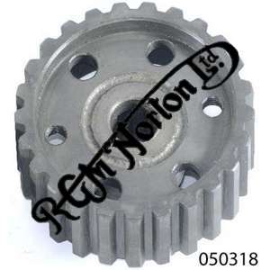

Alternative is cough up 69 + vat for 050318 from rgm motors for a clutch centre to fit your shaft
Choice is yours

The RGM/Hayward part is now £84.00 plus VAT at RGM, and that does look like the easy option.
