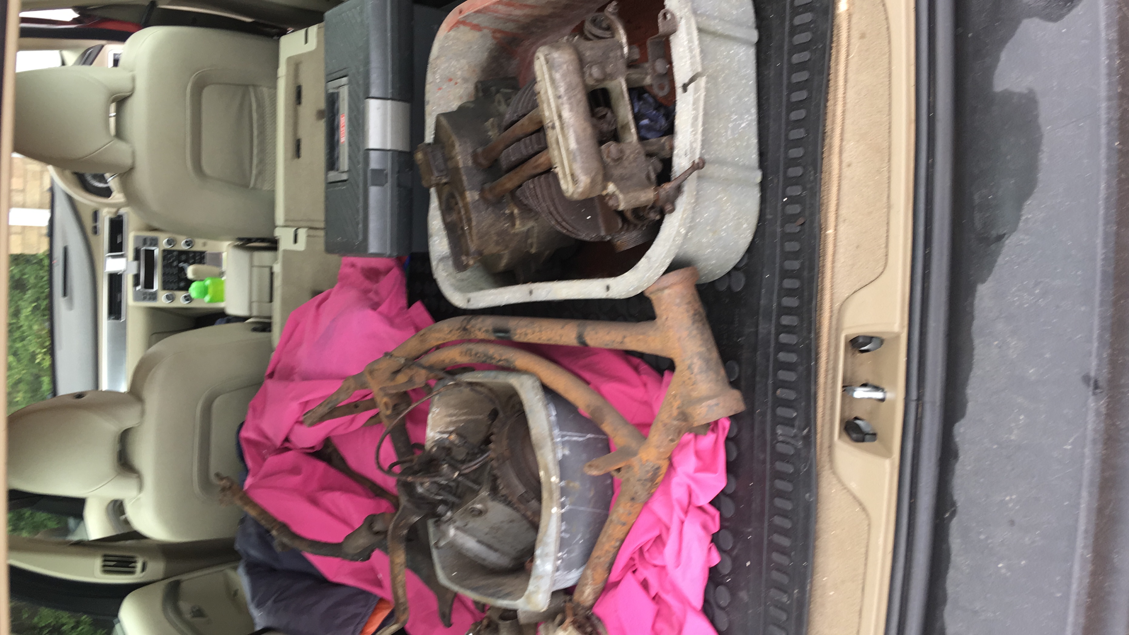

I'd look at finding as many parts as you can find before worrying about the rest.
Some bits are easier to come by than others but if you have the frame, engine, forks and tanks its a good start. Do you have any documents? This will make life easier as you can use more replica bits.
There are some poor quality replica primary case castings being made which are best avoided.
Post a picture and the guys here should be able to help.

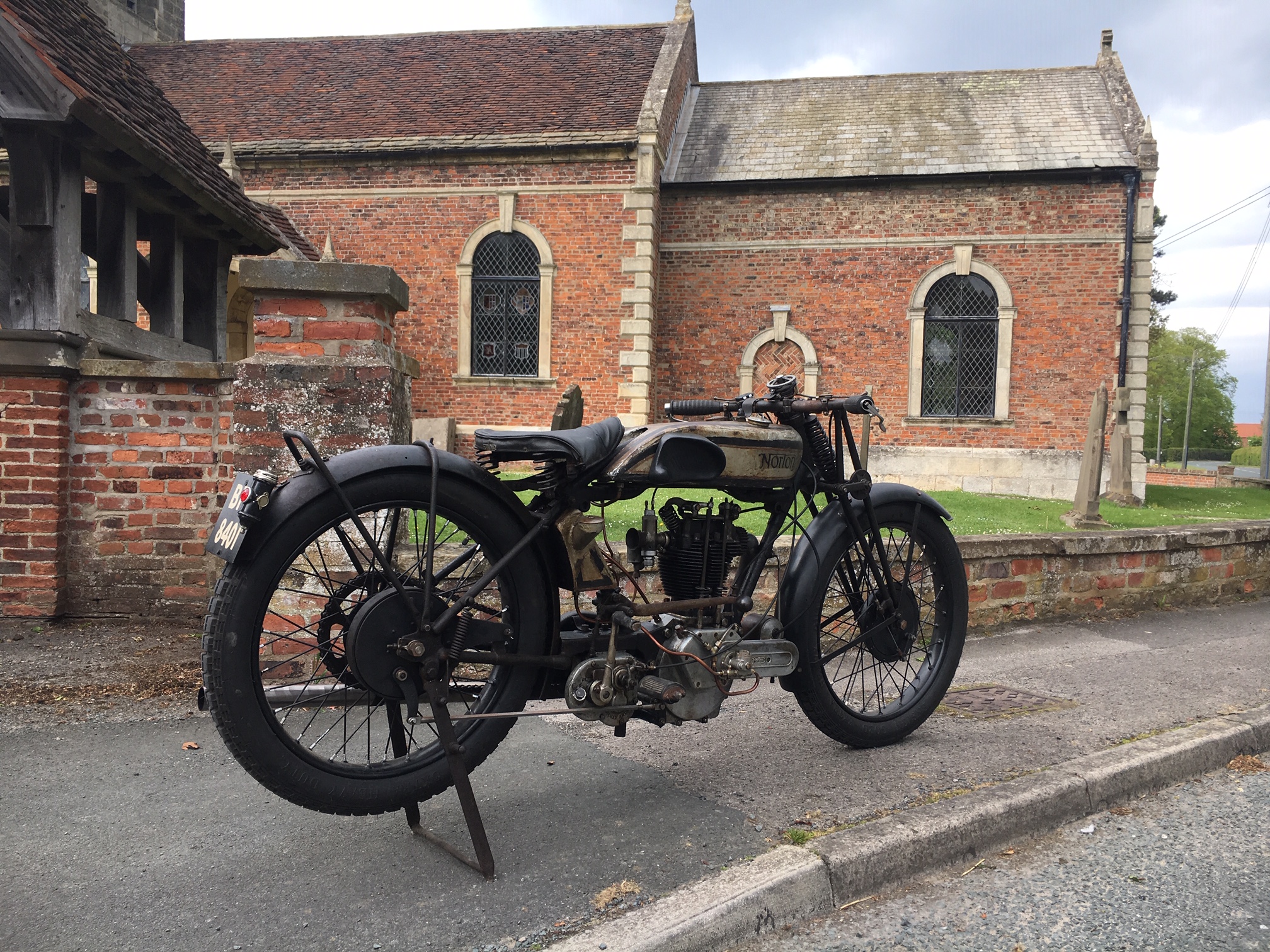

Great looking bike...   ... and workshop!
