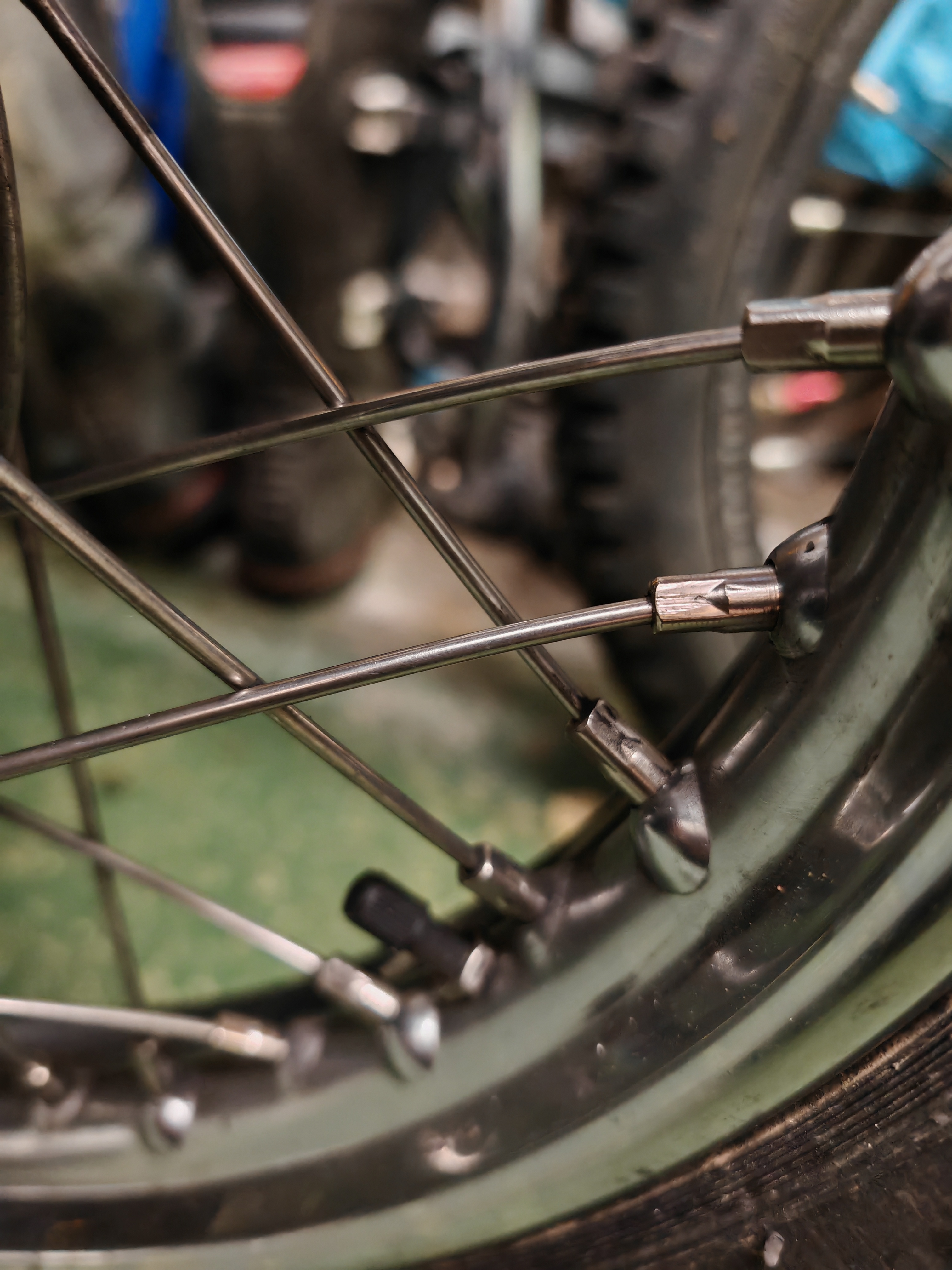

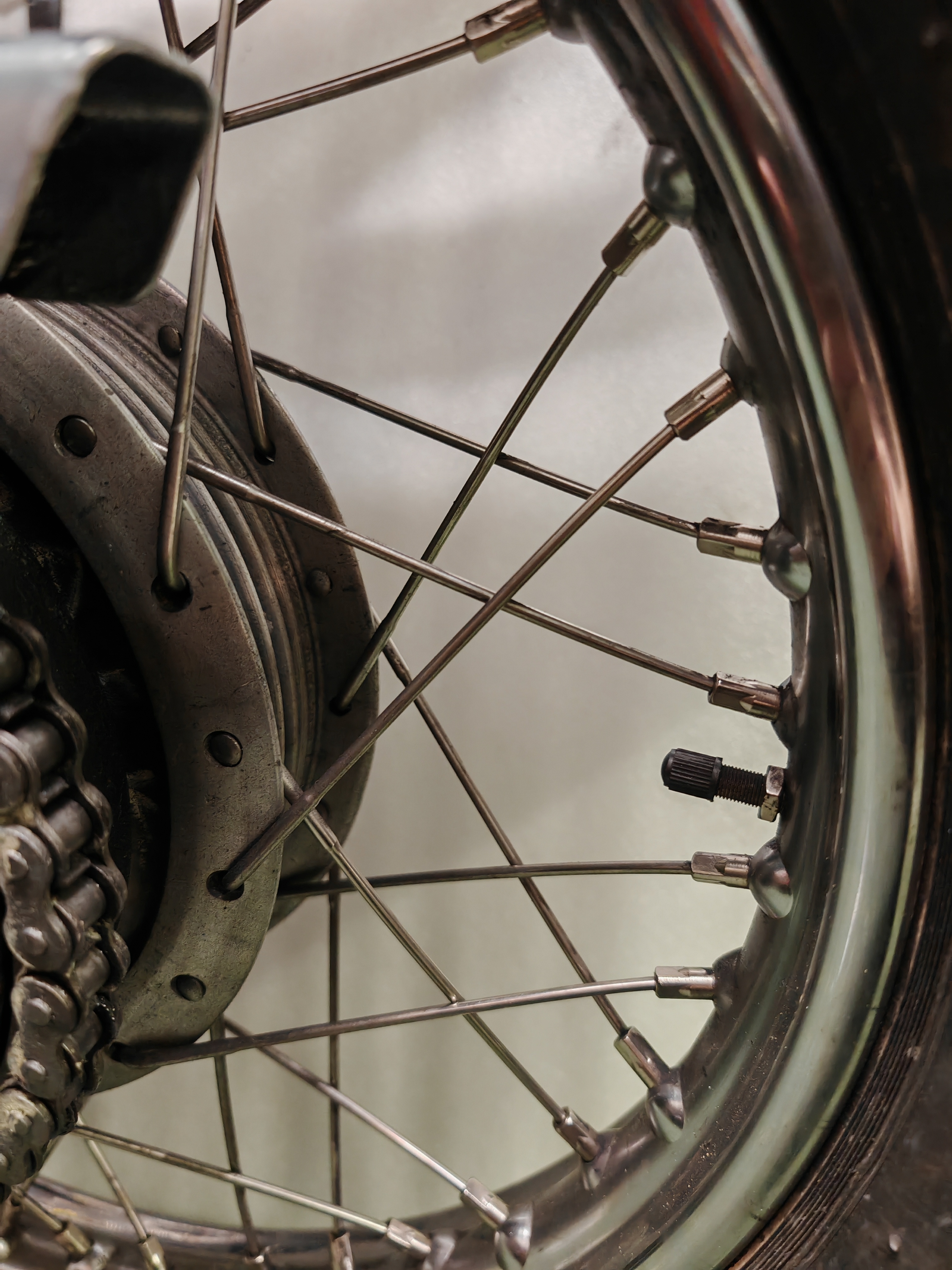

Having recently acquired a good hub to replace my damaged one, I eyed up the job on the existing wheel and noticed the spokes look stressed. Can anyone please confirm if they think the rim pocket holes are at the wrong angle, or possibly the spokes and nipples could be the wrong diameter?
Looks like the nipples are…
Thanks Peter, the spokes and…
Thanks Peter, the spokes and nipples do look a bit chunky. It's a pity as they're nice stainless ones too. I'll get the verniers out to measure them.

Looks to me as if someone…
Looks to me as if someone has bent the spokes in an effort to take out some built in slack seeing that some spokes are bent in one direction and some in the opposite direction.

Rear wheel
Hi Adam, glad to hear you're getting the wheel sorted. If you want offset figures RGM have a list on their website under "technical tips, help & instructions" located at the top of the website page. I also have an original wheel I could measure for you. Best wishes, Terry.
Looks like the nipples are too tight a fit in the rim holes, (so the nipple can't align with the spoke) or whoever built the wheel got the lacing pattern wrong.
The worst example i've seen, of this kind of thing was on the front wheel of a 350 Manx, the spokes had a nasty bends in them to line up with the nipples. It was lucky the owner kept the bike as a museum piece and didn't ride it.
