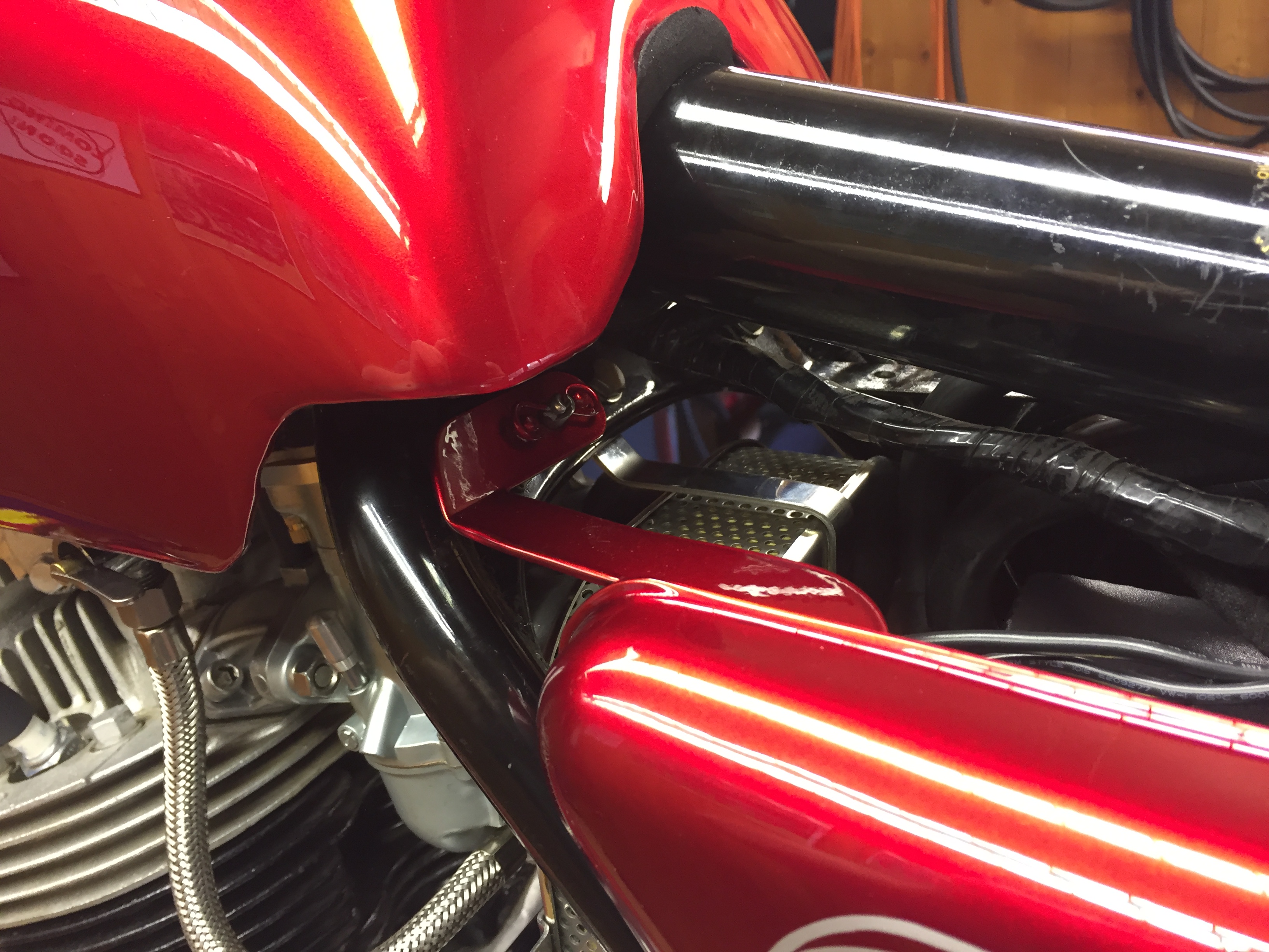

The only challenge is the top fastener on the left sidecover, which is usually attached to the black box.
The necessary bracket is available to address this though!
dzus
thanks for the pictures looks good.have you attached the bottom of the housing to the battery carrier .I was going to keep the standard battery carrier, i already have bracket for side cover  the black box was missing when brought the bike .is the top bracket that comes with the housing attached to the web on the frame above the carb    thanks for your help  don scriven

The side panel and top of the filter are indeed secured to the frame tube bracing plate.
Surprisingly, the holes were already there for these.
top
