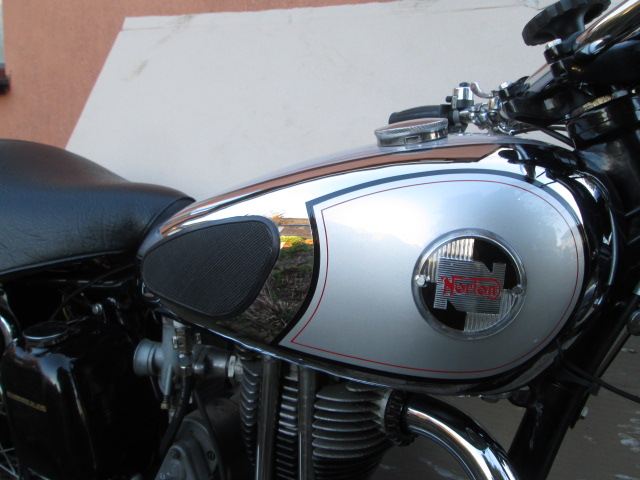

knee pads
Any views on the best adhesive or double sided tape (?) to use for sticking the knee pads onto a freshly panted/lacquered tank?
Also, does one spread it all over the pad or simply round the edges? They are slightly concave in the inner faces.

I used Evostick contact adhesive on my stick on knee grips.  I marked the outline on the tank, then spread a thin layer of adhesive to the tank and the roughened rubber knee grip, waited as per instructions, then carefully applied them.  I made sure there was good adhesion at the top edge to prevent rainwater getting in behind.
On the ES2 tank it was a chrome finish, but I've just done a similar thing on a Domi tank that has a painted finish, both seems to stick well.
