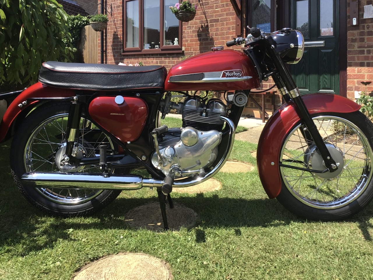

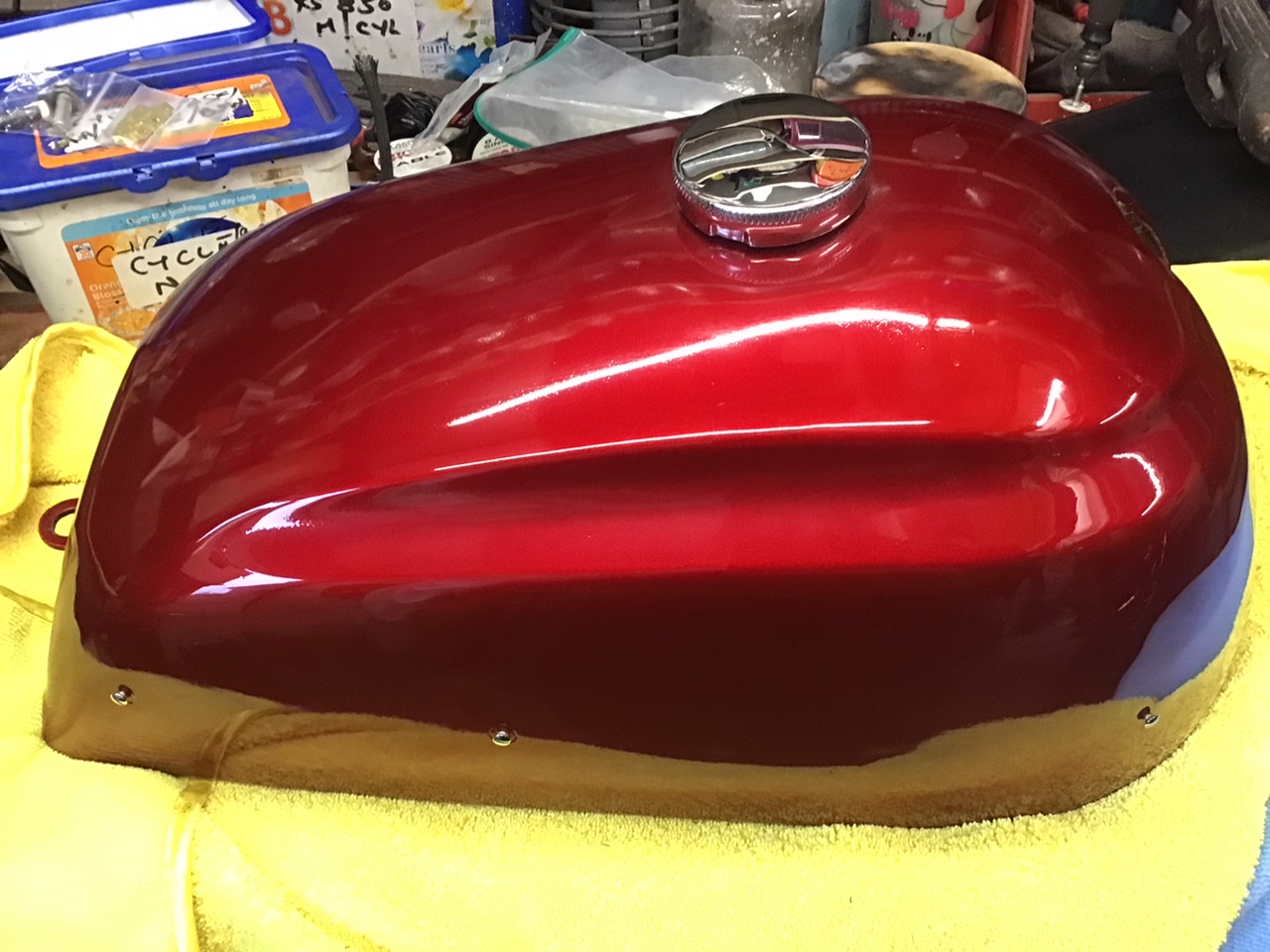

Hi, I took an age trying to find the correct “flamboyant burgundy” but struggled immensely to match anything with what little I had on the tank. After a lot of trial and error with different colours and many discussions with people I took the possible closest to be a “cherry red” but found “Candy Apple“ to be more acceptable which is what I did my 65 Jubilee in (although I’m not sure it’s as “burgundy” as the original was, but without an original paint to match it was a bit of guesswork!).
All paint was cellulose except primer - 4 coats yellow gold base, flatted, 4 coats clear lacquer dyed 10:1 candy apple red.
Don't know if it helps anyone but see pictures

So far John - lots of care, lol.  Seriously, it’s something I’m paranoid about, but after all the glazing, waxing & ceramic coating it’s a bit of protection then just care when filling - but - it’s early days as I’ve not filled from a pump (yet) as not on road.  Just have to see how it goes - I know cellulose isn’t the best for petrol spills but I’m not equipped for 2 pack spraying and I prefer to do as much work myself as possible!

Hi Bruce. Bike looks great.
I,m in the process of spraying my De luxe with cellulose. How long was it before you cut and waxed the new paintwork, also how long would you leave the paintwork before bolting it together, just a bit worried that the bolts will sink into the new paintwork.

Hi John - months! Left each colour before next at least 4-6 weeks then topcoat about 2 months before cutting back etc (early Oct 2019 gold, late Nov red, late Feb 2020 cut back/wax etc, late March fit to bike), I wasn’t in any rush though and had loads of other things to get on with!
