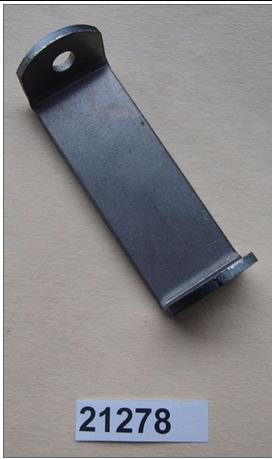

You are all correct in that the rear 'mudguard' is only 1/2 size and fits under the seat in front of the wheel. Norton invented the 'hugger' before such a thing existed! It fastens in two places:
1) An 'up-along-down' bracket, fixed to the centre channel and under the swing arm. Its Plate No G98 on the frame drawing in the parts book (PNo 21278 - in stock NOC Spares).
2) The frame spacer G19 has a bracket welded to it that supports the back of the tool tray AND the top of the semi-mudguard.
