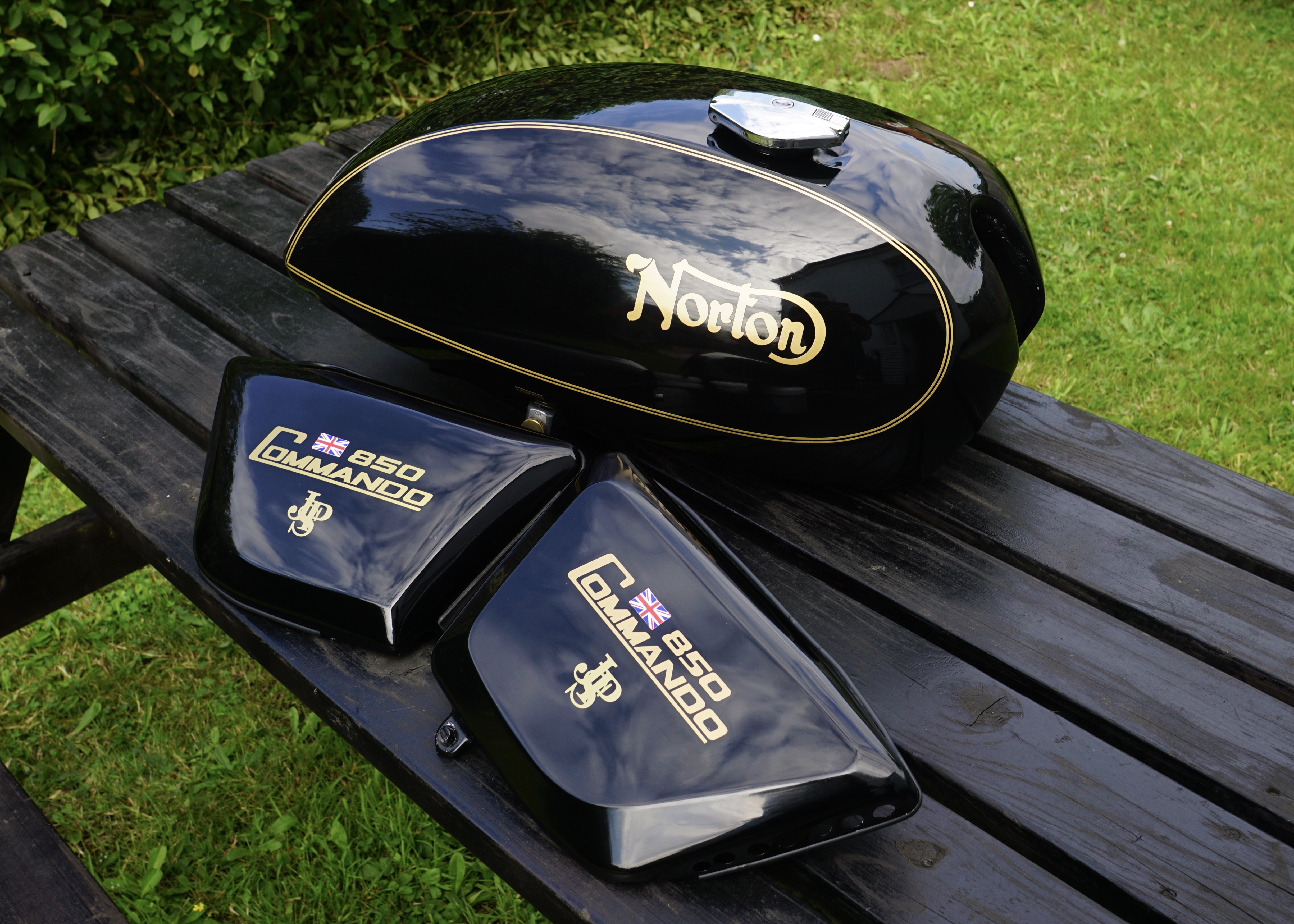

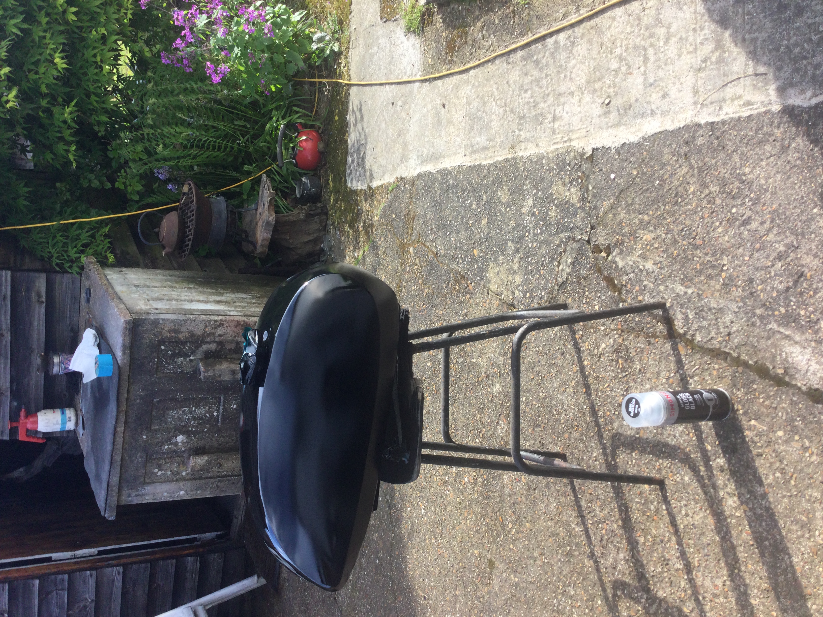

I took my Mk3 tank and side panels back to bare metal, repaired accident damage then primer and 4 cans of Simoniz acrylic Black Gloss to finish. Tank underside in Simoniz Satin Black after prep.
Black top coats done early on a warm still morning outside on a stool, with recommended waiting times between coats. Cured for 48hrs in a spare room with a heater on and window open.
Final wet sanding then cut & polished smooth to eliminate any orange peel or spray patterns. Decals and pinstripe applied then final wax polish.
No clear coat and I prefer standard decals rather than brush pin striping etc. More serviceable to touch up road chips etc in use and still looks OK.
Cost including new AN decals, paint plus items I already had was under £50.

Lovely paint job Neill - where did you get the pinstripes and how the hell do you apply!
Cheers, Mike
Pinstripe
Hi Mike
I did it with two 3" paint brushes set very carefully on their edges between thumb and index finger .
Or if you don't believe that try this from Amazon R311606 Bright Gold MT 3/16" x 40'. Arrived fairly quickly from the USA and just under £15 delivered. Slightly more now but an excellent product.
Couldn't find anything in the UK at the same quality or price and matches the AN Norton stickers
https://www.amazon.co.uk/SHARPLINE-Prostripe-MultiStripe-Pinstriping-Tape/dp/B003V5GZR8
Best on a warm day or room with tank firmly nestled in a soft towel or rug and clean paintwork, no wax. Start from rear bottom and slowly work up toward the cap and around the front curve,
Tape slightly tensioned (not too tight or it'll break) and second finger following behind pressing it down firmly so but by bit it follows the line you choose. Stop start if you need.
Continue around to the bottom and along to the rear, crossing over where you started. Terminate with scalpel remove the tape backing and press completed striping firmly in position with a new microfibre cloth.
If all goes well your first attempt will be the final one. Was with mine. If you get it wrong, carefully peel it off and start again.
Old decals can be successfully removed with gentle warming, fingernails or plastic card but may leave a shadow mark beneath. Can be cut and polished off if you're lucky.
