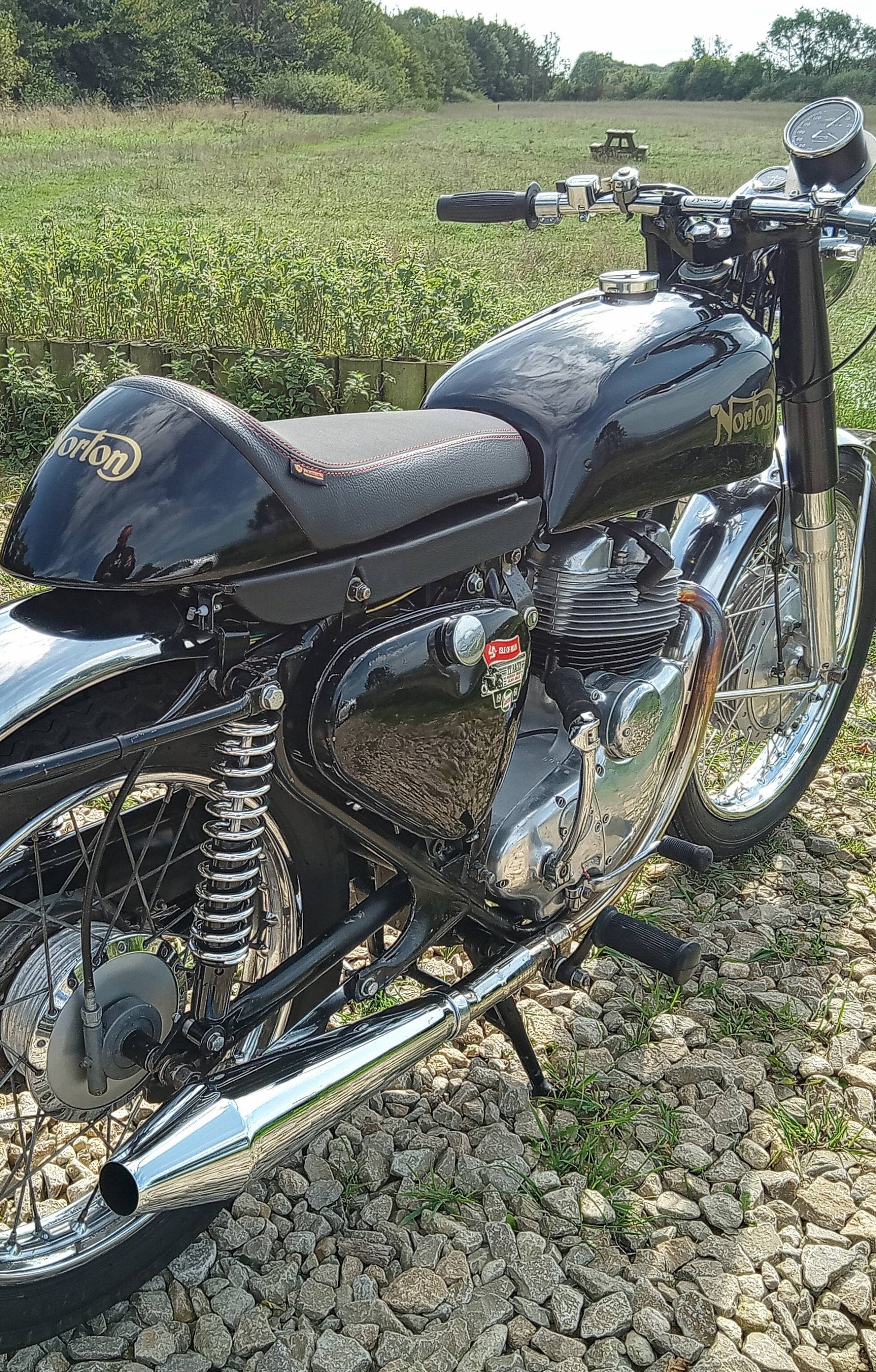

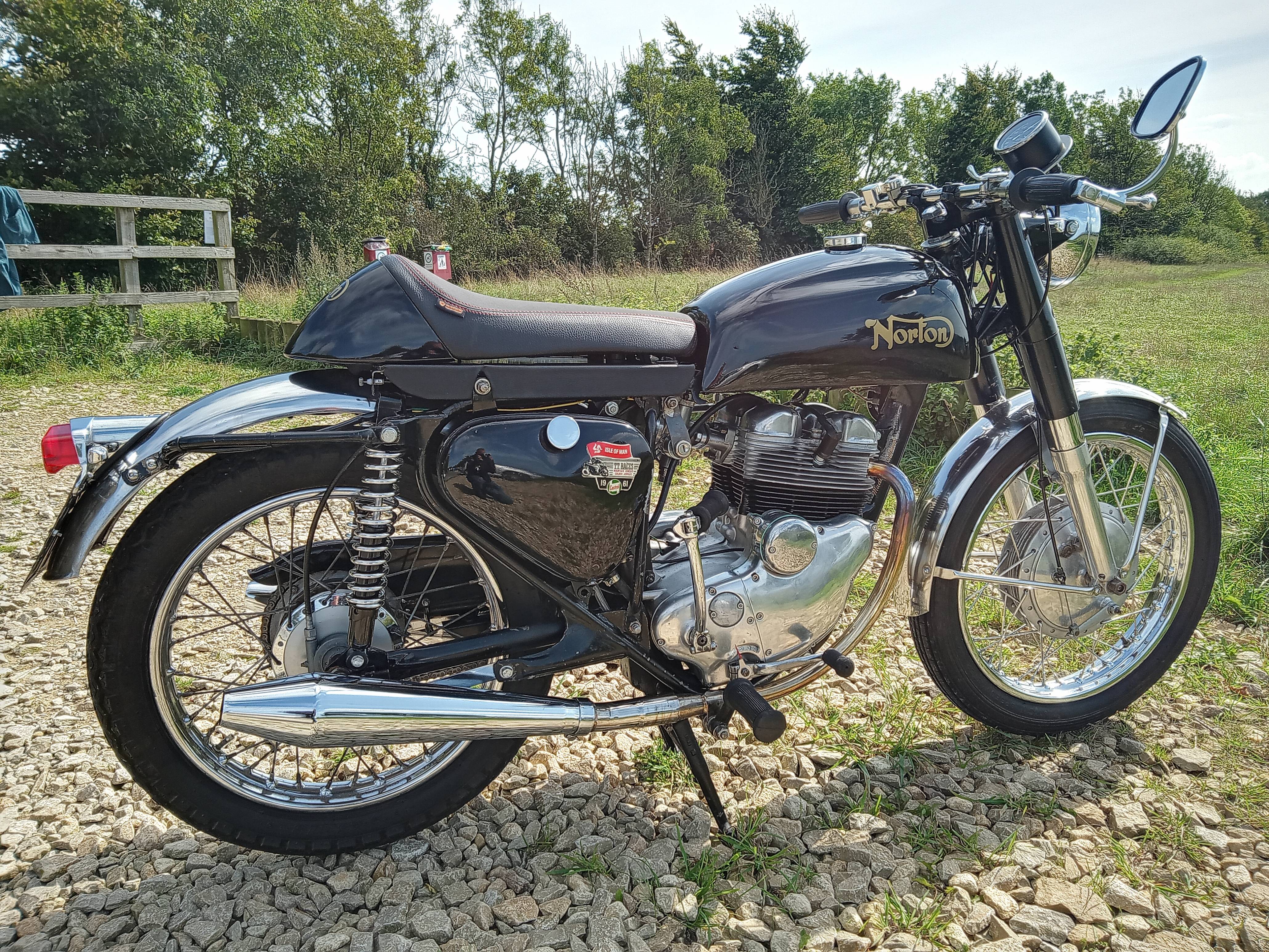

Over the last 18 months I've been working on a Navigator I bought off ebay and, without wishing to tempt fate, I think I'm almost there with the big jobs and can now consider it a rolling restoration.
It's my first venture into the weird and wonderful world of classic bike restoration and along the way I've probably made all the rooky mistakes it's possible to make, for e.g. not recognising that it had a Jubilee engine fitted!  Still, what else am I to spend my money on eh?  Food, heating?  Fortunately through the club I managed to source a 350 engine and have had it completely stripped and reconditioned.  Coupled with a conversion to 12v wiring and electronic ignition I now have a bike that can hold it's own in modern-day traffic, though I much prefer the country lanes!
Purists should look away as Ethel bears little resemblance to an 'original' bike, but she suits me just fine and having done 600 miles or so over the summer I can say she runs and handles as well as she looks.  To be honest there's not much left of the original bike, (or my bank balance come to that), and I still have a list of jobs to complete.  That's what winter is for right?
I've been a frequent user of this forum throughout the restoration and just wanted to say thank you for all the advice and assistance I've been given by other members.  Without the NOC I'd have been proper stumped!

I am drawn to your shiny rear light housing that looks to be connected to the rear mudguard.
Was this home made or a bought in item?
If bought,  from where may I ask?
The rear light housing was an ebay purchase from goodness knows where.  It came complete with a sealed LED light but it didn't work with positive earth so I binned the lens and fitted a genuine Lucas lens unit and a proper 12v positive earth LED bulb.  I also found some dinky little indicators - a modern convenience and at £5 a pair they didn't break the bank!
