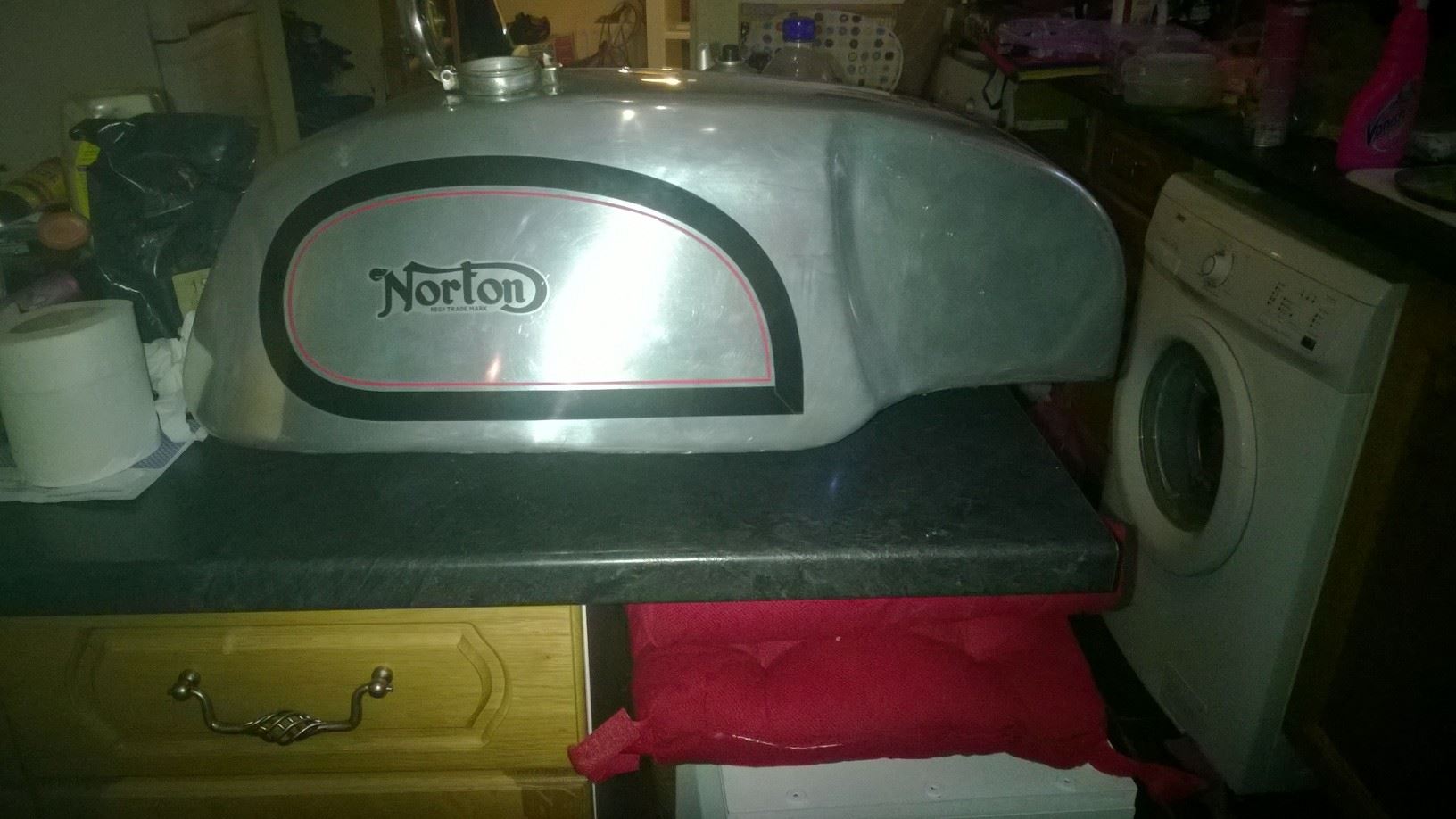

Hi,
On Sat I gave the bike a bit of a service, oil, plugs, carb clean, while doing so I noticed the fuel line was looking a bit worse for wear so replaced it. Once all backtogether I noticed a fuel leak, I tracked it down to the tank itself
Can anyone in the SW recommend anyone to repair a hairline fracture in my alloy fuel tank?Failing that, has anyone used the brazing rods you can get on ebay, HTS 2000 or Durafix I think, would they do the job?Cheers,DaveAttachments

That weld right next to your finger is a heli-arc weld (or TIG). It is the way alloy parts are put together. Note that the fracture occured at the transition from thick to thin metal. That is typical. It would look ok if the weld were extended to include the crack. Of course you have to mount the tank to avoid any vibration at the mounts to avoid this happening in the future. I prefer a good weld to a patch but it is a lot more expensive.

I had a small company reco…

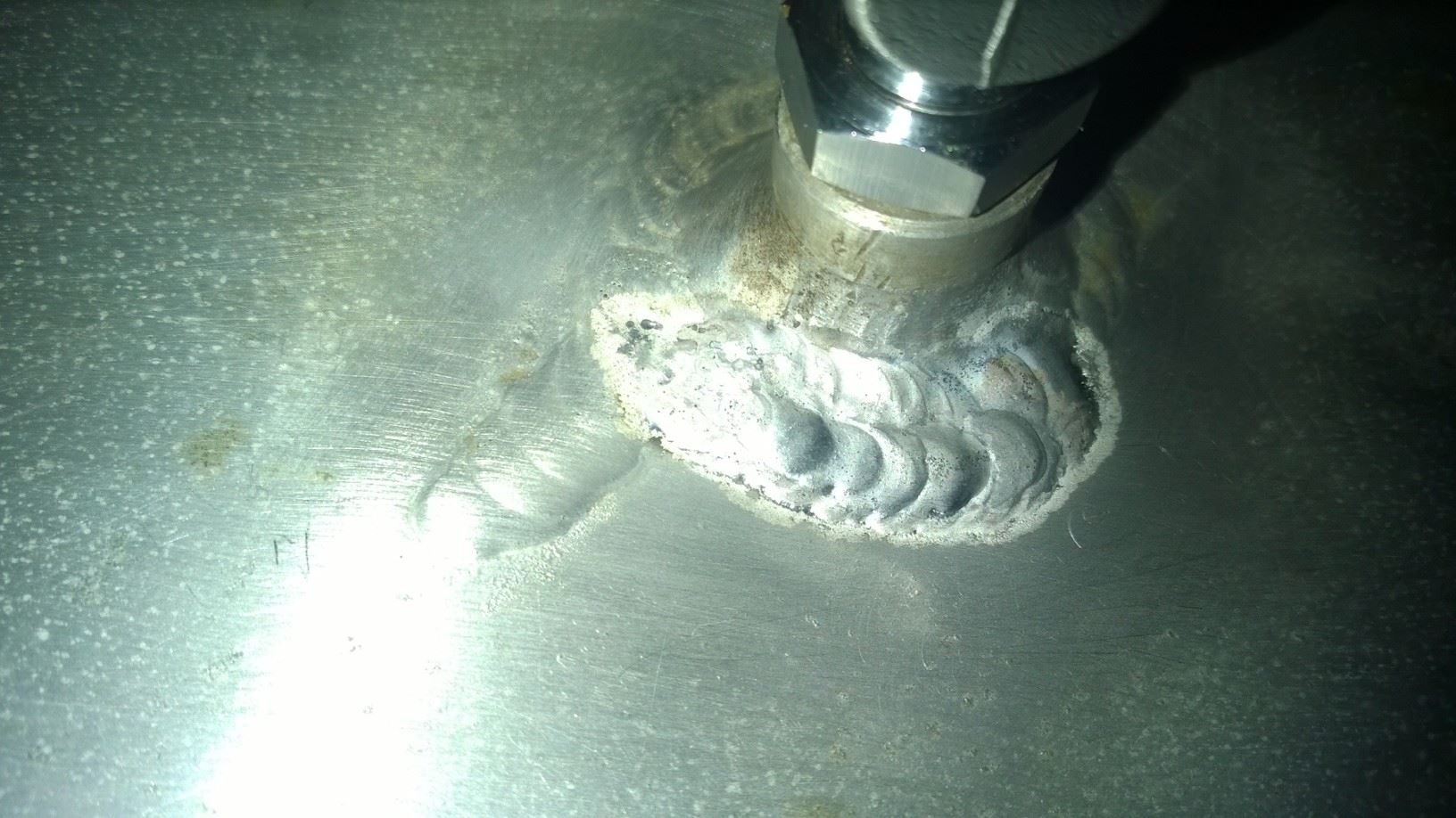

I had a small company recommended to me in Westbury in the end. Angel Engineering, did a good job and for only £30...
Only small worry I had was when I told the guy I had cleaned it but that he'd need to satisfy himself it was ok to be welded he told me..."It can only blow up once, I'll just keep my face away from it when I start"...
Not quite sure he was joking, but it wasn't my face so I wasn't thaaat bothered
