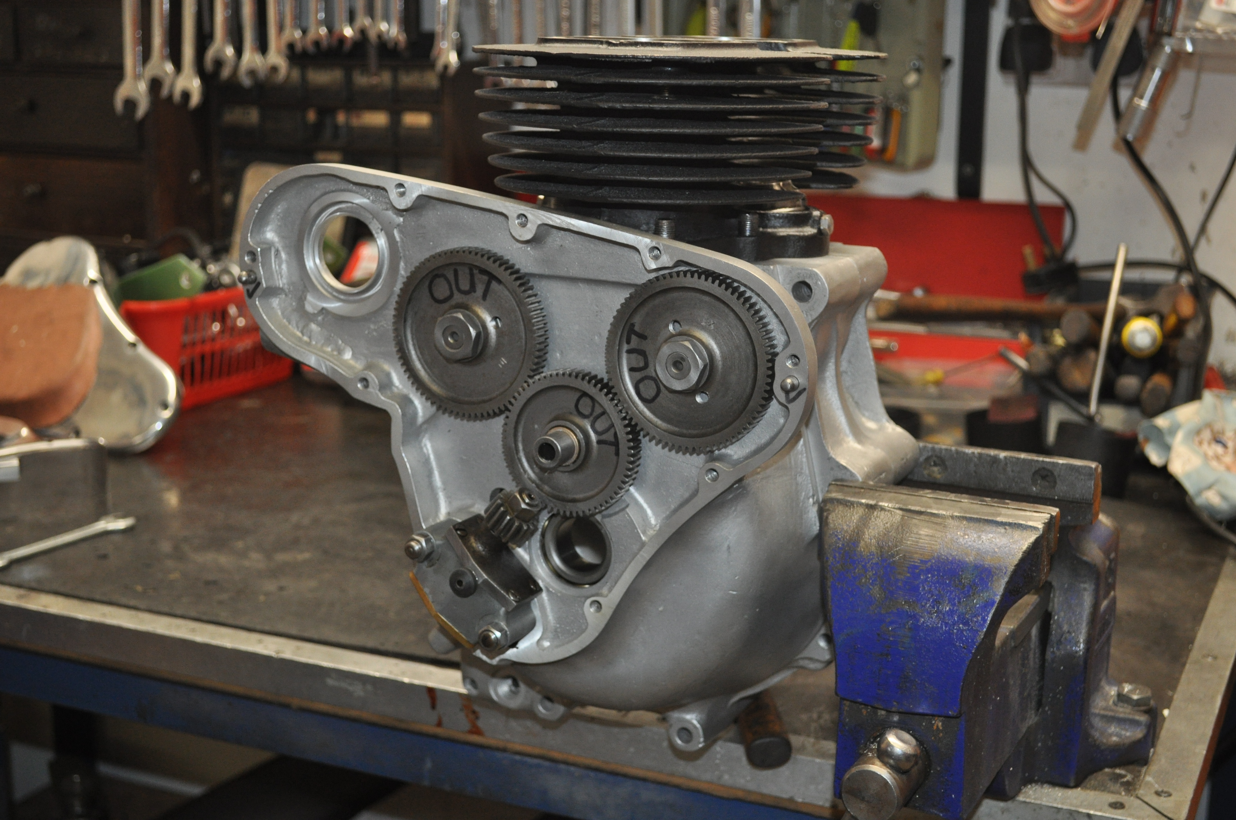

The Jubliee and Navigator both had Gears inside the Timing Cover to drive their camshafts. My 500cc Twin has as well. It has to be possible as a modification using Lightwieght Norton or Triumph gears. But not too sure if the Camshaft timing would need altering. I guess you need to weigh up the gains against the losses.
Gear driven camshaft .
Yes, the lightweight twins do have gear driven cams ,but they were designed that way as I imagine your 500 twin was Phillip . On the other hand converting a chain driven cam on the Norton twin would be quite a complicated issue , plus the additional problem of the cam revolving in the wrong direction thus needing another ider gear . An interesting engineering exercise but little more than that I feel .
