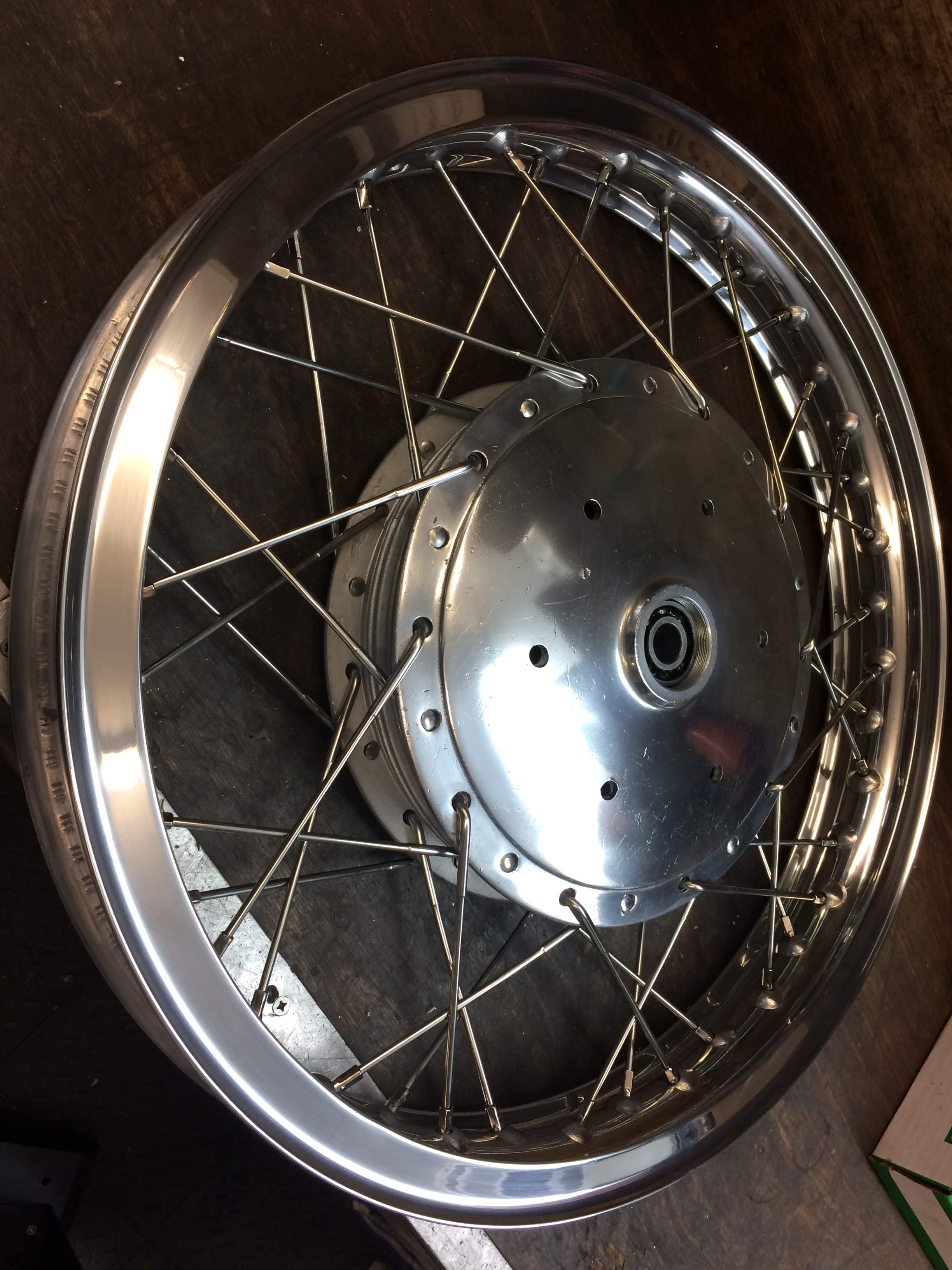

Got my wheels back, probably an expensive mistake, they look too good, everything else is going to need to be equally as shiney!

 Beautiful !  I hope you will share more pics as the build progresses.
