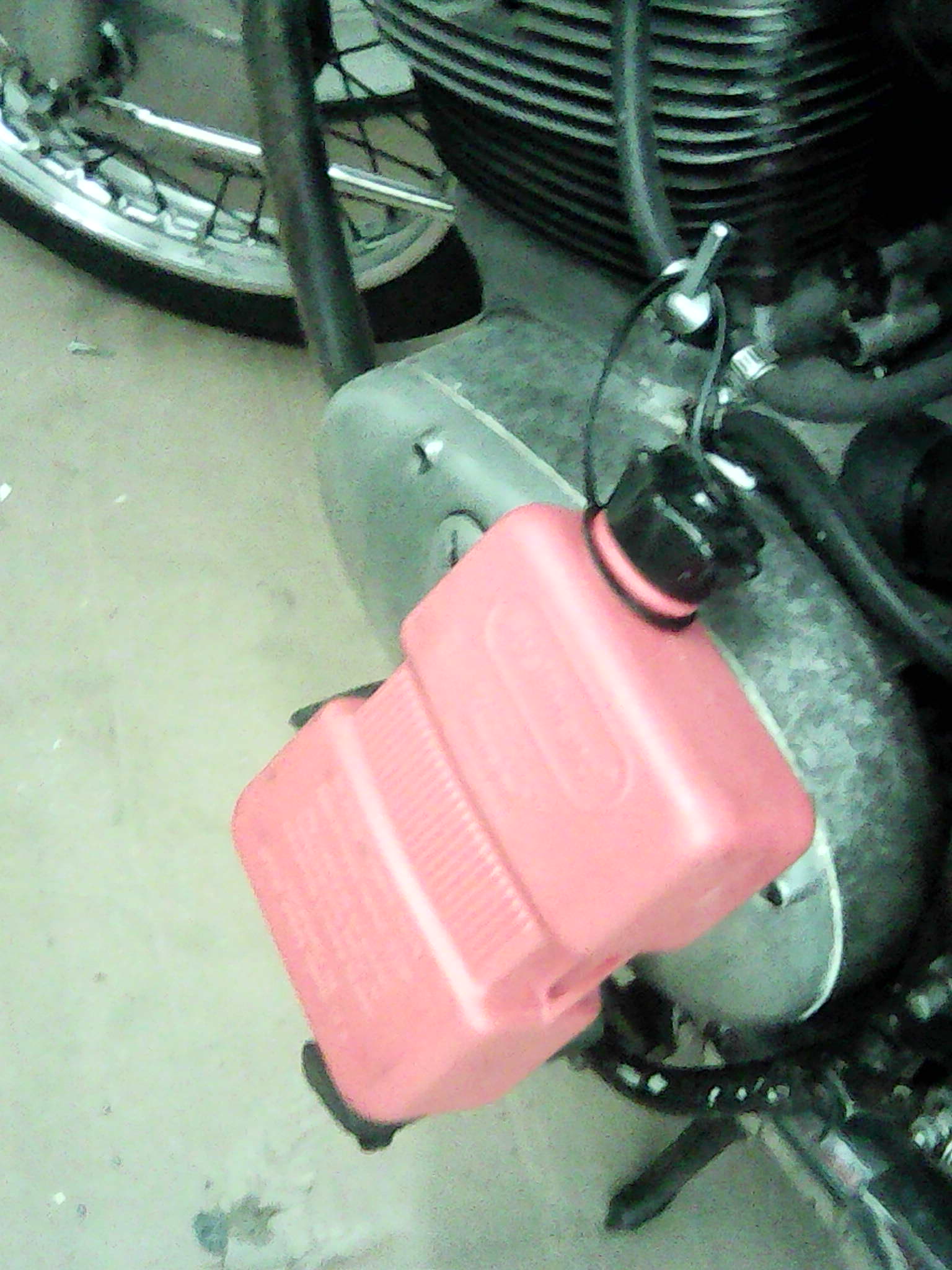

I have ran out of fuel too. I now carry a mini 1 1/2ltr fuel can in my tank top box, makes a handy tray for my cheese and pickle doorstep and and mini flask on a long run. Problem solved.

Love the pragmatic and practical solution Graham, I must admit I have considered a small portable fuel supply solution and may have to go down that route if I can't find a 7/16" thread tap with a reserve facility.

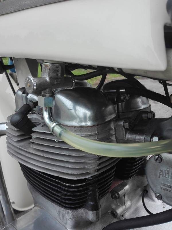

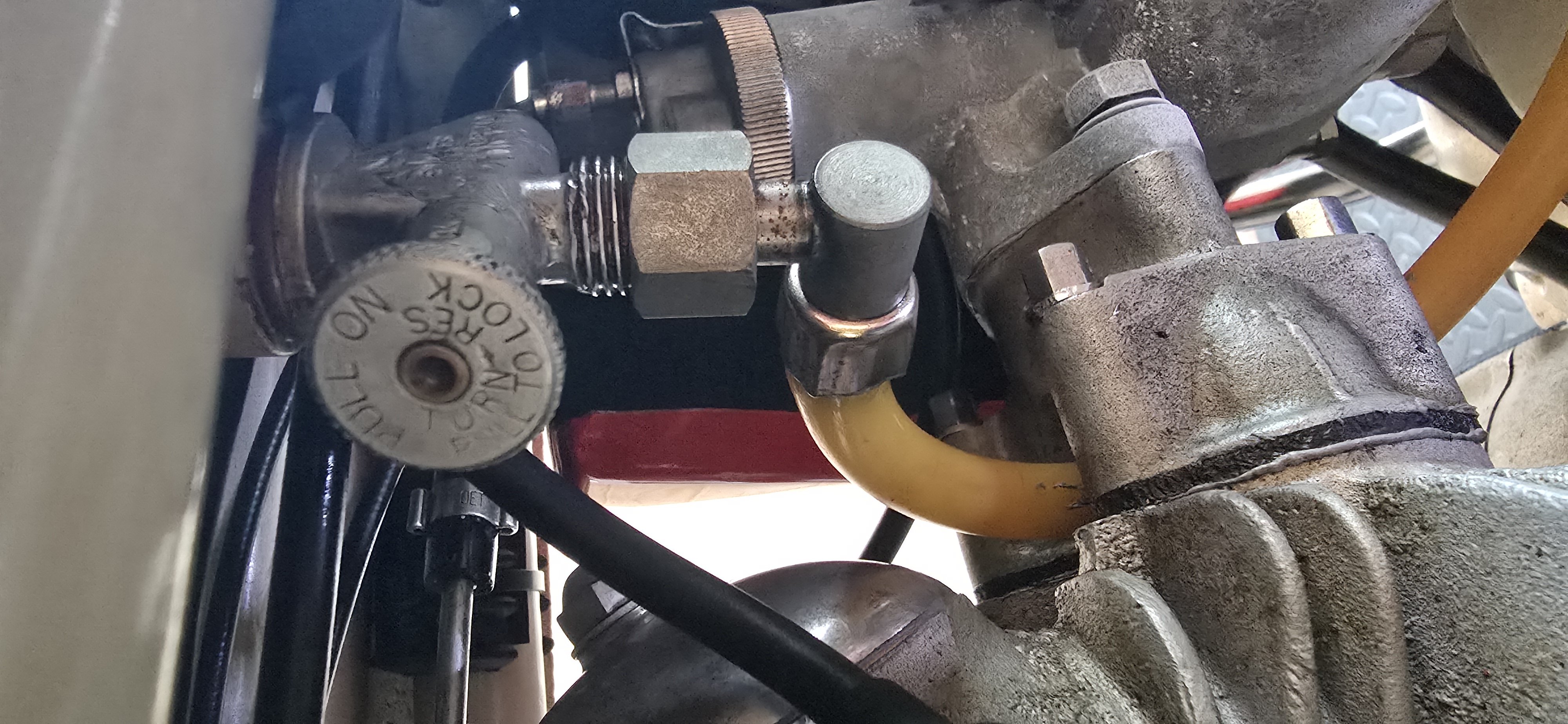

I have a double pull tap on my Navi with a 90 degree elbow. Fuel flows almost horizontally towards the carb. Haven´t used the reserve tap so far.
Looks ideal Ulrich, do you…
Looks ideal Ulrich, do you know where the tap is on sale? Have you had a chance to ride the bike since you replaced the pistons?
Nick

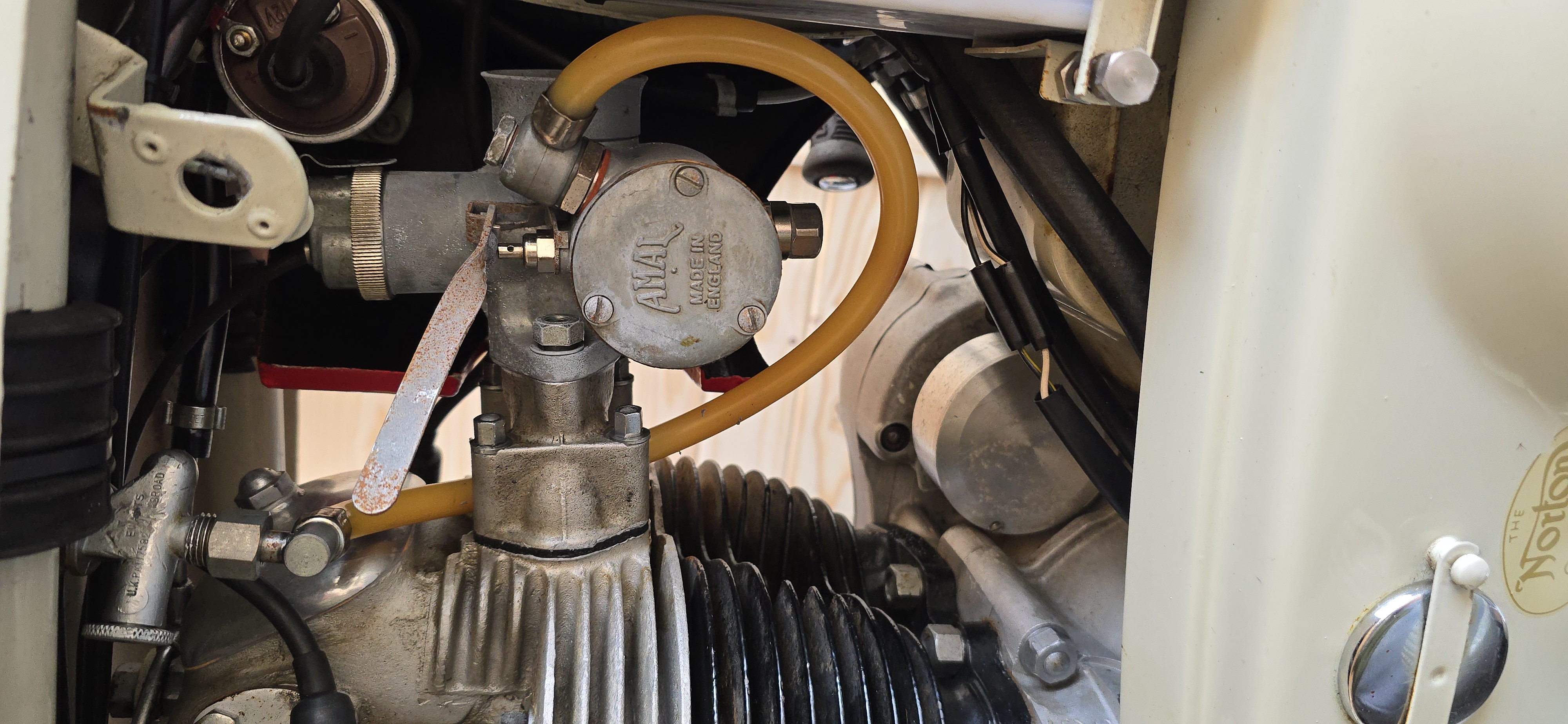

I bought the tap on Ebay.UK. Look for Ewarts taps. I also ordered new plungers and corks.
I rebuilt the engine in November and made a short ride on a warm day in December.
The bike ran fine with the correct ignition timing (check, check, double check!!)

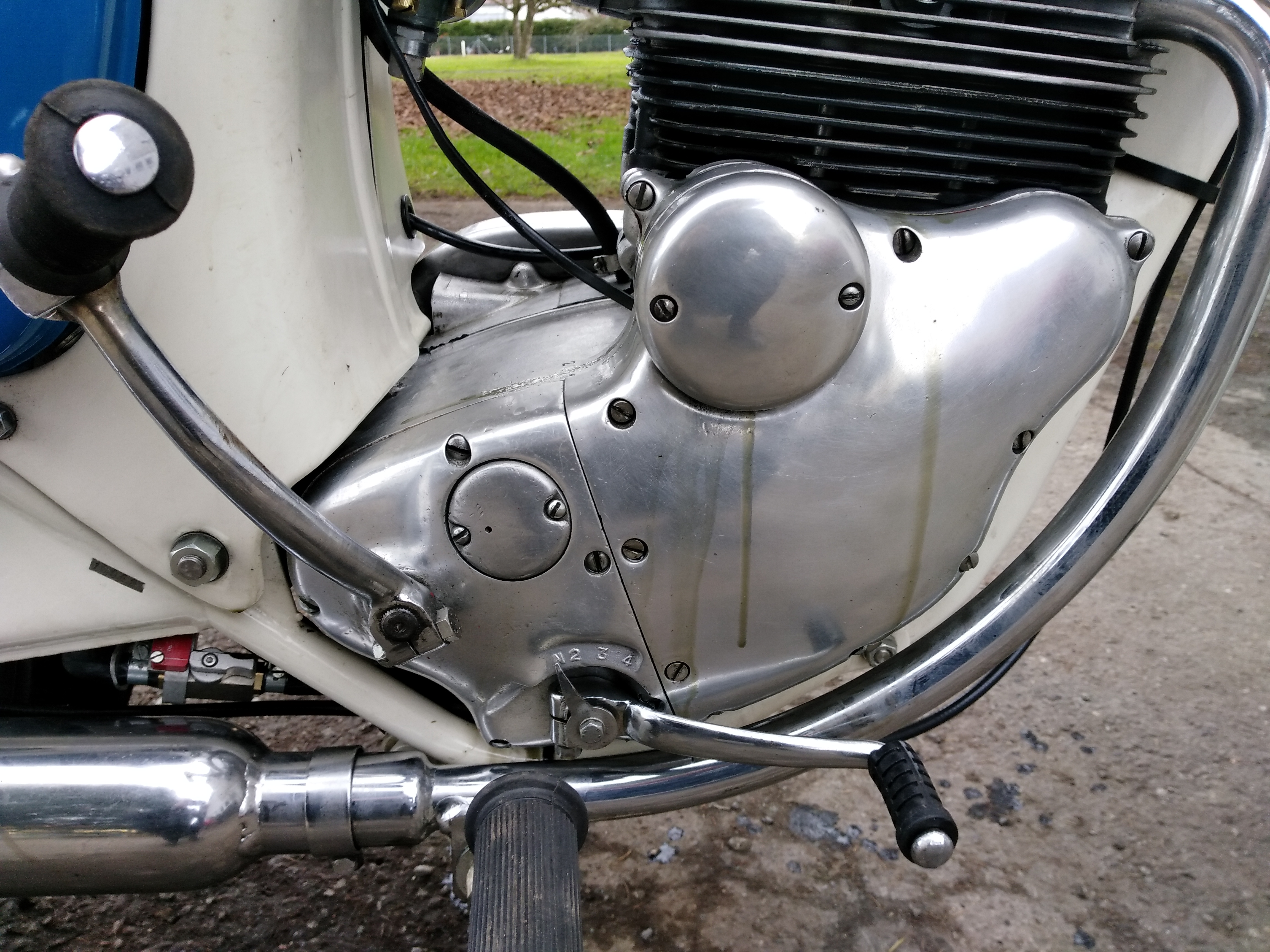

I returned to my workshop and the timing side looked like this:
Looks like oil came out of the top screws of the cover and also the ignition housing.

I've fitted the modern tap and 90 degree outlet fitting listed on the NOC Shop.
The original Ewarts pull-for-on was so stiff it seemed to flex the bottom of the tank when opening. And it leaked after a while.
The rotary on-off in modern material is much better.

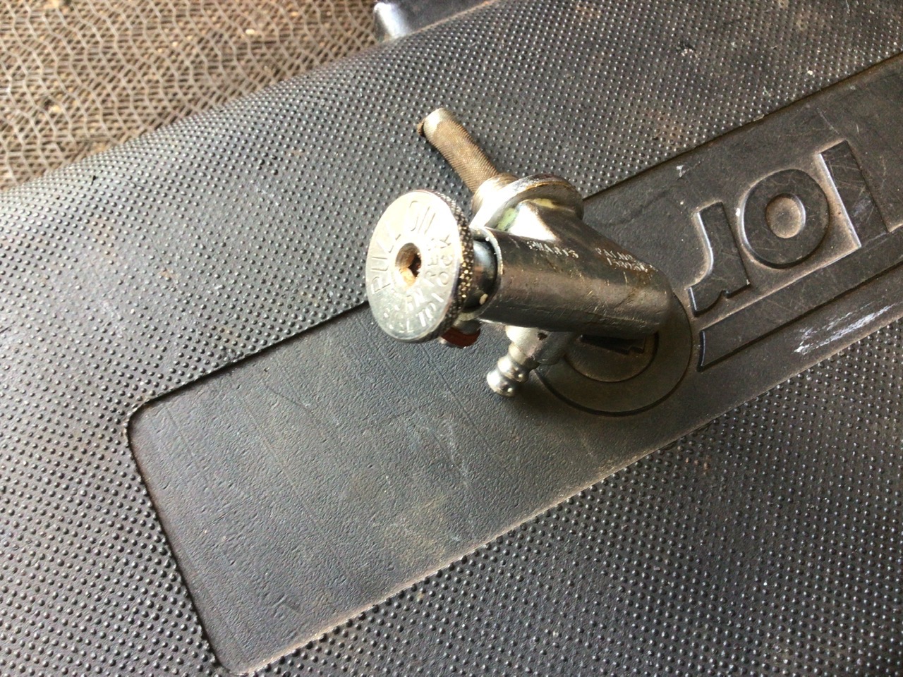

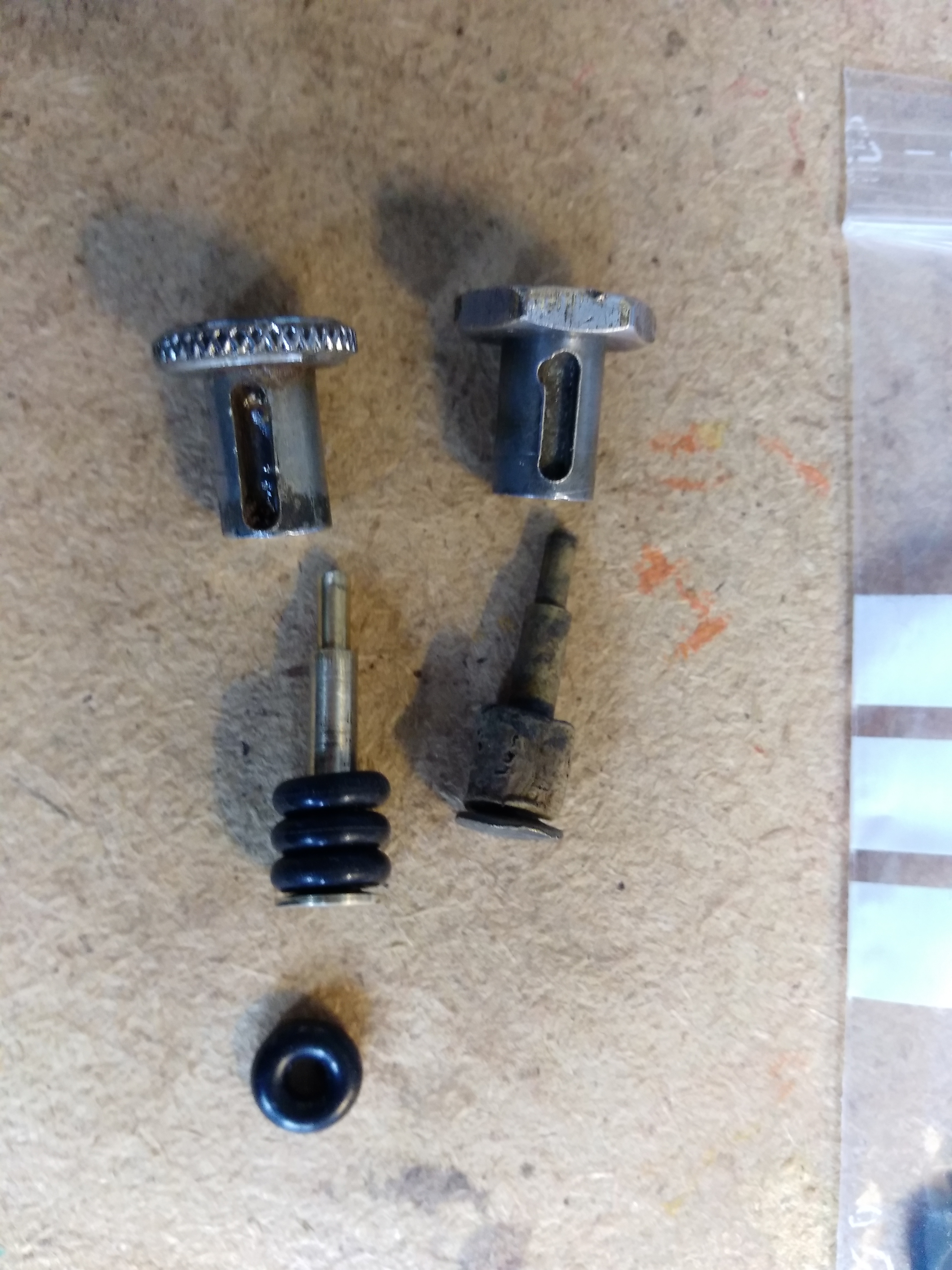

Fuel tap fix
My Ewarts fuel tap with reserve also started to leak despite of new corks.I bought 3x3mm NBR 70 O-rings and fitted them. Hope they last longer. You can put three rings on the holder. In the picture you see a spare fuel tap body without filter mesh. It is also an old dried out cork. My tap is with mesh. I had to drain the tank first.
Up to a point
Check this out, lots of posts on Access Norton site. They found that the rubber gets shaved off as it passes the inlet & outlet ports. The rubber expands, as it will, into the port on the way past and gets shaved by the lips, then eventually leaks.

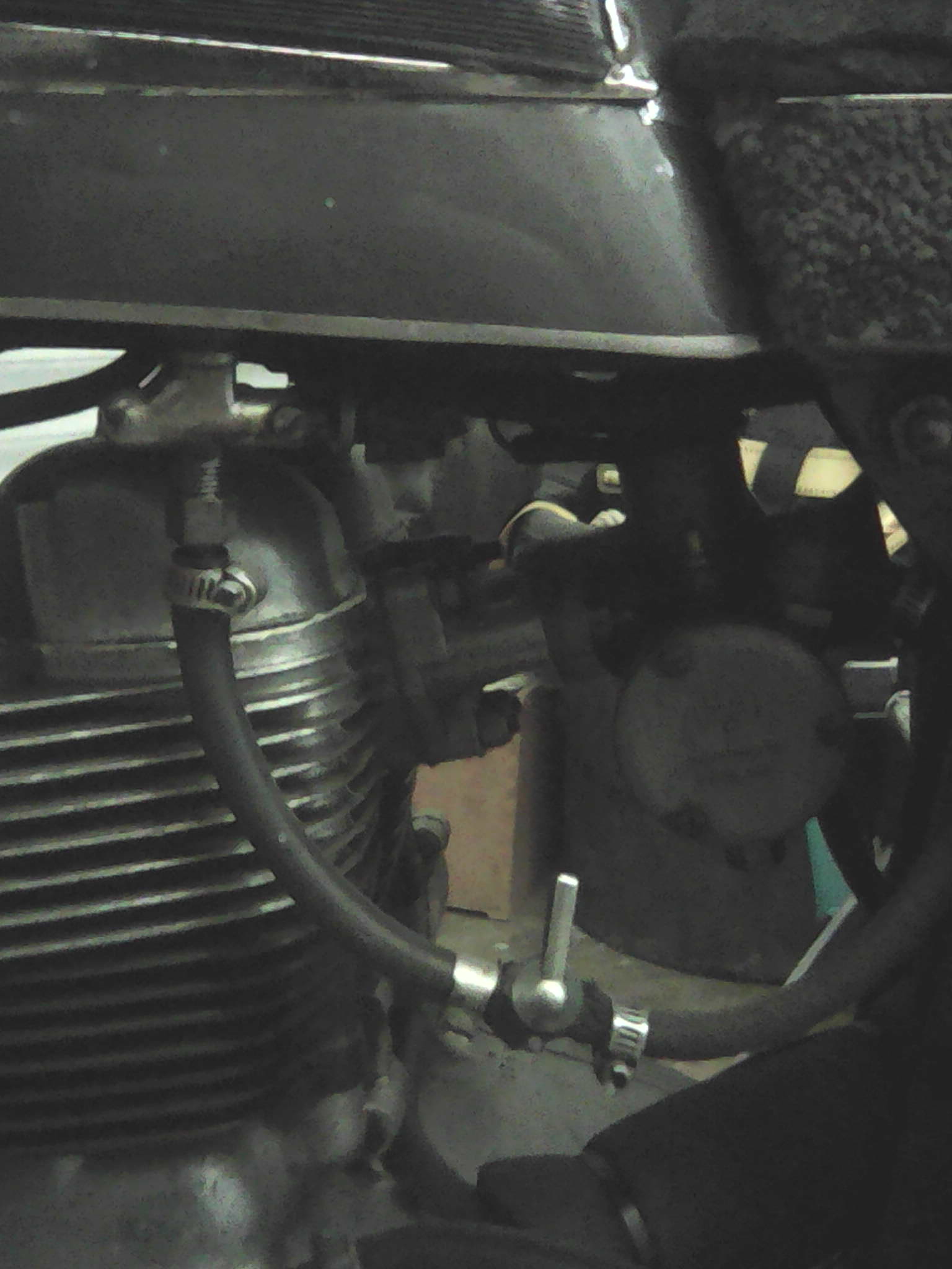

(corks always wet and sealing, No moving parts!) and fitted an in-line tap. I carry a reserve in a bottle (no moist air to stale fuel).
Very reliable.

leaking tap

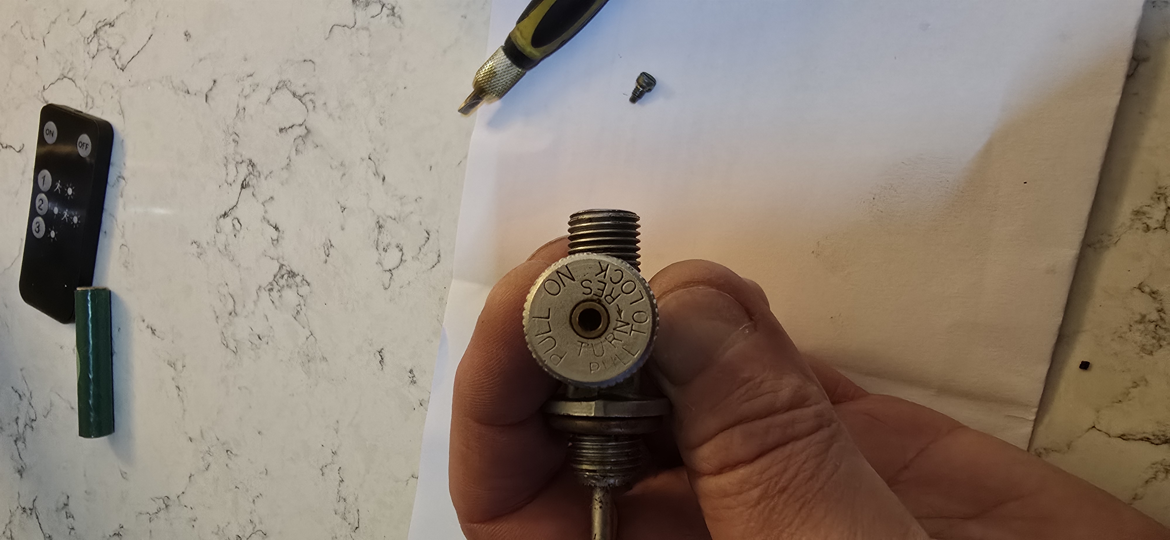

Graham, I have noticed that my tap (same type as yours) seals in the OFF position, but has a slight leak through the reserve (a drip approx every 10 seconds) when ON and the fuel level is below ON inlet into reserve level. This I believe is because the cork is not sealing the outlet port and the brass sleeve can't seal the reserve duct (if it did you wouldn't be able to pull it to ON never mind turn/pull to reserve). So while there is normal fuel levels it doesn't matter where the fuel comes from so this slight leak doesn't matter. Once you go to reserve the tap works as it should and feeds fuel from below the normal tap inlet level as it should.
So my thoughts with your added tap - if the tank tap does have just a slight leak like mine in the ON position, then if it is left at the ON position you can control normal fuel level feed with the second tap and still have reserve ready to pull ON when the level drops below normal. You would have to test it out every now and again, but then how often does anyone test to see if their reserve function does actually work - anybody know??? The float valve could hide a lot of unknown leaks.

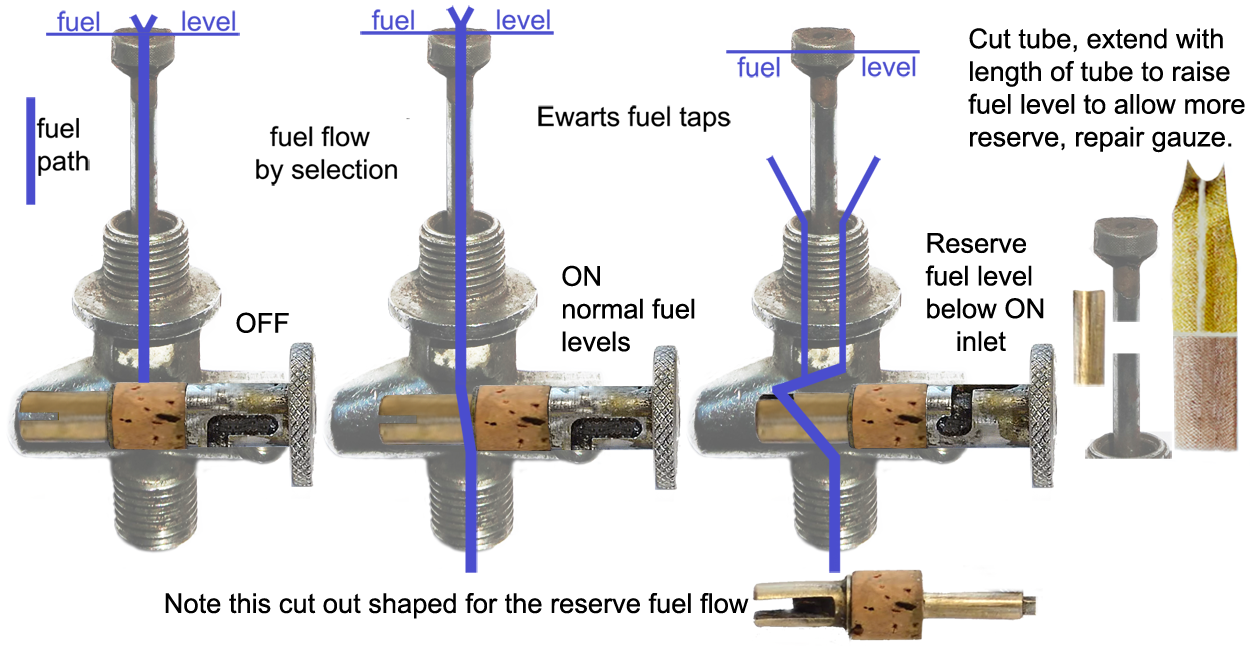

If you run the tank down as much as you dare , disconnect from the carb and drain down, then use a container to measure the quantity of fuel in reserve, would give an idea of the usefulness of the reserve function.
Reserve
Graham, I have noticed, as has Robert by his posts elsewhere, that there are a lot of undersized and/or poor quality corks available these days. The bigger ones can be carefully reduced to a good fit.
As for reserve fuel quantity, I found mine was about 6 pints (3.5 ltr) - 2" depth in tank. Drained the tank in the ON position, then measured the depth thru the cap and drained the available fuel left thru the reserve. As I said a small seep via the reserve section when the tap is at ON makes no difference as long as the level is above the On tube entry - as long as this seep won't allow the engine to run so that it will stop you on the road.
It would be possible to cut off the upper half gauze filter, cut the feed pipe and extend the height with a length of brass tube. Solder them together then roll up some gauze and replace a longer upper filter section.

Fab useful illustrations Stan ,very helpful.

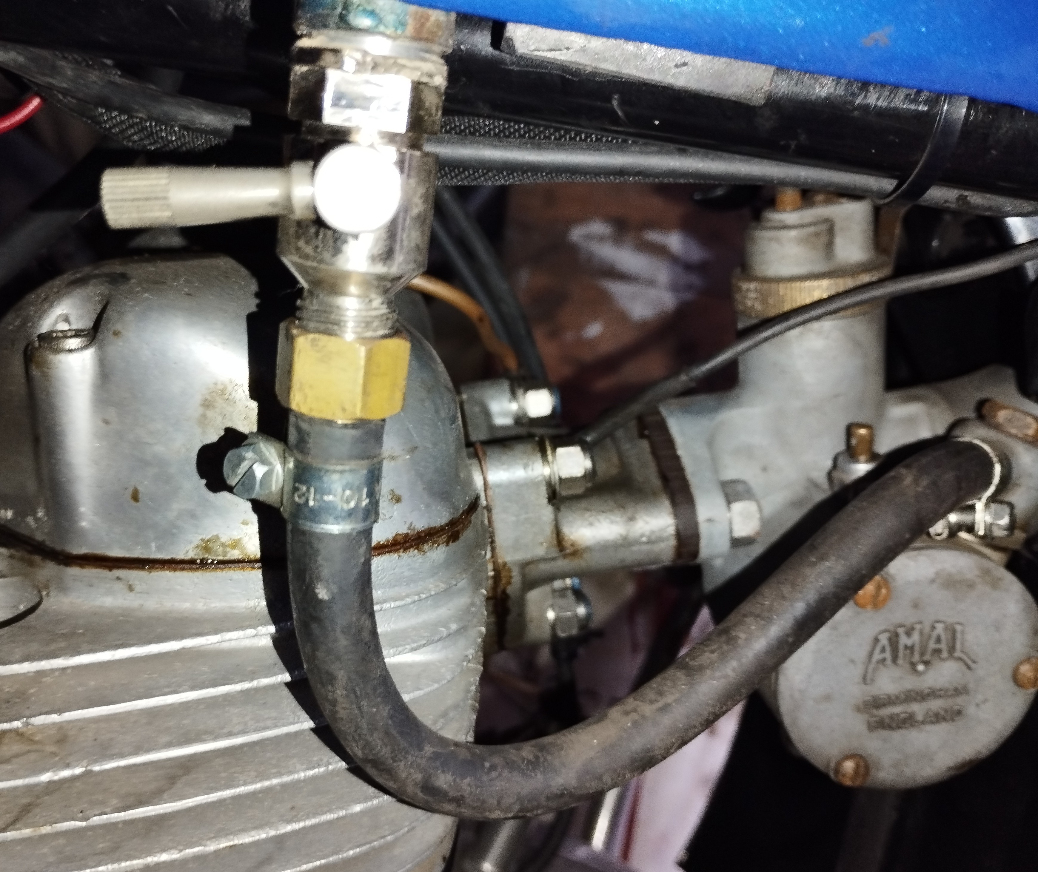

The setup that Paul has on…
The setup that Paul has on his DL Dommy is ideal as it avoids getting trapped by side panels .,possible that vapourisation may occur with the proximity of the hot manifold . Insulate ?
An old photo before I re…
An old photo before I re-routed it. I'll take another photo next time the side panel is off. I had to change the pipe as it was brittle, and the filters were in a poor state so did the lot. Seems to have cured my stalling too!!
However, the new cork gasket is dribbling so the next time I have low fuel I'll try that again!
