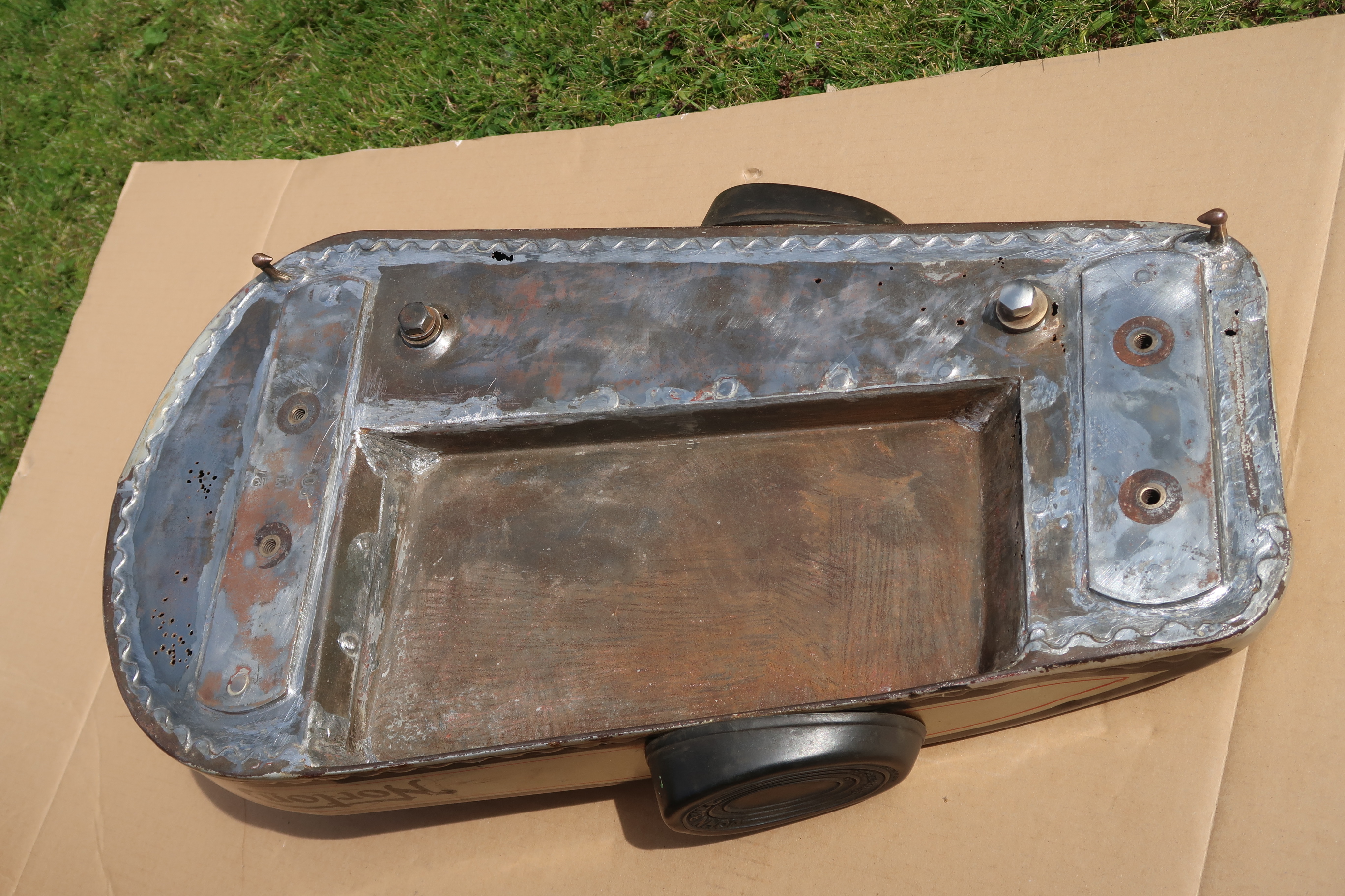

I have to undertake some repairs to the bottom of a 1927 Model 18 petrol tank.  This is to repair about 40 pinholes and some larger holes, some near the existing soldered joints.

My intention is to cut brass sheet to form patches, then tin the tank and patch, then position the patch and heat gently with a large soldering iron (I have a 175 watt iron) until a ring of bright solder is seen around the edge of the patch.
Afterwards I intend to line the tank with POR 15 system from Frosts.

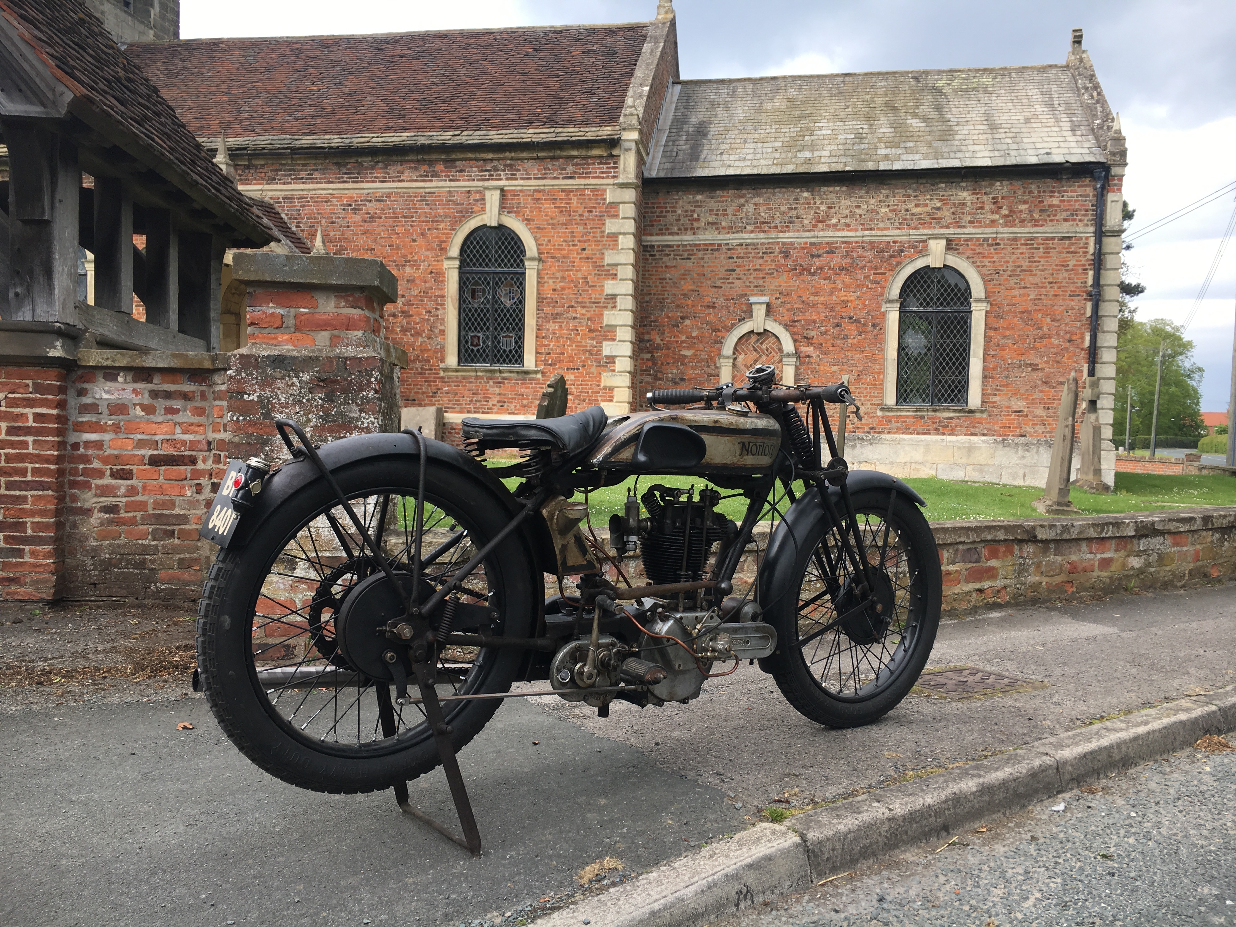

My model 18 in the picture is 1924 but with later tank and brakes fitted. It was updated I believe some time in the 30s and as it was like this when bought and I loved the look, I made it OK to use as is.

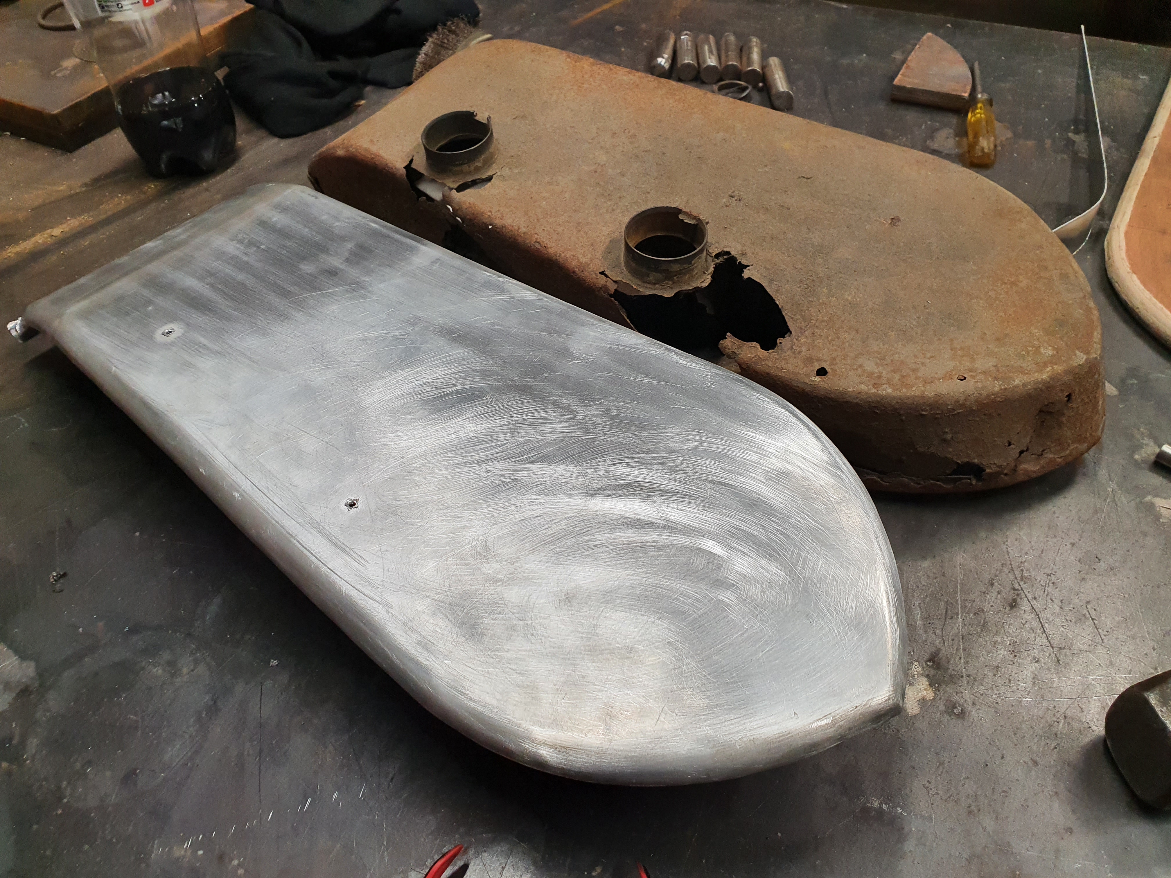

I'm making a tank for my  other 1924 model 18 which has dummy belt rear brake and Druids Big four tankbut they are a lot of work.

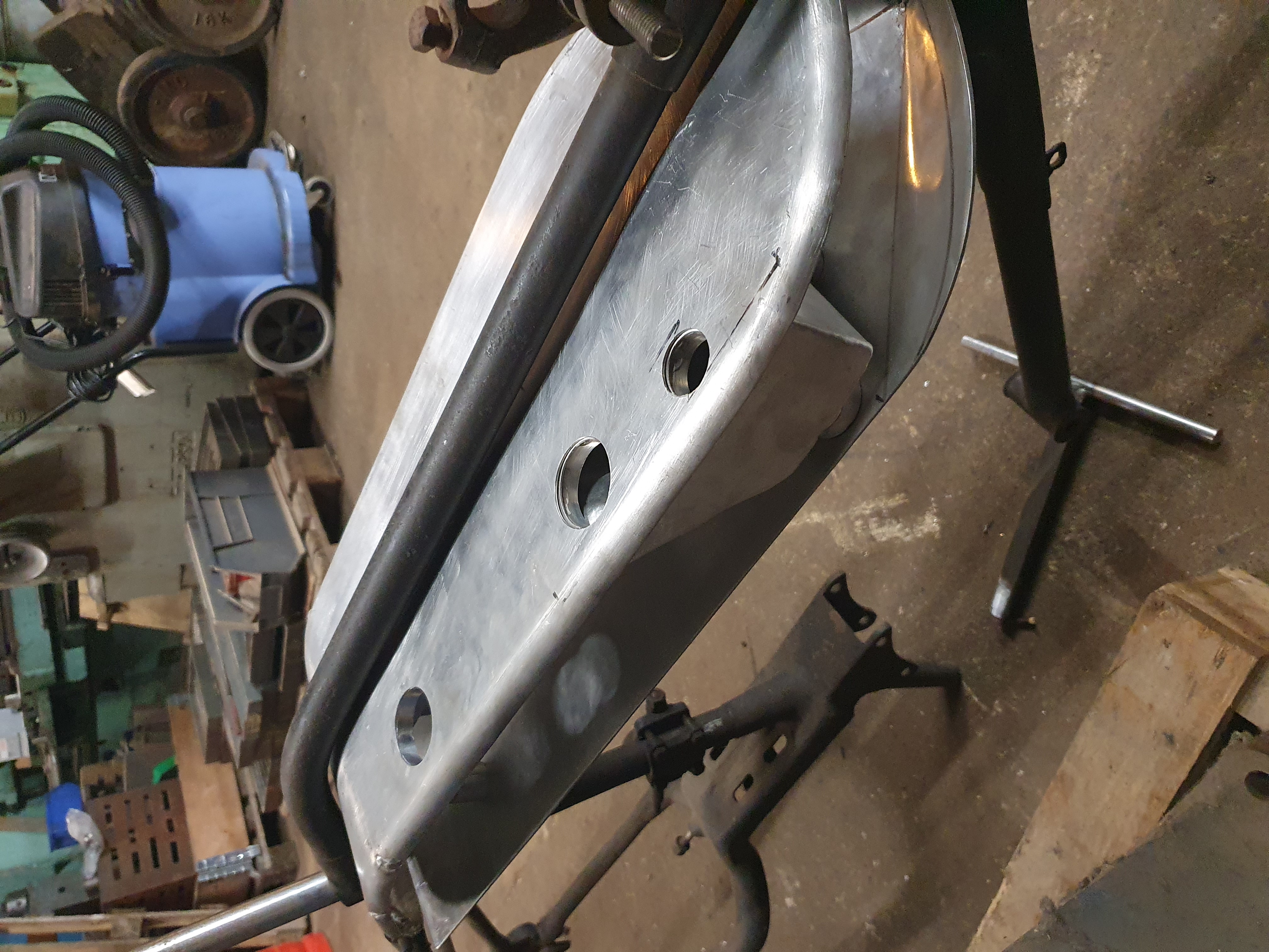

Additionally I've started to make an Aluminium tank for my 1923 Big four.
If you do get someone In  India to accurately copy your 27 tank I'd be surprised. Fully welding a flat tank in 0.9mm steel would be a waste of time as the distortion would mean loads of filler to finish.
In 2mm Aluminium you have a chance.
