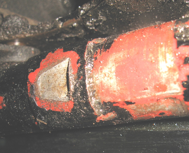

I was afraid it might be something like that. There is a bit welded to the tube. I assume that locates the stand in some way? Poked a camera up underneath and took this

That looks like wear from when a propstand was fitted.The welded bit is a pad for the center stand to abut when on the stand. These wear and need building up to stop the bike going too far over center and making it hard to get off the stand.

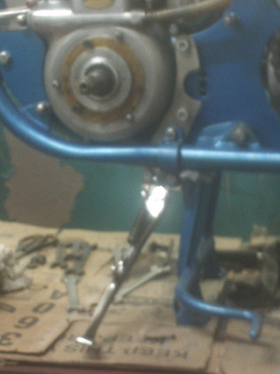

hello try fitting a Kawie ZZR 600 side stand that what fitted to my Norton Manxman and better than an original part this baby does not move around the bottom of the fame like the original one and does not foul the inner primarycase either and it comes in chrome plate all for 20 quid from eBay and a bit of my engineering intuition, yours anna j
Anna,
Is the Kawasaki stand pivoting on the original Norton pivot lug or a Kawasaki one?
Paul
hello all of the sidestand on my manxman are zzr600 kawasaki items with some of my engineering in stainless steel
I've followed Anna's advice and bought a ZZR 600 stand for the princely sum of £7.50 to fit to my plunger ES2. I have some 1/4" alloy engine plates from something else (featherbed?) which I've drilled to match the ES2 engine plate and am in the process of making 3/4" alloy spacers and longer studs to try it all out.
Maybe not as elegant as the RGM items (and I don't think they do the plunger frame model anyway) but hopefully will do the job.
