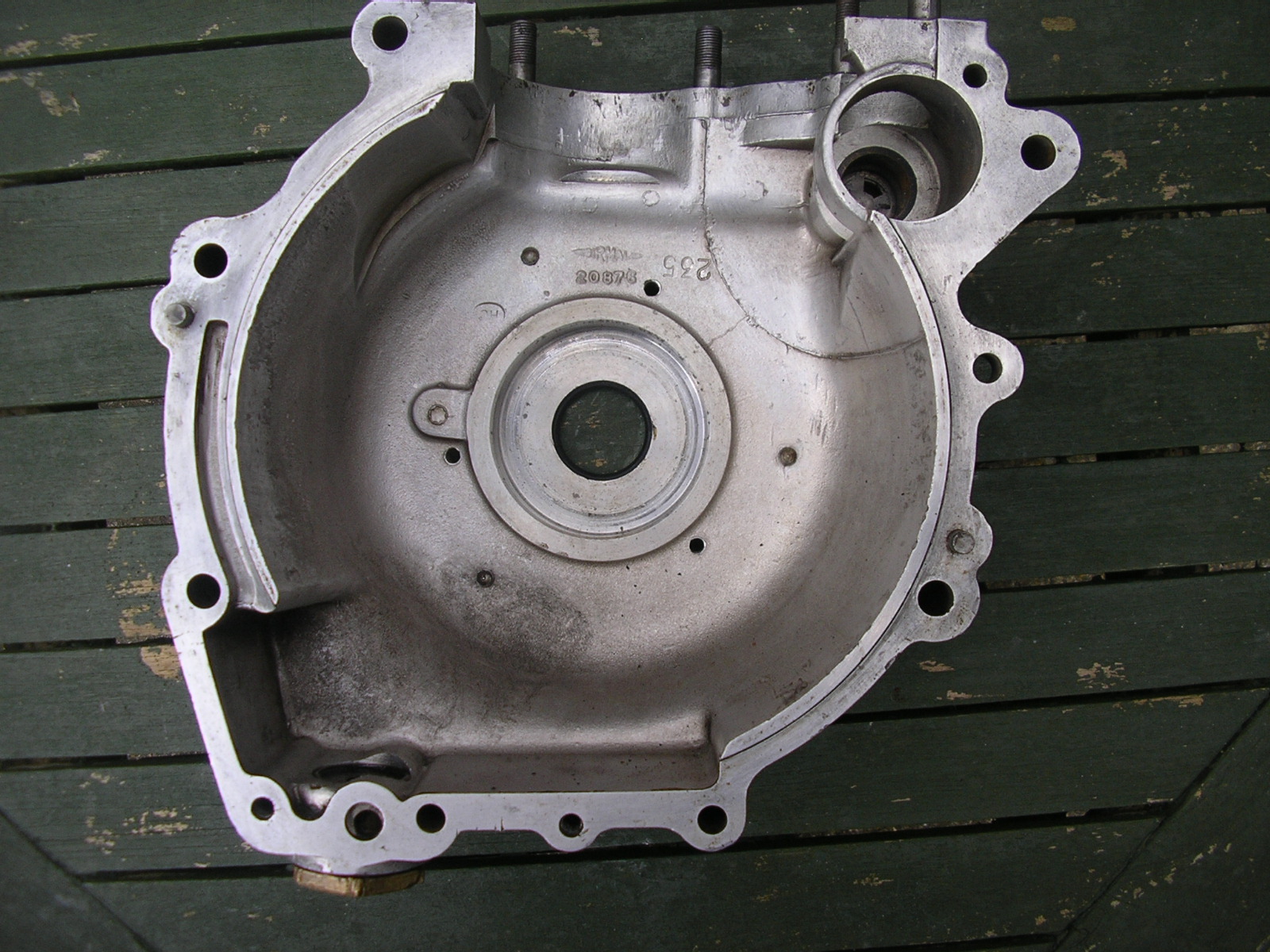

1) The 750 engines lost the breather to the rear of the cases due to the changes that were made to accommodate the larger bore and greater crankshaft throw. The attached photos help with the explanation. In the P11 engine pic you can see that the old breather tunnel in the drive-side case has been machined down to allow the  750 barrel spigots to sit deeper inside the cases. The Mercury drive-side case pic shows the step in the back to allow for the greater crank stroke. Possibly there would have been a conflict of integrity if a large breather hole had arrived in this area to cope with 745cc of waste gases.
