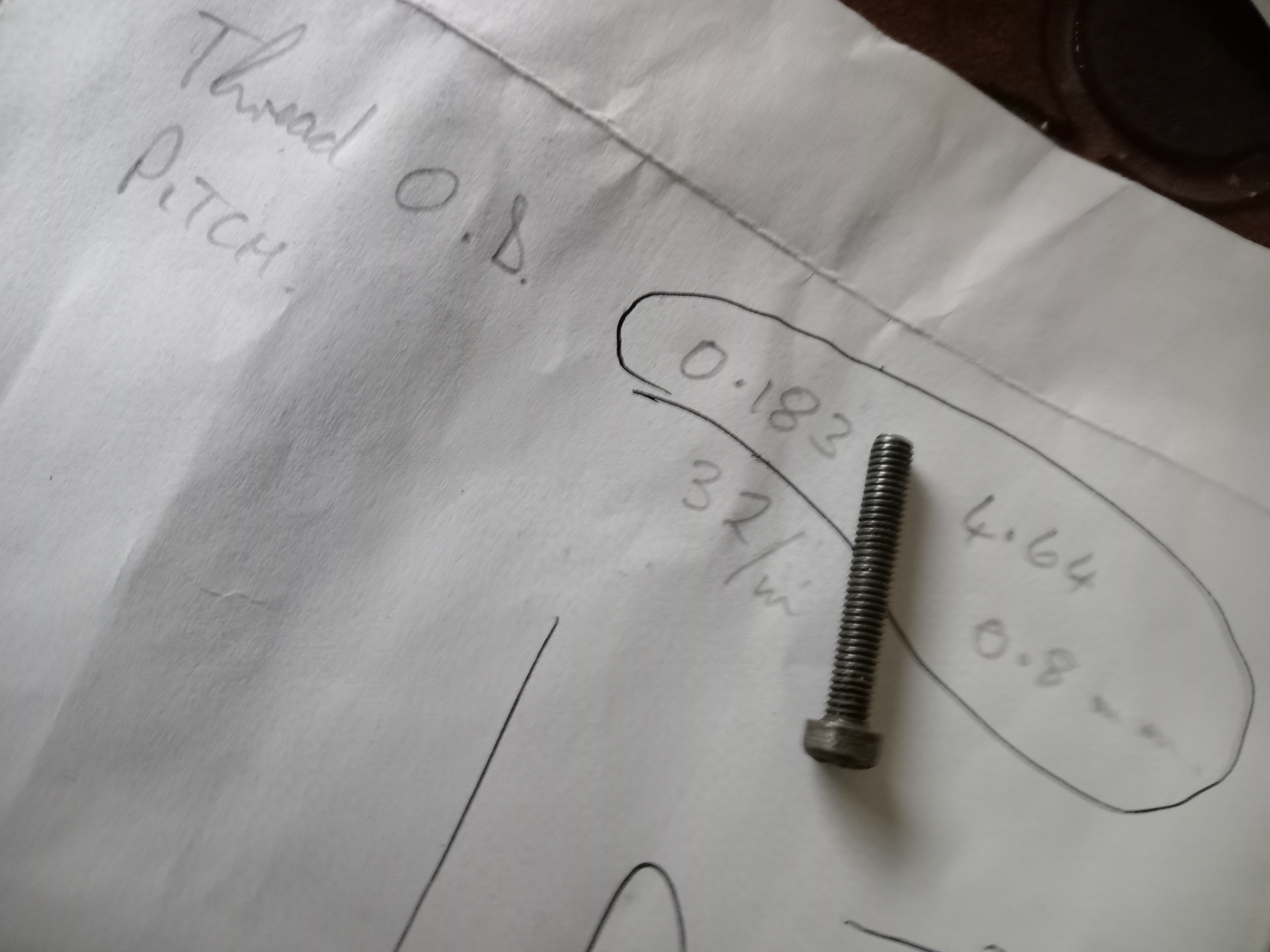

I believe this is the correct screw?
Measurements on photo but metric pitch guage 0.8mm fits perfectly.
From dia too, I go with Alan.

... Lucas invented BA (stands for British Association). They were quite clever in that there was a specific relationship between diameter and thread pitch which is why they seem a bit odd sometimes. According to my Machinery handbook the thread was initially proposed by the BA in 1884 and adopted in 1903. The same learned volume says that they're based on the Thury thread which was a watchmaker's standard and that pitch = (0.9) to the power of n where n is the designating number. One of the few metric British standards.The trouble with BA is that most sizes don't have a simple pitch eg 4BA is 0.6600mm
2BA pitch is 0.8100mm so Peter's measurement is pretty much spot on.

Gentlemen, thank you for your informed advice. Two new 2BA screws ordered.
