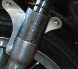

hi all,
how does one remove the fork slider, it’s broken around the pinch bolt. So far I’ve removed wheel ,,mudguard, undone the fork top nut, the yoke pinch bolt. The leg only moves 3-4 inches and stops dead! If I remove the bolt up in the bottom of the slider will the slider pull off?
It sounds as though you are. The problem is probably that the upper end of the stanchion is rusty and won't pass through the bottom yoke. A wedge in the split of the bottom yoke with the nut backed off often expands it enough to let the stanchion through. Otherwise I find the best way is to remove the top yoke and top shrouds then you can clean the stanchion off so it passes through the yoke. You can also get at it to give it a good whack with a soft hammer - you have to be cautious when hitting the partially removed top nut as it's easy to damage the thread. In any case that only gets you half an inch or so.
The bolt at the bottom which you mention holds the damper tube in place. It won't let the slider come off the stanchion as the stanchion will be retained by the top bush.
I often find that it's easier to dismantle more rather than less.......
The bolt at the bottom of the stanchion holds the damper in place and has no bearing on the dismantling of the slider to the stanchion.
To remove the stanchion from the slider make sure that the fork seal holder has been unscrewed from the slider.  (These can be tricky to unscrew if it's been in place for a few years).
Pull the slider and stanchion apart by jerking them in and out as you would use a slide hammer, this will knock out the top bush and allow the forks to come apart.
Have a look at Mick Hemmings' article on the roadholder forks strip. http://archives.jampot.dk/technical/Suspension/Norton_Roadholder_Stripdown.pdf
http://archives.jampot.dk/technical/Suspension/Norton_Roadholder_Forks_from_new.pdf
You don't mention if you has removed the oil seal holder. If not, you'll never get it apart. If it is removed, you push up the slider and then fast pull the slider down. Like using a slide hammer. May be needed to repeat a couple of times until the oil seal and upper bushing comes loose from the slider.If you google roadholder fork rebuild, you'll find more.
Seems Bob and I wrote at the same time. Luckily we seems to have the same opinion. I could add a bit on unscrewing the seal holder. As can be seen on many forks, most people have used a pipe wrench. Sometimes it can be done with a strap pipe wrench or some kind of oil filter tool with strap or chain. I prefer the Manx type which has 4 small holes drilled in the seal holder and there is a special tool for it. Done that to the road bikes too.
Thank you for the replies regarding this matter, I will endeavour to attempt the removal of the slider as described, one thing is certain it is a lot more difficult than my little Honda to disassemble!.
If you are not going to remove the bolt holding the damper at the bottom of the slider make sure the nut at the top of the stanchion is off and the damping rod unscrewed as well as the seal retainers being unscrewed.
