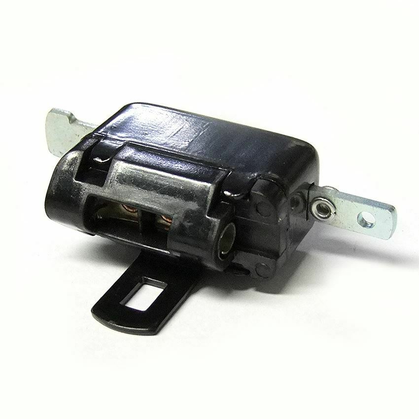

Michael is correct in his description. The plate that is screwed onto the front end of the brake rod holds the switch 'blade' in when not in use. This is the "Off" position. I enclose a photo that I have just pinched of the internet. This is looking at the bottom. The left end of the blade is pushed in against an internal spring when the brake is off. When you press the pedal down the blade moves forward and switches on. The trouble is that there are also switches which look identical but are in the normally "Off" position. You just need to check with the seller which type he has.

Many thanks for your reply, spot on thanks for the photo. All working now thanks again.

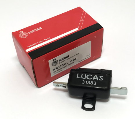

Lucas Brake Switch
This is the one that 'was' on my 1960 '99' until it fell to bits. I pinched the photo off the Lucas web site. It's the 31383 Lucas 22B Brake Light Switch (Push On) Lucas WW11031L version,
The Pull On is listed as 31437 Lucas 22B Brake Light Switch (Pull On) Lucas WW11042L

Some clarification requested
Lots of knowlegeable people on this thread.
Just for my clarification, if I look at the picture of the Lucas 31383 above, do I presume that, as shown in the picture, the switch is "closed" ie on?
If so would it be correct to say that if fitted to a Dominator with a blade on the front clevis fork on the brake rod, the 31383 shown(in the picture) should be fitted "upside down" so that the blade on the clevis fork brake rod end pushes the "hooked" end of the switch in when the brake pedal is at rest, thus "opening" the switch ie off?
Lots of recognised sellers of classic bike stuff on Ebay are quoting 31383 for all big Triumph twins which is contrary to the advice on this thread. One however quotes Norton 88s and 99s plus 3TA and 5TA so that one may be correct.
All advice gratefully received.
You are correct in the way…
You are correct in the way you describe the fitting of the photographed switch and yes the lucas "scroll" would be upside down. With the switch not fitted to the bike the contacts are in the ON position and when the fitted switch is held against the spring by the clevis tab the switch is OFF. The wire entry is always underneath . On the orriginal wiring the switch is always live the same as the hooter. The upside down scroll of the new (pattern!!) switch is confusing. Getting the correctly bent dog leg bracket helps but the adjustment positioning of the switch is fiddly.
