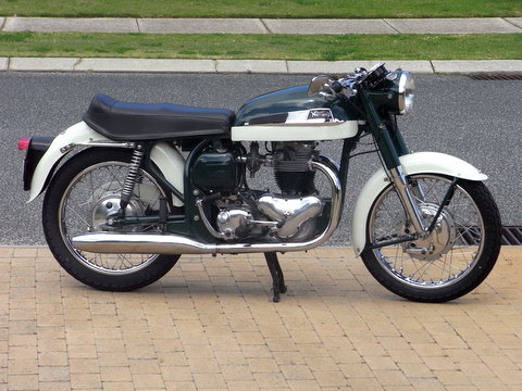

Robert, I agree about the…
Robert, I agree about the colours. If I can get the guards chromed I think I will go with the Black/ Silver, as I think it will look great. However if the guards have to be re-painted I will stick with the green/cream. Attached photo show the bike at it's best, closer examination would show the paintwork to be not so good!
