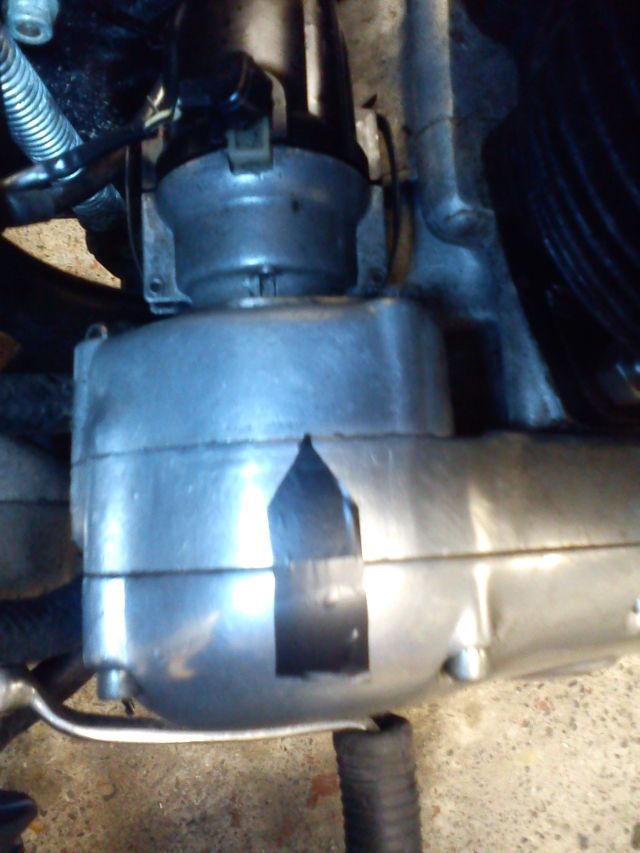

"To check the breather, fit a long plastic pipe to enable you to sit on the bike with the pipe in your mouth."
I have to say that I had no idea that there was a disc in the breathing system. I did as you suggested and it does seem to be opening and closing the breather as discribed although when closed it is possible blow a small amount through but it takes an effort. (does working on the disc require an engine strip?)
I did a second compression test when cold and the readings went to 120 on the left and 128 on the right cylinders.
"what can happen is that the crankcase pressure blows oil past the oil seal in the distributer shaft"
No oil coming into the distributer but the smoke escaping under pressure from the casings would seem to indicate that something odd is happening.
