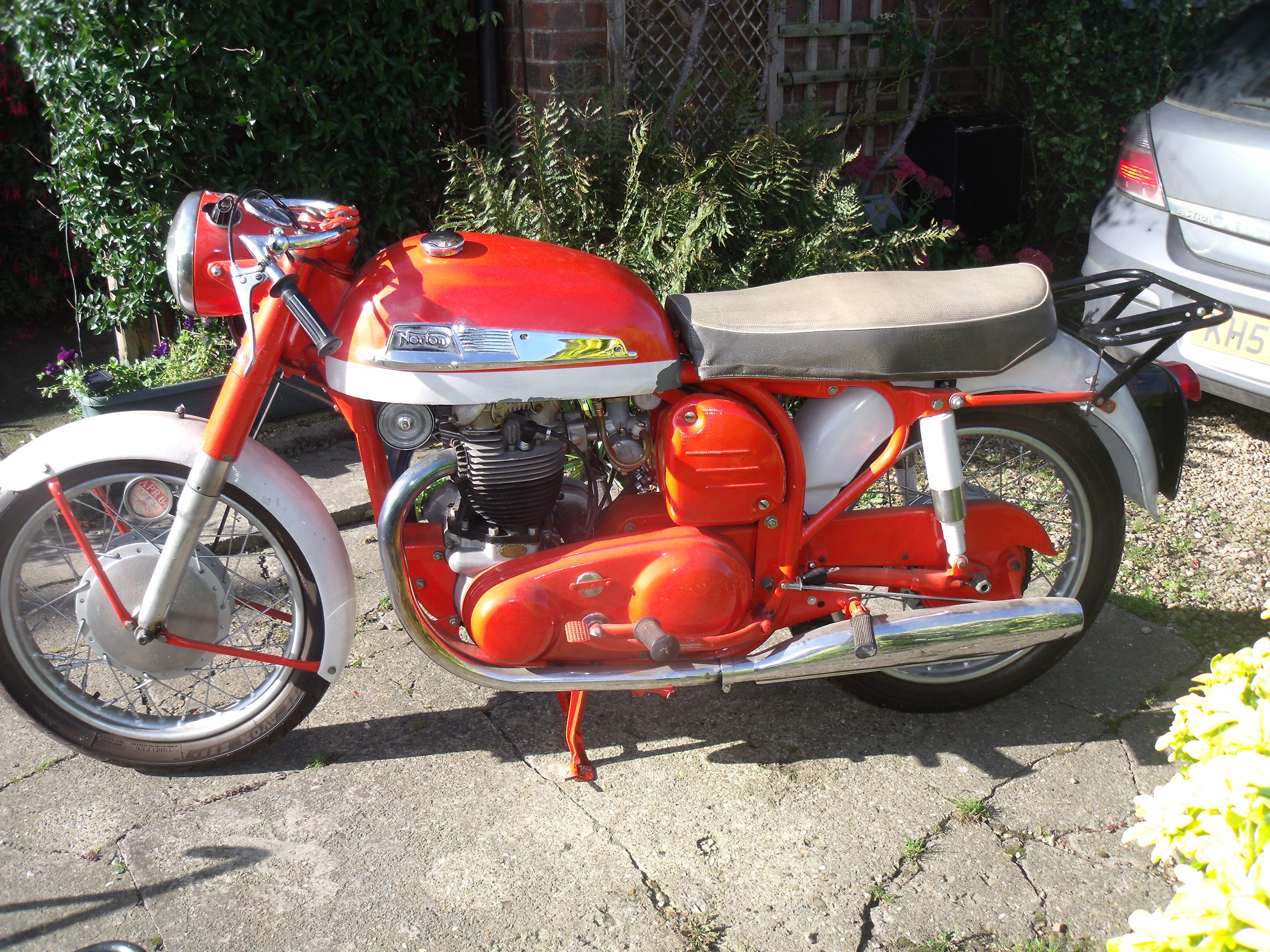

hi all,
just purchased a 99 dominator,its on 6v but the battery is missing,puz7e/11 i believe is what it had originally.I would like to keep it on 6v using a lead acid battery,unsure of numbers that would be suitable,what are you running?Many thanks

This machine looks original with the 18D2 and would have been 6V with the PRS8. These machines were never 12V from the factory. But they will readily convert. Do think about the conversion before buying a 6V battery. Don't worry too much about the numbers the battery box will take quite a large battery, just get in the largest you can. Do NOT use Alarm or cyclons while running on 6V alternator switched (PRS8), for final road use BUT you could use anything to get it going, perhaps even a run round the block.

But OHH! those handle bars! If you are over 60yrs old and live in a town-they will kill your back!!!
A pair of straight bars before you go any distance. This is NOT a cafe racer!
handlebars!
Thankyou all so much for your comments,and yes alan totally agree on the handlebars!the bike is as i found it someone spent someone money on it but so im told sadly passed away,the bike was in local auction and i couldnt let it pass!.So any lead acid battery numbers please?.

Jus a warning Martin - that horn looks like a more modern type. It could be a 12V. Have a look at a bulb in headlamp or tail light to check. Within a few years of your Model Norton did convert to 12 V so the parts are compatible. Best to check. Good luck, Howard
