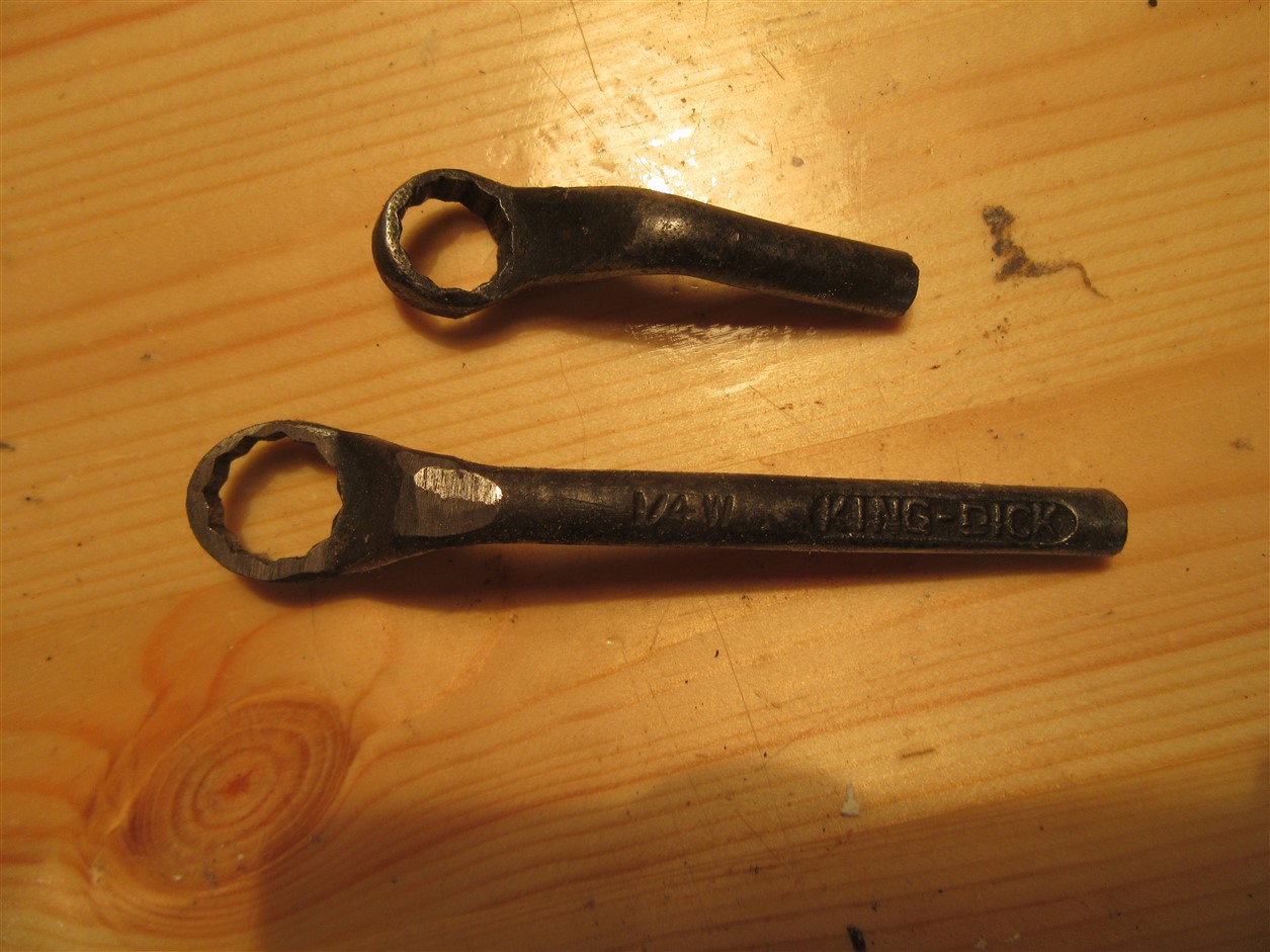

... a thin walled cranked Gordon (I think) ring spanner in 2 so that I had 2 short ones - the 5/16" end was ideal for this job and still comes in useful when I need to get at an inaccessible nut / bolt. If I get around to it I'll post a pic....

King Dick spanners are very thin and do not need grinding to fit betwen the fines. Bedford or Gordon ring spanners have quite thin but very strong shoulders.

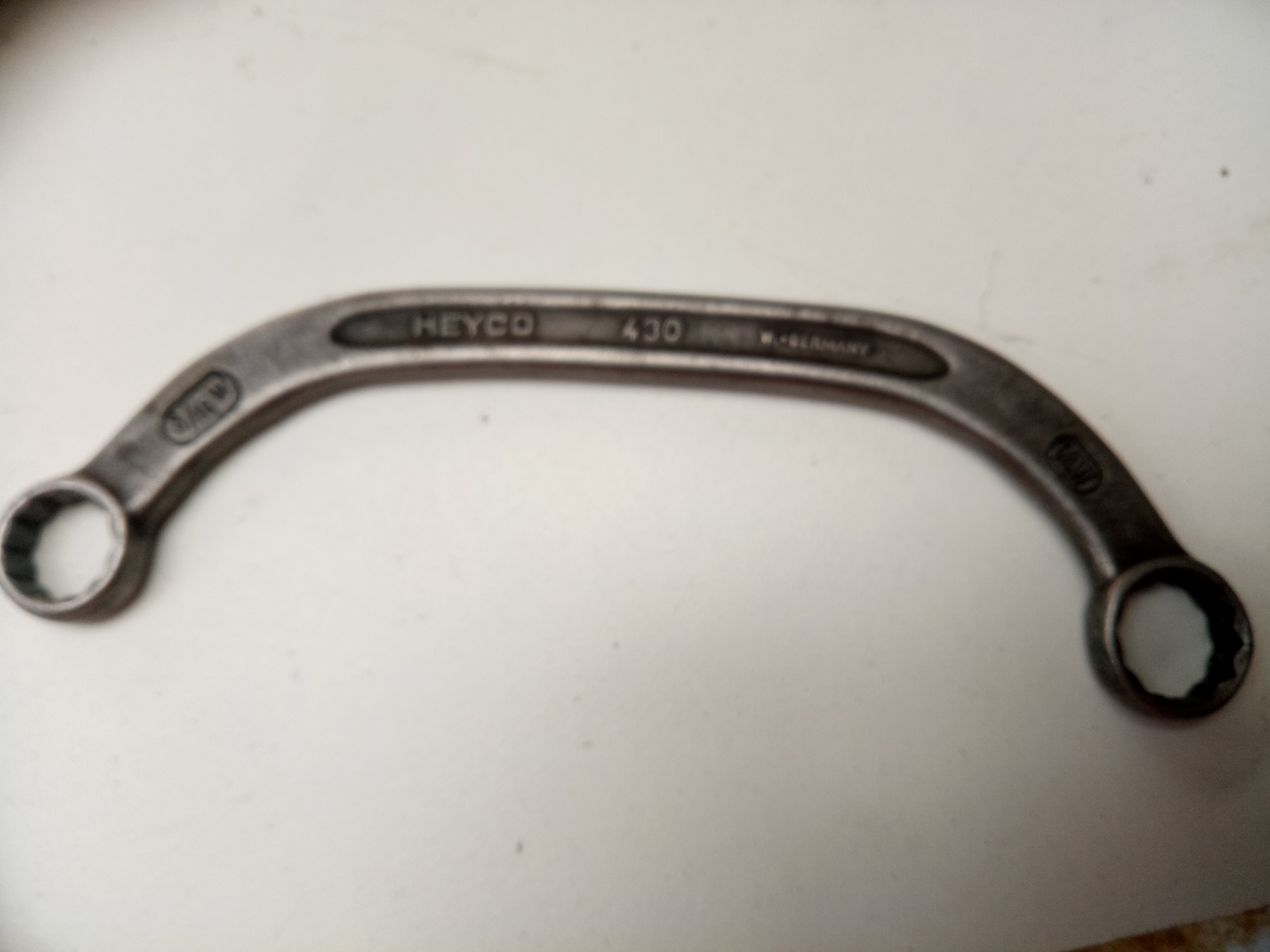

I have attached a photo of the spanner I use when fitting Dominator heads. It's a Heyco no 430 from Germany. It gives good clearance on the nut at the rear and good rotation so the nut tightens quickly. It's in Whitworth format so fits properly.
A bit  of luck finding that spanner!  Not surprisingly Heyco no longer list them in t heir catalogue.  In the old days we called these "Starter spanners! as they were useful for getting at car starter motor bolts.  The spanner was designed ti fit round the starter motor to access the bottom bolt usually.  Heyco call them "Starter and Manifold Wrenches".
